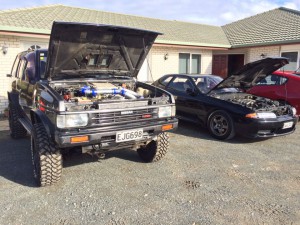

Well the project is now nearing an end...
It went to get cert last week and all is good only thing needed is a 50mm x 5mm minimum flat bar drive shaft loop (apparently all drive shafts need this when engine conversion with 4x m10bolts) so that is easy job to bend up and bolts onto one of the chassis cross rails nicely.
The o2 sensor used to test gases from cert guy showed the truck was at 11.8% o2 at idle when it should of been around 14% so it is running as rich as shit and costed $30 to do 60 km
..i thought my bros 265 Hemi pacer with triple webbers was hungry. Anyway quick email to megatuner and plugged laptop in and brought fuel back 6% so should be allot better.
Engine running good considering small tuning issues and small 12 inch slim line fan seems to keep temp under control at lights, although heater may be needed when playing in the sand.
The exhaust system is great, it is not to loud when cruising along and doesn't give that deafening drone when low revs under load, yet still holds very good undeniable RB note when revving. due to 3inch system running right through it has to be quite close to passenger floor to clear front drive shaft so passenger does get free feet warmer which will be great in winter but not so fun in summer
Truck be fully road worthy end of next week so 4x4 videos will follow

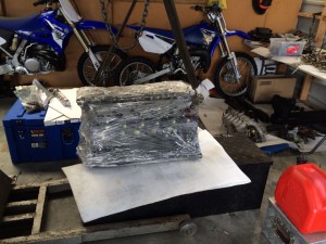

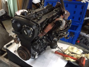

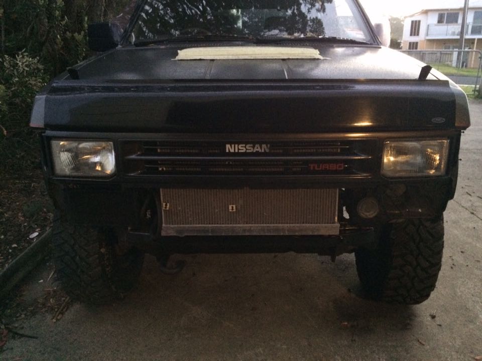

Hey guys, to start with hope everyone has been keeping well, sorry to relive a old post but thought id give an overdue update on this project. As most of you know i left for Australia not long after this build so the truck sat in the shed waiting for my return.
Fast forward a couple of years and i'm home and have decided to give the engine a freshen up as it never ran 100% (suspected coil pack failure because of the top mount intercooler allowing water into coils) and go through the entire build and give it a general tidy up. So far the engine has been stripped down and rebuilt with the crank collar modification, heads had machining and the block has been honed with new rings and ACL bearings. I rewired the entire engine with the standard ECU and ditch the megasquirt to a much higher standard and are just about ready to reassemble and get her up and running over Christmas.
My overall thoughts on the build are still positive, she had plenty of power even with the teething engine problems and over fueling. The top mount wasn't the best of idea so have gone standard size and mounted it up front on the passenger side and will block the bonnet scoop. The TD27 torque converter is on the heavy side and would be a lot better to re-spline the rb25det torque converter and use that instead (will do later down the track). The transmission is still a concern but i cant really comment until i get some more KMs on it but i have a Rb20det auto which i will bolt the transfer onto if it lets go.
The long overdue video of this in action will be up as soon as its on the road again.
