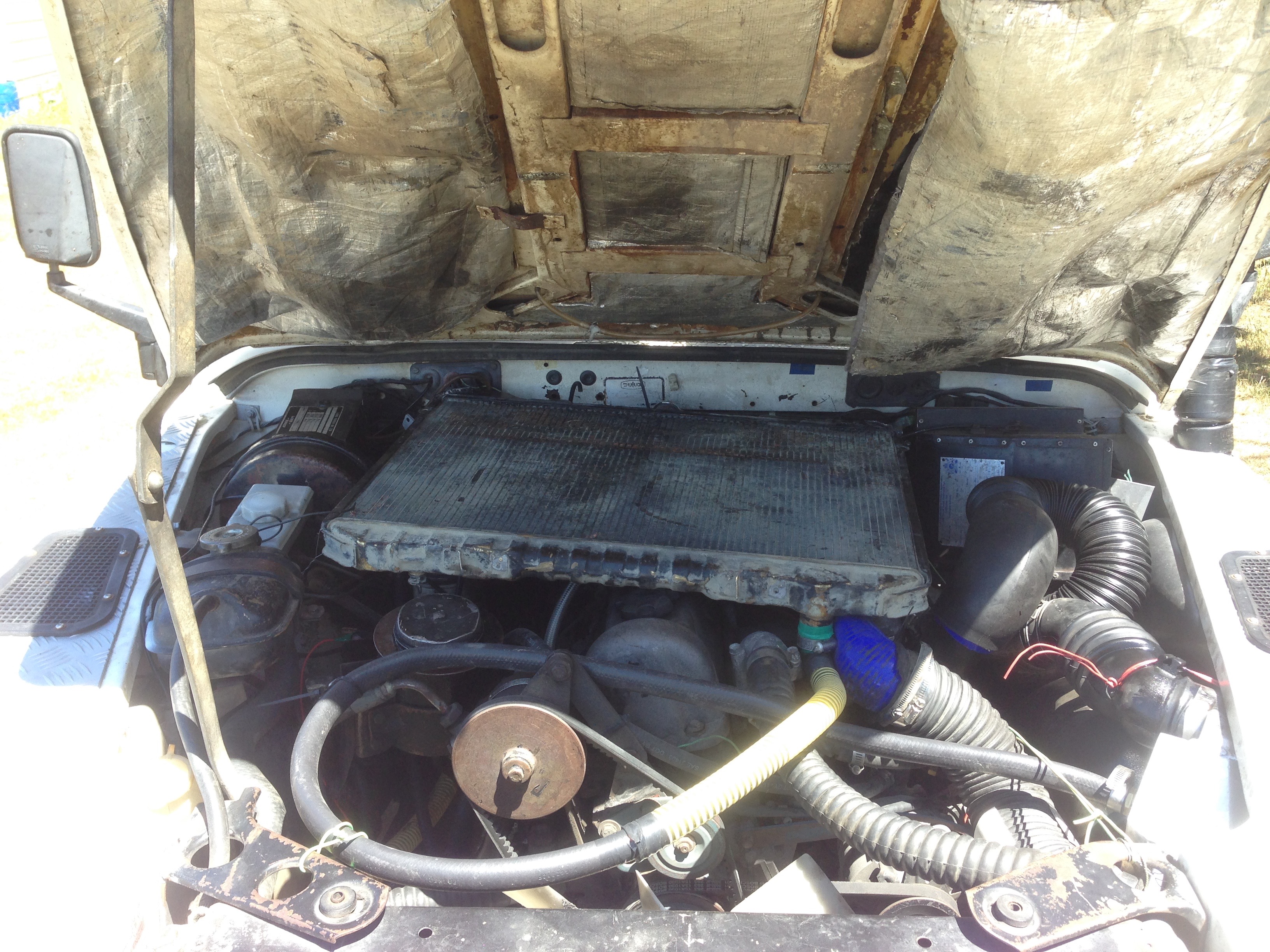

she's had the ld28 conversion, a turbo fitted where i recently fitted a rather high performance aftercooler, radiator and pump setup... still tinkering around with it.

and instead of an intercooler where outside air cools the air in the intercooler, you use a water to cool the air (takes the heat away faster and more efficiently)
so I'm using this - http://www.trademe.co.nz/motors/car-par ... 886671.htm
piped to a secondary radiator and a 25L/min pump circulating it all around.
they use after coolers on drag racing cars, Bugatti veyron has one so i kinda thought they would be able to reduce the intake air to the lowest possible temperature thus increasing density and more POWER!
has only really been on the engine the last 2 days and i have noticed a big increase in power, truck can hit 150-60 without hassle were as before 130-40 was my top speed.

oh right. that's what i call a "water to air intercooler"(W2A). that's a great gain you have had.
They(W2A intercoolers) used to be very expensive, but the chinese made cores have really dropped the prices down, though you have to factor in the cost of radiator, pump, and wiring.
Under bonnet photos of the install when you get time please.

here are some pics
excuse the bad drawing, shows the air flow,
