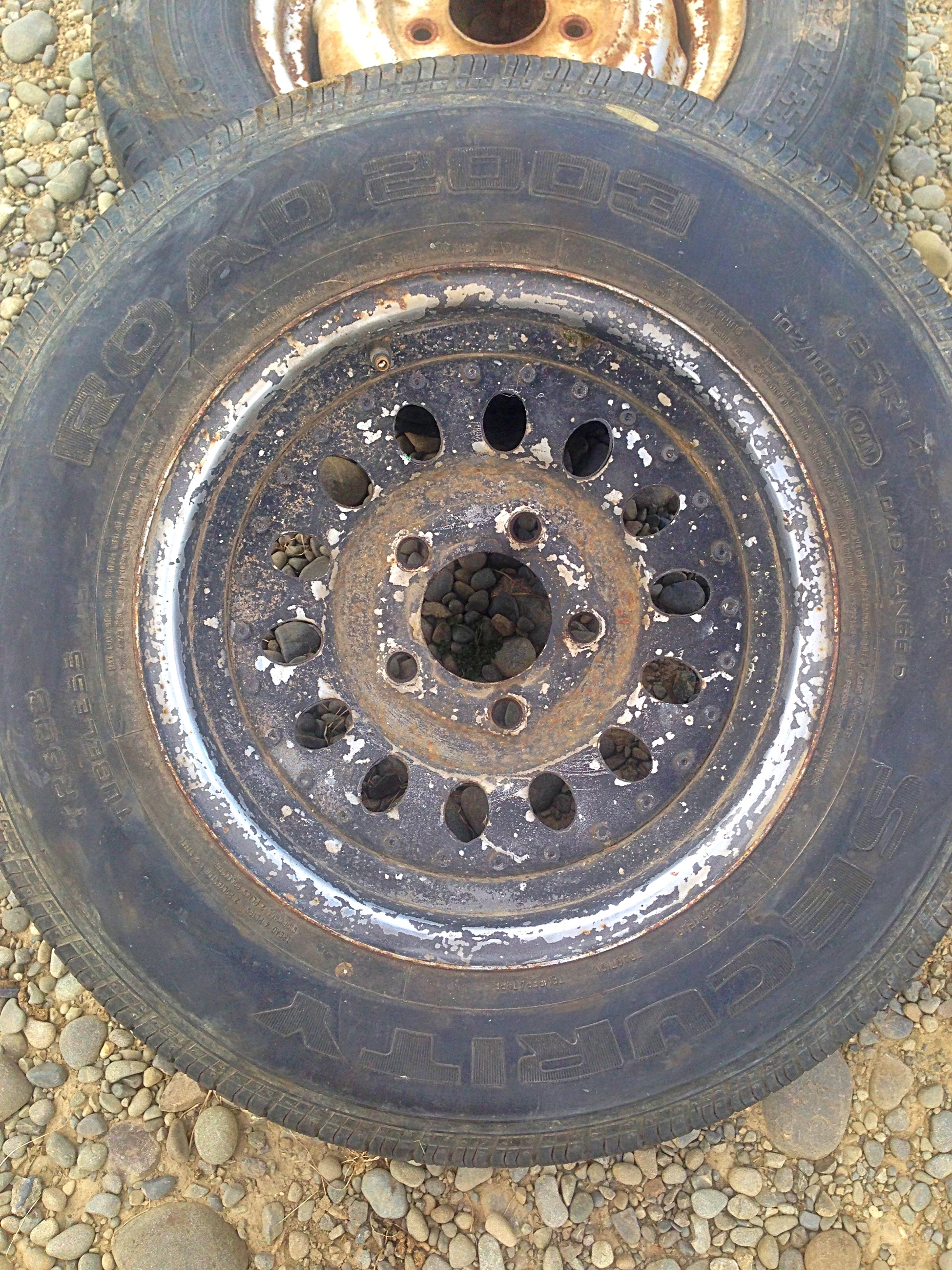

Hi. Just hoping a learned guru on here might be able to help identify what this rim is from please? I know it's a long shot but am trying to get another one to match. It's off an old trailer 14" and I need another to match as a spare.
Thought it might be worth a shot as it has those distinctive bolts all around the inside of the rim.
Any one help greatly appreciated before I troll round the scrap yards.

Looks like an aftermarket rim commonly referred to as 'Modular'
work out the PCD and the size of the centre hole and you might get an idea of what vehicle would suit.
5 stud so possibly old Holden or Ford

So far I've found its either a 14" Holden commodore or a HQ pattern. 80mm centre hole.
The two are very similar 120mm versus 120.65mm! but not identical so I need to work this out...

Ive got some standard HQ rims I could check off what you need to know?

Thanks for all your help, you're were right they are HQ. I managed to find one that matches from a place in Kaipoi. Happy days! :D
