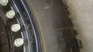

Hopefully this will keep him happy...
A bit wonky bit itlldo
