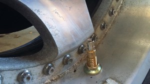

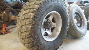

eBay brass dump valves, cheap as chips :D
And my old mickey thompson baja claw 33 for the road but building it to fit 35s.
derk
Posts: 836
Re: Lobstrosity
Post by derk »

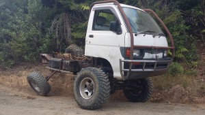

Mattrade wrote:The plan is to have a flatbed on the back. And if all goes to plan to cert it and use it to transport my Suzuki to 4x4 trips.
Shit that might be an interesting ride going around corners with all that soft flexy suspension travel :D cool project mate

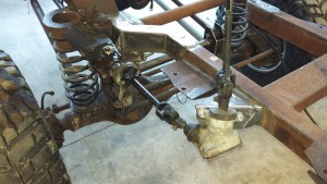

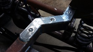

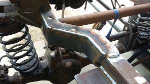

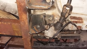

Got the steering mocked up, started gusseting up with some 6mm plate.
Mattrade
Posts: 386
Re: Lobstrosity
Post by Mattrade »
Nice and solid to start building off.

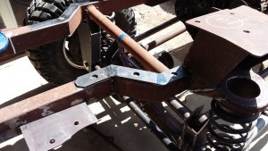

Pan hard bar chassis mount/steering box mount.
Mattrade
Posts: 386
Re: Lobstrosity
Post by Mattrade »
Steering mounted up 8)

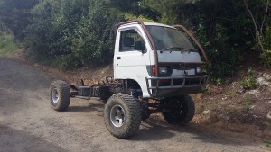

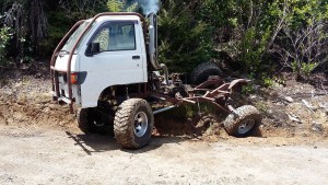

Rolling on all 4 steering and engine running mint. Clutch hooked up and breaks plumbed up to front. Drive shafts hooked up but thought i could get away with rear axle drive shaft misalignment but its just to much. Will drive with no springs in the back but fouls on droop. :roll:

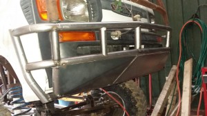

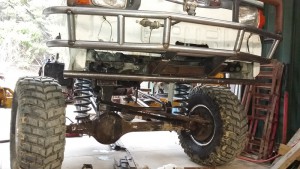

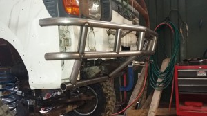

Started to build my front bumper while i save up for a new power plant and transmission.
Going for a silver top td42 and auto :D Deisel POWER
Mattrade
Posts: 386
Re: Lobstrosity
Post by Mattrade »
All up to date. Love the flex with no springs and shocks out back ha ha to bad it cant be.
Bumped well on it way.
Going to move on to the roll cage next.

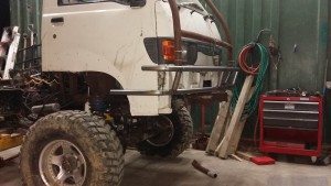

skidmark
Posts: 616
Location: hamilton

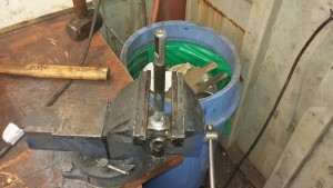

Re: Lobstrosity
Post by skidmark »
Is that a cut and weld on that steering shaft? Because if you want to cert it that's a big no no..that's what my cert man told me.
But otherwise looking forward to seeing it done!

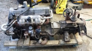

For sale if anyone interested.
Ld28 Turbo. Mated to Toyota 4speed with pto output. 180k on motor. Had it all running and driving no problem. Changing to fix my misaligned rear drive shaft.
1600 long
600 wide
650high
Pm if u interested.
located Auckland

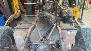

Mattrade
Posts: 386
Re: Lobstrosity
Post by Mattrade »

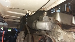

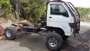

The reason for the change, huge drive shaft angle :roll:
mudlva
Posts: 2918
Re: Lobstrosity
Post by mudlva »
Yukkkk :cry: :cry:

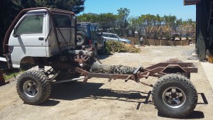

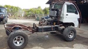

Mattrade
Posts: 386
Re: Lobstrosity
Post by Mattrade »

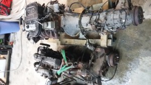

A quick 11 hour drive to New Plymouth - picked up a 4.2 silvertop with auto box. With 172k on the clock.
Started it up on the workshop floor... started after 2 cranks and no smoke - so stoked 8)
So drive shaft angles are no longer an issue but its ####### long as hell so the hole truck is getting extended by 350mm!!!!!! :oops:

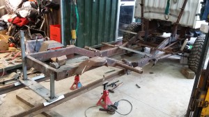

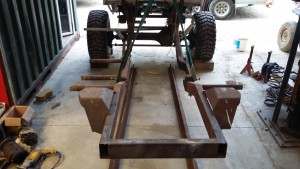

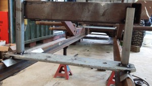

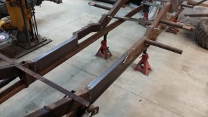

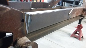

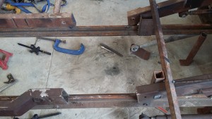

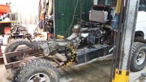

Got down to chopping it in half. Started a new job in the lift industry so have a few big steel rails that lifts run on and thought they would be perfect to use as a jig to line everything back together and stop it twisting as i weld it up.
Mattrade
Posts: 386
Re: Lobstrosity
Post by Mattrade »
Extended and fully welded ready for a 5mm plate to stiffen the joins up. Also going to gusset the inside just to make certain its good and strong.
Using standard swb rear drive shaft.

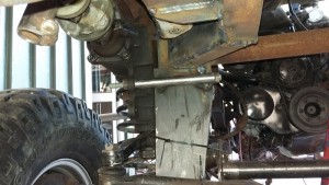

Mattrade
Posts: 386
Re: Lobstrosity
Post by Mattrade »

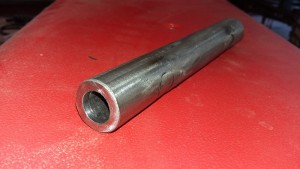

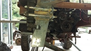

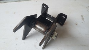

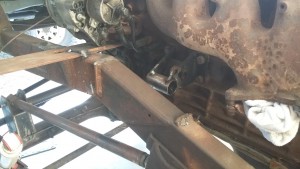

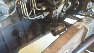

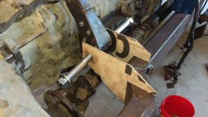

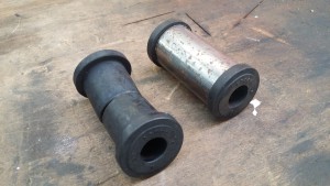

All the engine mounts where worn out and one missing. Thought i would make some super strong ones.
Found leaf spring bushes from Repco, 34 OD 18 ID for 5 bux each.
Used thick wall 1.5 inch tube and a M18 bolt with Nylocs
will do the same for the gearbox mount.
mudlva
Posts: 2918
Re: Lobstrosity
Post by mudlva »
Use a m12 bolt and fit a 3mm wall crush tube otherwise you will destroy the rubber ends.
I used similar idea but used a l.c. radius arm bush.
Great feeling knowing that if the rubber lets go it still cannot part company from off the chassis mount.
Mattrade
Posts: 386
Re: Lobstrosity
Post by Mattrade »
Dam wish i had realized that ha ha but your right. Easy ish to fix.
Thanks man

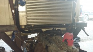

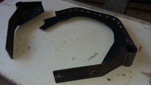

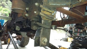

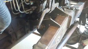

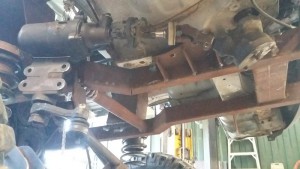

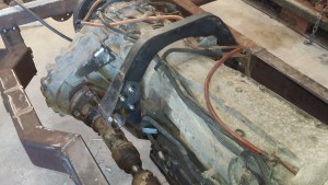

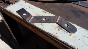

Rear gear box mount. Made a crazy wrap around mount to get it nice and high out the way of drive shaft.
Mattrade
Posts: 386
Re: Lobstrosity
Post by Mattrade »

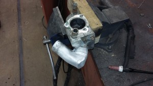

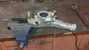

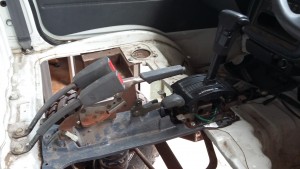

Thermostat top housing cut and turn and shifter install.
Mattrade
Posts: 386
Re: Lobstrosity
Post by Mattrade »
Plumbed up :D
