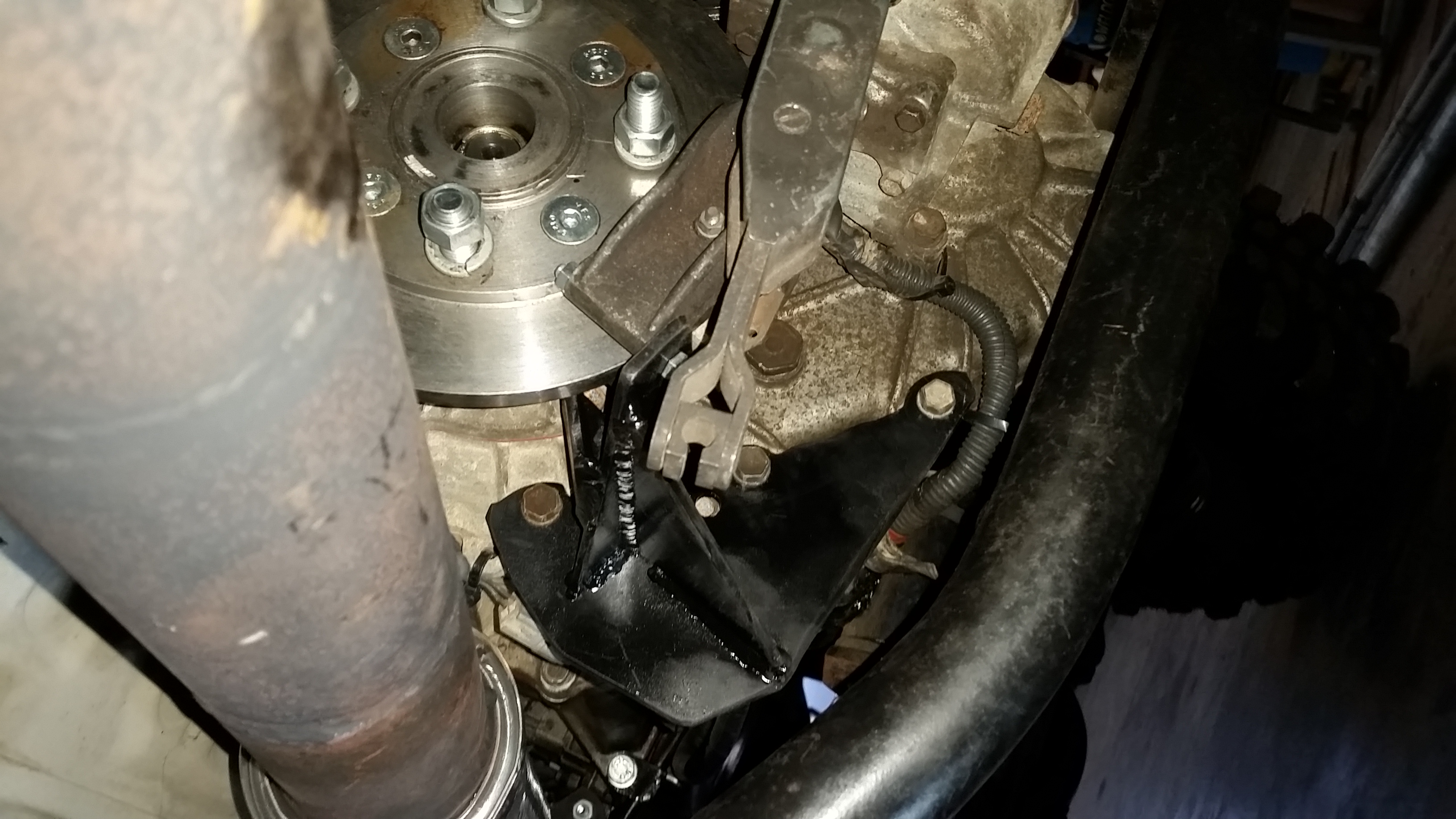

Have made handbrake bracket. Bolts are only single shear...just been thinking since I've finished it should probably support both sides as there only 6mm bolts
Way easier to make on the bench with a extra transfercase.
You do not have the required permissions to view the files attached to this post.
skidmark
Posts: 616
Joined: Sun Sep 12, 2010 2:24 am
Location: hamilton
Re: first surf build.
Post by skidmark »
Got most of handbrake sorted . need to sort cable and a couple proper bolts.

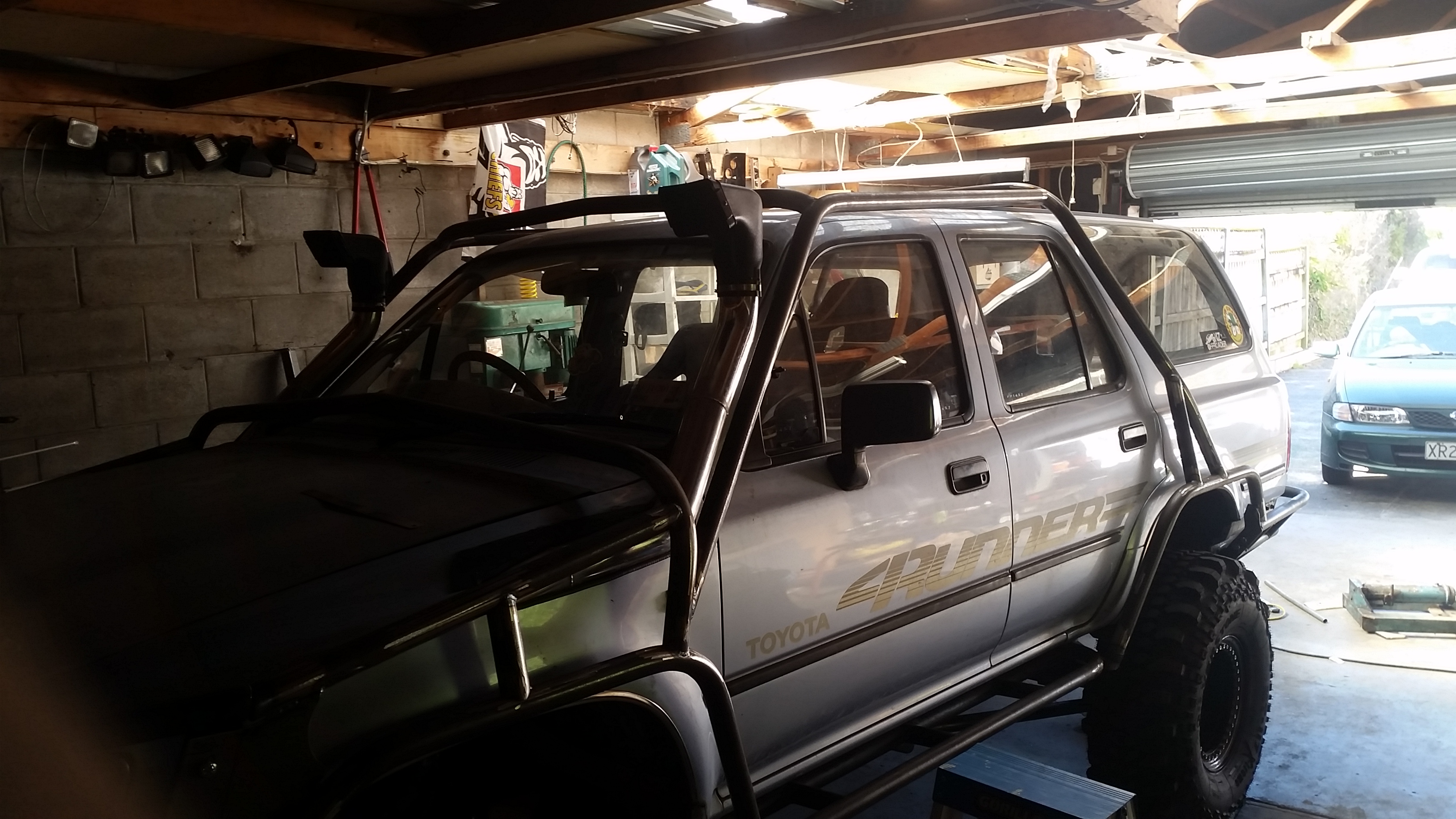

Spent afternoon on it did a couple more bends
Guessing having a bend in the windscreen bar isn't ideal, but thought it'd be better to get the corners low enough yet have room for bonnet etc

Made some more progress, rear guard hoops are attached. Main hoop over body attached .this part sits a bit close to my liking In a couple spots and I'm sure this will meet contact with the body at some point t in time. Did some other important tasks like p clipping fuel lines to body and finally attached earth permanently. Respect to the guys that knock these cages out somewhat fast. Everything is only tacked/outside welded. Plenty of braces and welding to add..try weld as much as possible on body and take off for weld and paint.

Big wrote:Are you going up a pillars and across the roof with the exo ?( Can see the cab getting a beating.. :lol: ) otherwise well done.. :wink:
Haha yes of course I am.full body exo is the plan.
Kinda like this for rear
But with out twin Centre hoops as I don't think I could get two hoops to be identical enough to be that close.
Will of course go over a pillars and over cab

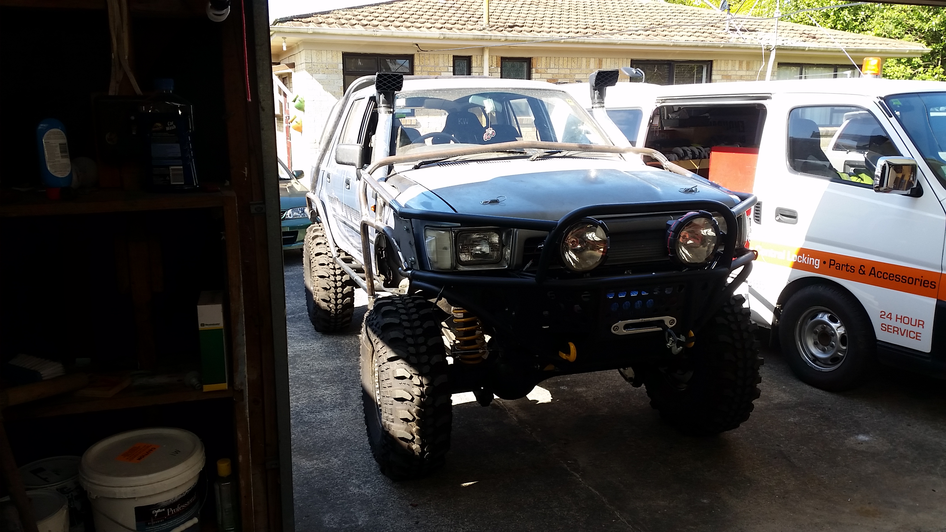

Couple of more bits done. Only tacked as tig bottle ran out turns out it needed a re test...finally got an adapter to connect co2 bottle to mig..only taken 6months

Exo is all pieced together..a few braces too add where it bolts on . then work out how to get it off too weld up the inside.think it's going to be front bar off, wing mirrors off maybe and possibly tyres off. Maybe.
Also need to swap rear springs for 4 inch lift.have 2 inch lift swb saf in there but sits 60mm lower than front.
