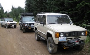

But don't look past first generation Isuzu Trooper/Bighorn. Worked on them quite a bit, had mates that own them but have never personally owned. They have truck DNA all the way through, the chassis is semi-boxed (Nissan WD21), the gearboxes and diffs (including the IFS diff) are all really strong. As a multipurpose vehicle with good on road handling, its built like a brick shithouse. Just get an early one, ie a JDM one
This was our fun adventure
