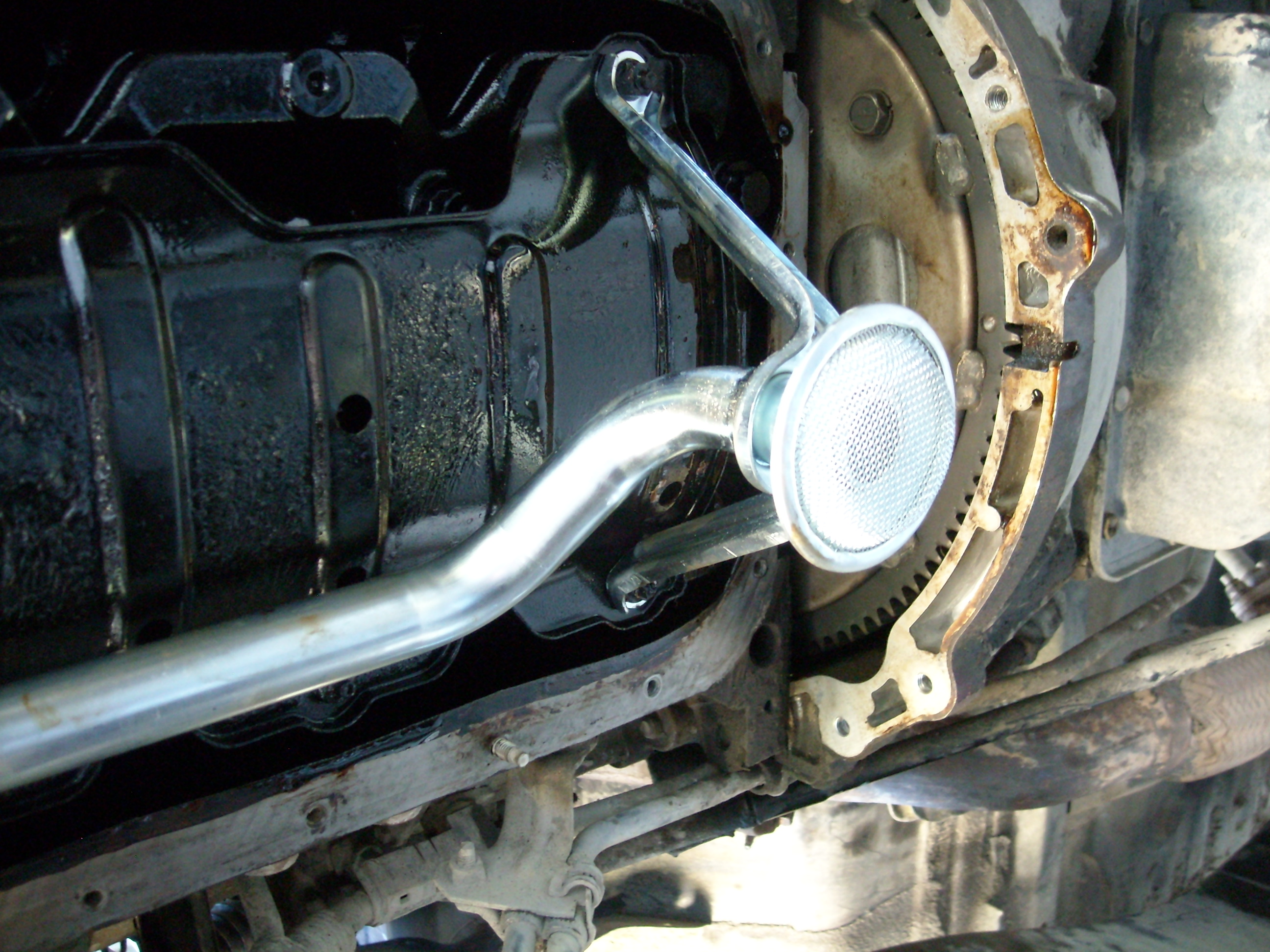

old pan off
look how clogged the old filter is
and how clean the new one is

new pan on.
new dipstick.

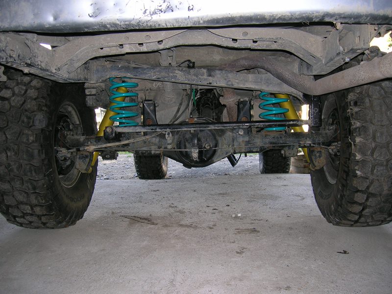

front bar made.
thanks baden.
next job bar off, paint it. next weekend swap rear diff for the prado diff & 4" lifted springs. bleed brakes. then fit (hopefully can figure it out) the TRD supercharger etc.
Andrew 0272226292.

1st coat of paint tonight.
Andrew 0272226292.

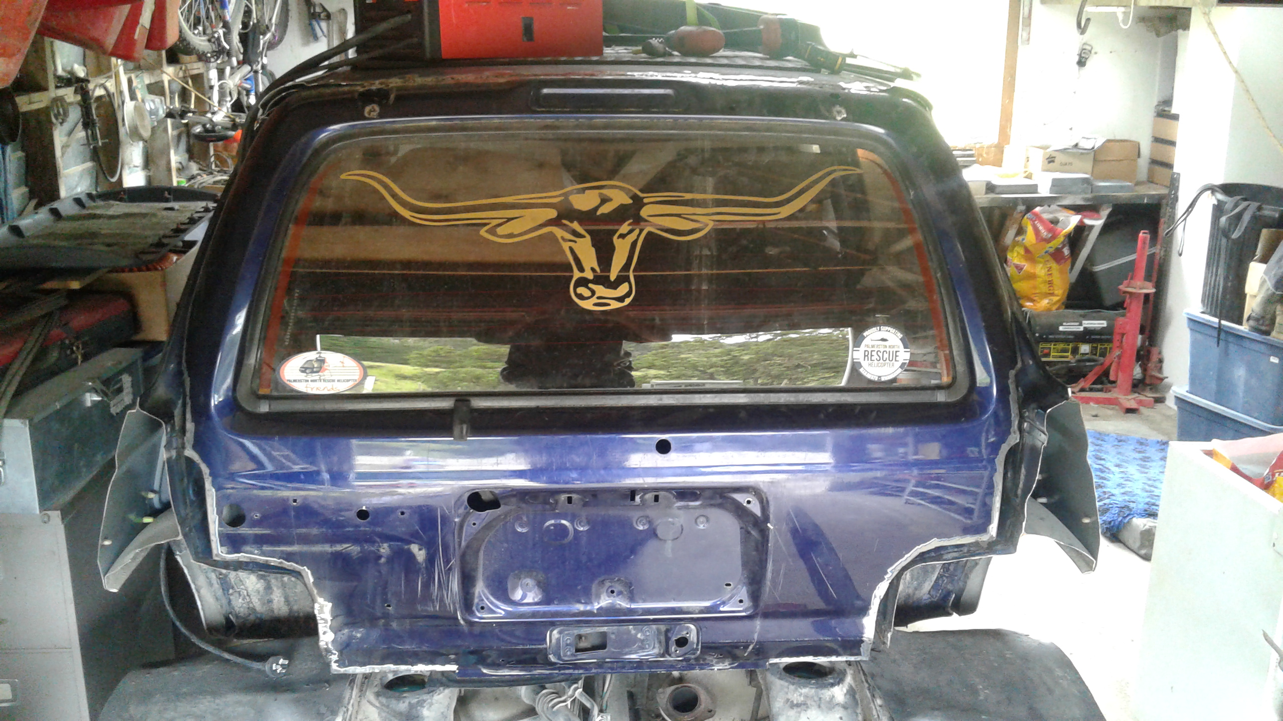

back nearly stripped out ready for cutting. roof lining to unclip and windows to take out.
seats can stay there until back is in right place then take them out.
Andrew 0272226292.
mudsurfv6
Posts: 649
Location: pahiatua
Re: 96 v6 surf
Post by mudsurfv6 »
no going back now. :)
Andrew 0272226292.
mudsurfv6
Posts: 649
Location: pahiatua
Re: 96 v6 surf
Post by mudsurfv6 »
Now just got to measure where it's going to fit and cut it neater. seat belts dictate where back goes.
Andrew 0272226292.
mudsurfv6
Posts: 649
Location: pahiatua
Re: 96 v6 surf
Post by mudsurfv6 »
A bit done, partly bird pood in. A few gaps where not cut flush, will cut guards and pull gaps closed, won't be visible behind deck anyway.

mudsurfv6
Posts: 649
Location: pahiatua
Re: 96 v6 surf
Post by mudsurfv6 »
All closed in, just some bog to smooth off and paint. :D quite pleased considering it's the first time i've used a mig.
Andrew 0272226292.
BlakeNZ
Posts: 710
Location: manawatu
Re: 96 v6 surf
Post by BlakeNZ »
awesome, been waiting for this stage. Any side on photos?
Can i assume you are retaining the rear window function of being able to be wound down, electrically?
mudsurfv6
Posts: 649
Location: pahiatua
Re: 96 v6 surf
Post by mudsurfv6 »
BlakeNZ wrote:Can i assume you are retaining the rear window function of being able to be wound down, electrically?
that was the plan, but would only go down to top of arches, which is about half way. also I had to cut the bottom off the runners the window slides in to fit around arches. so window now doesn't move.
plus the rear radiator will either be behind window on the left, or horizontal on roof straight above rear window so be safer if window didn't open anyway.
BlakeNZ wrote:Any side on photos?
have tried to take a sideish on photo but not much room in shed, i'll add off my phone.
Andrew 0272226292.
