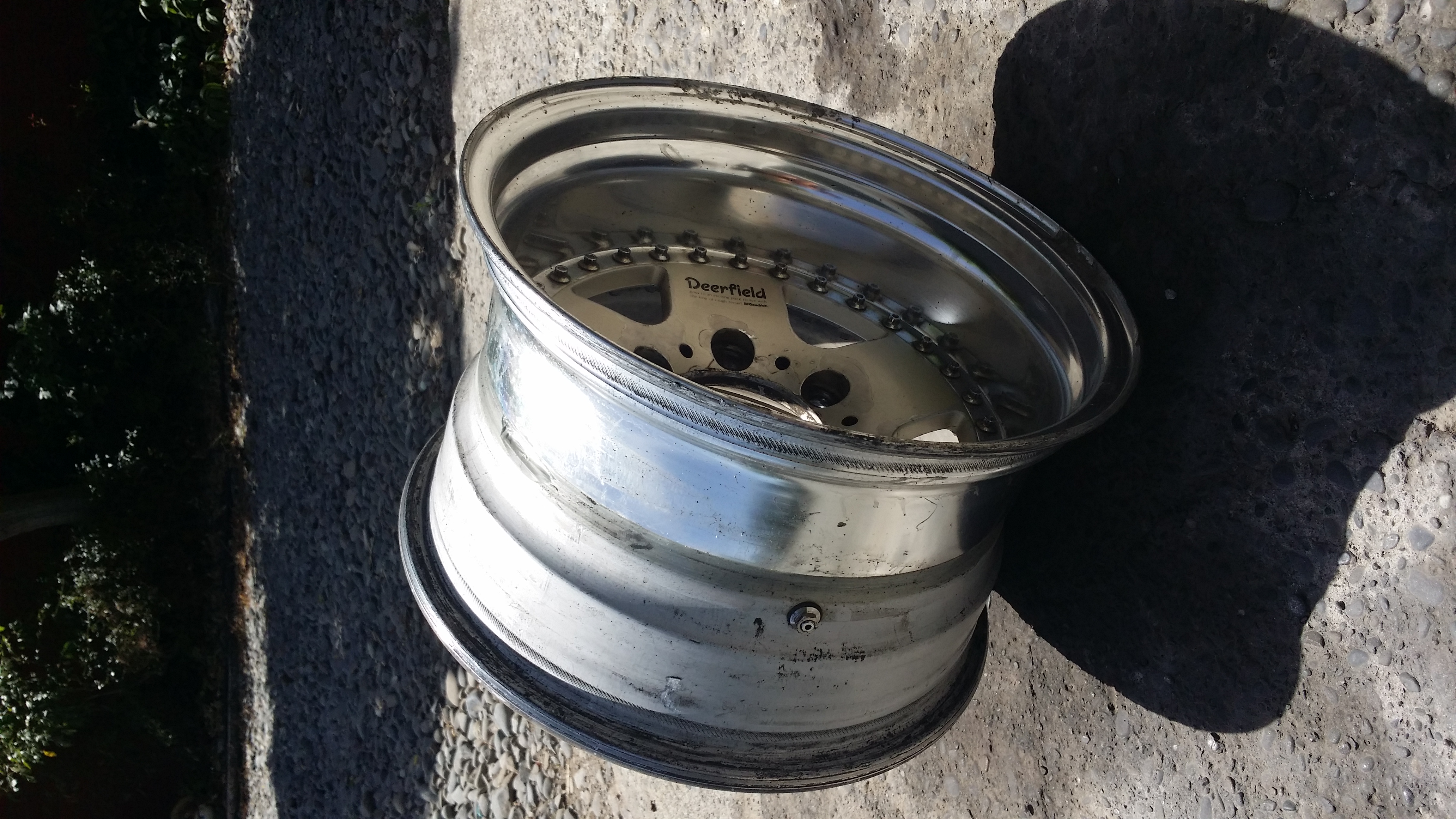

New tyres and rims. Have 5 matching rims, about to send away for a refurbishing at pine engineering before fitting up the new 34" mt+ geolanders.

The wheels with 31s fitted. They look bloody retarded far too small.
