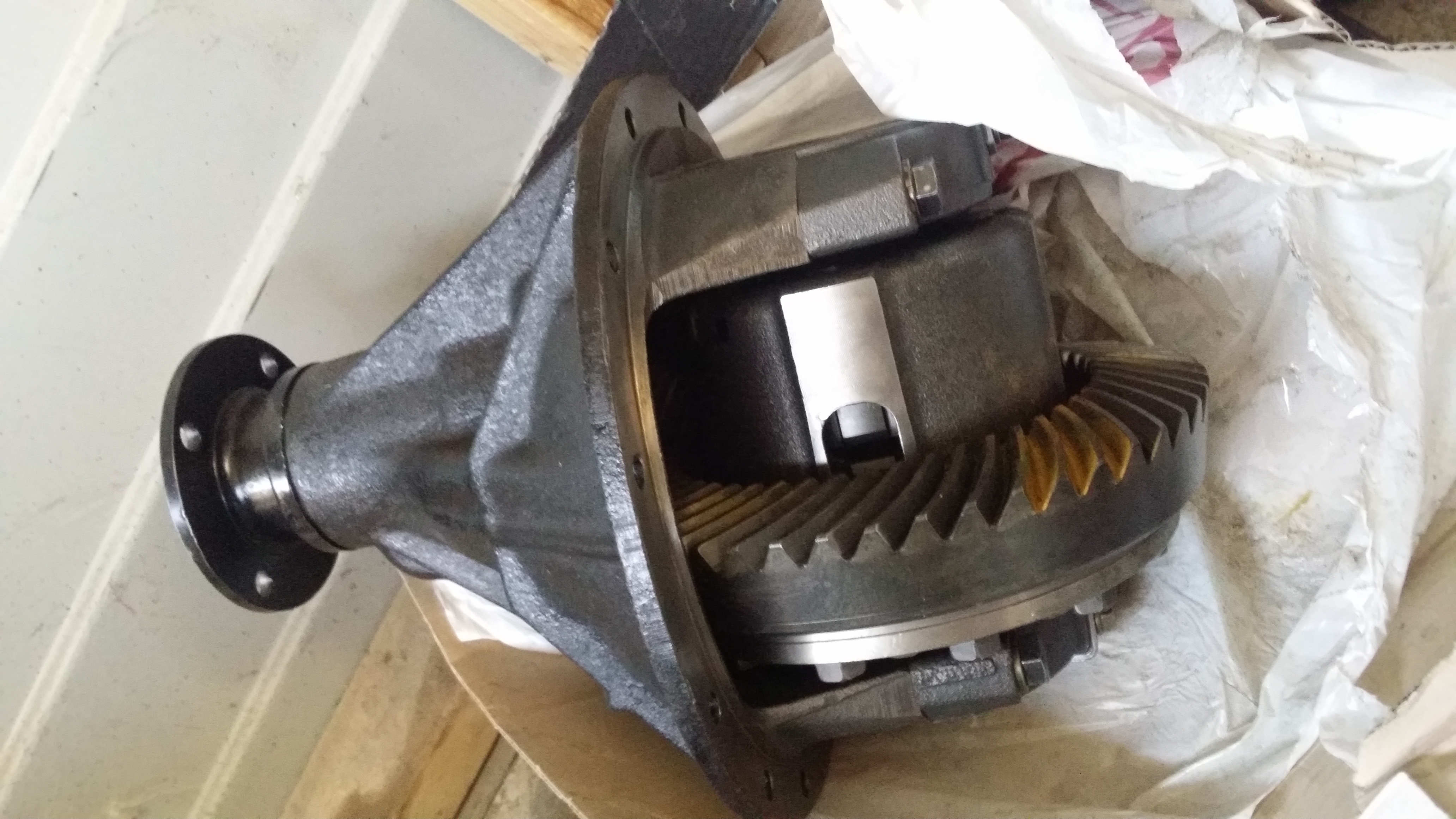

And the rebuilt and shimmed 9.5" lsd head. Can't wait to see how this performs. The guy at the diff shop said its tight as a nuns c**t

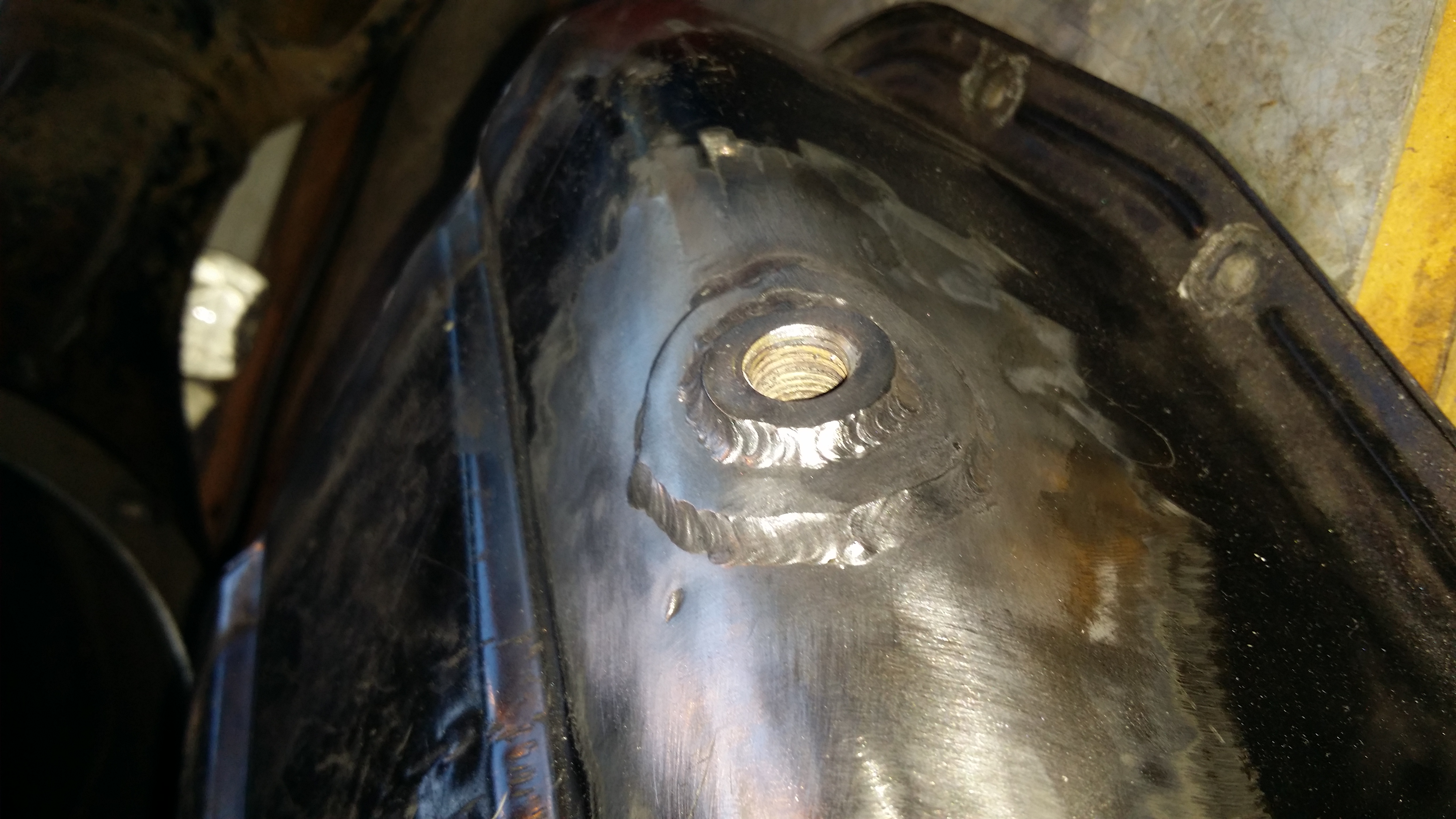

Managed to get some time to work on the truck this weekend. First up my sump pan is all notched and finished to clear the diff, and sump bung relocated to make oil changes easy as

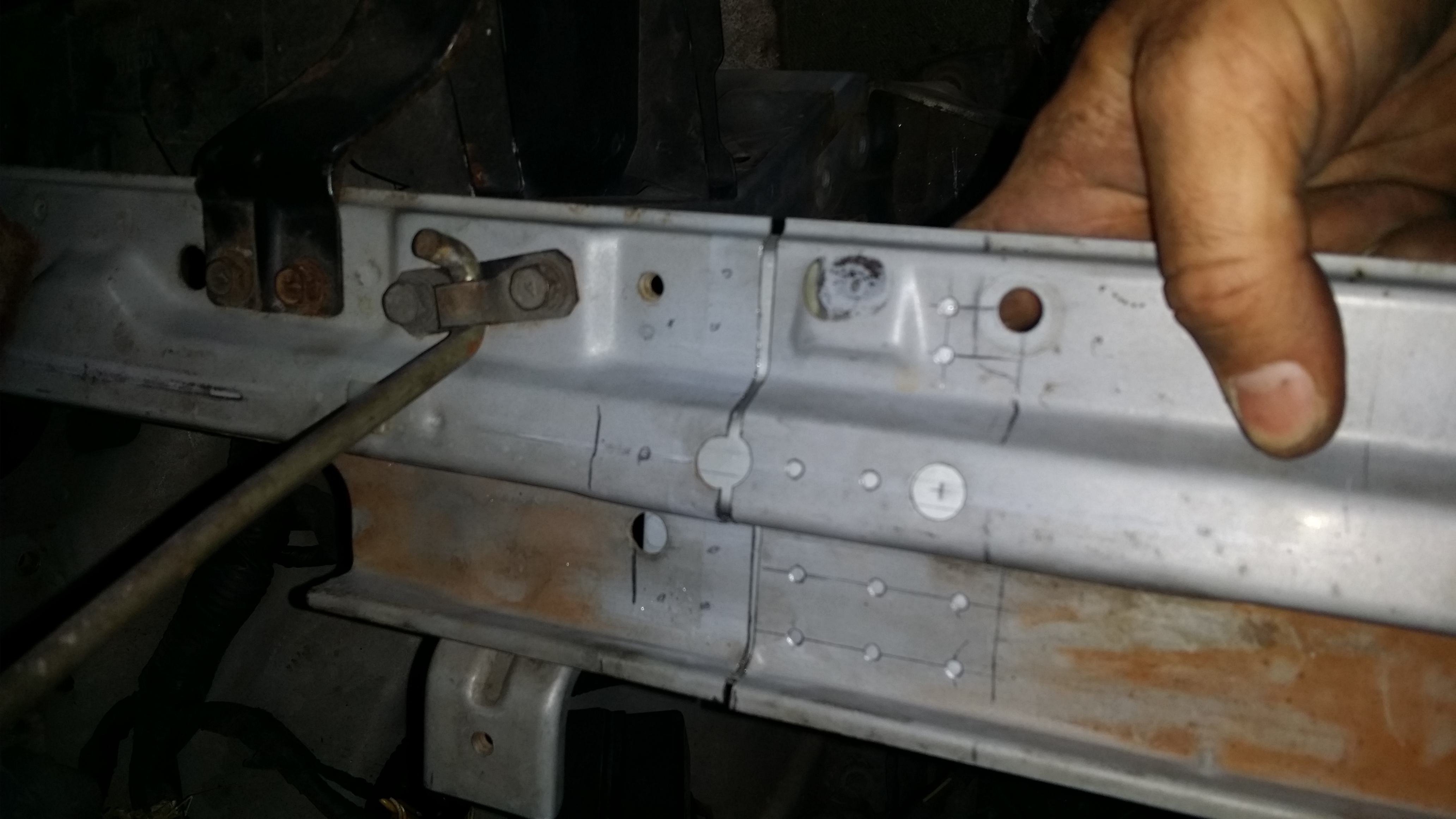

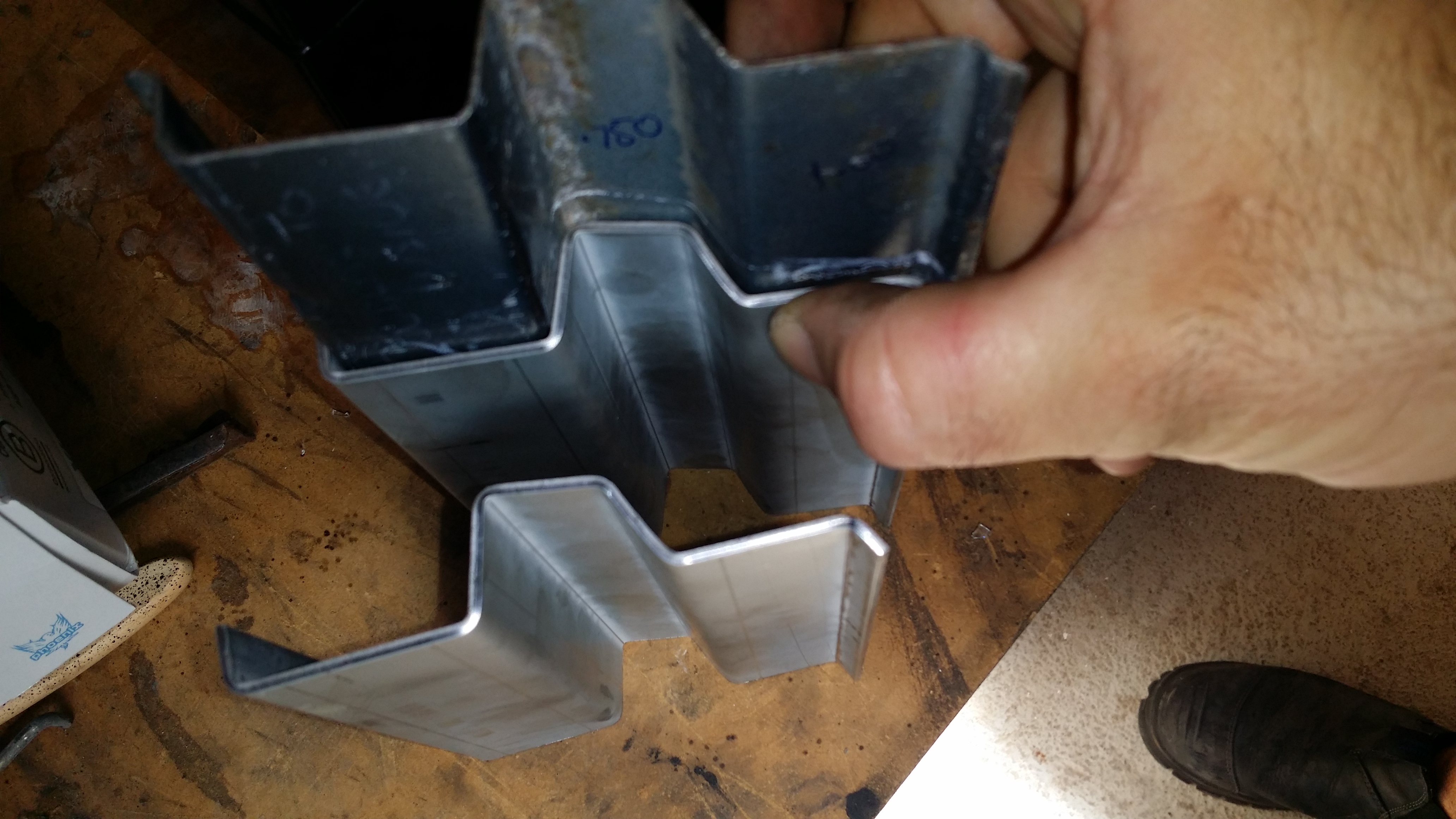

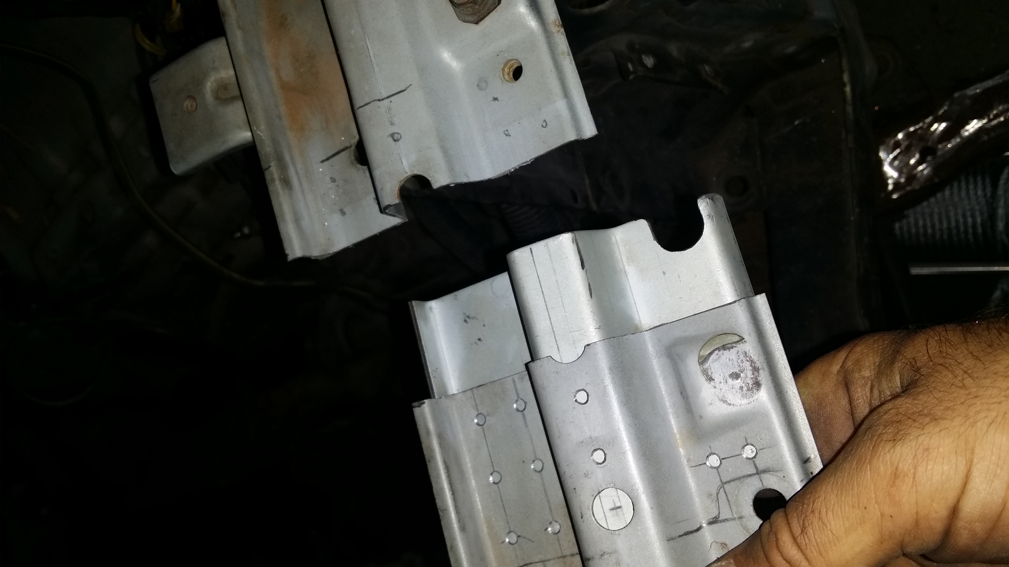

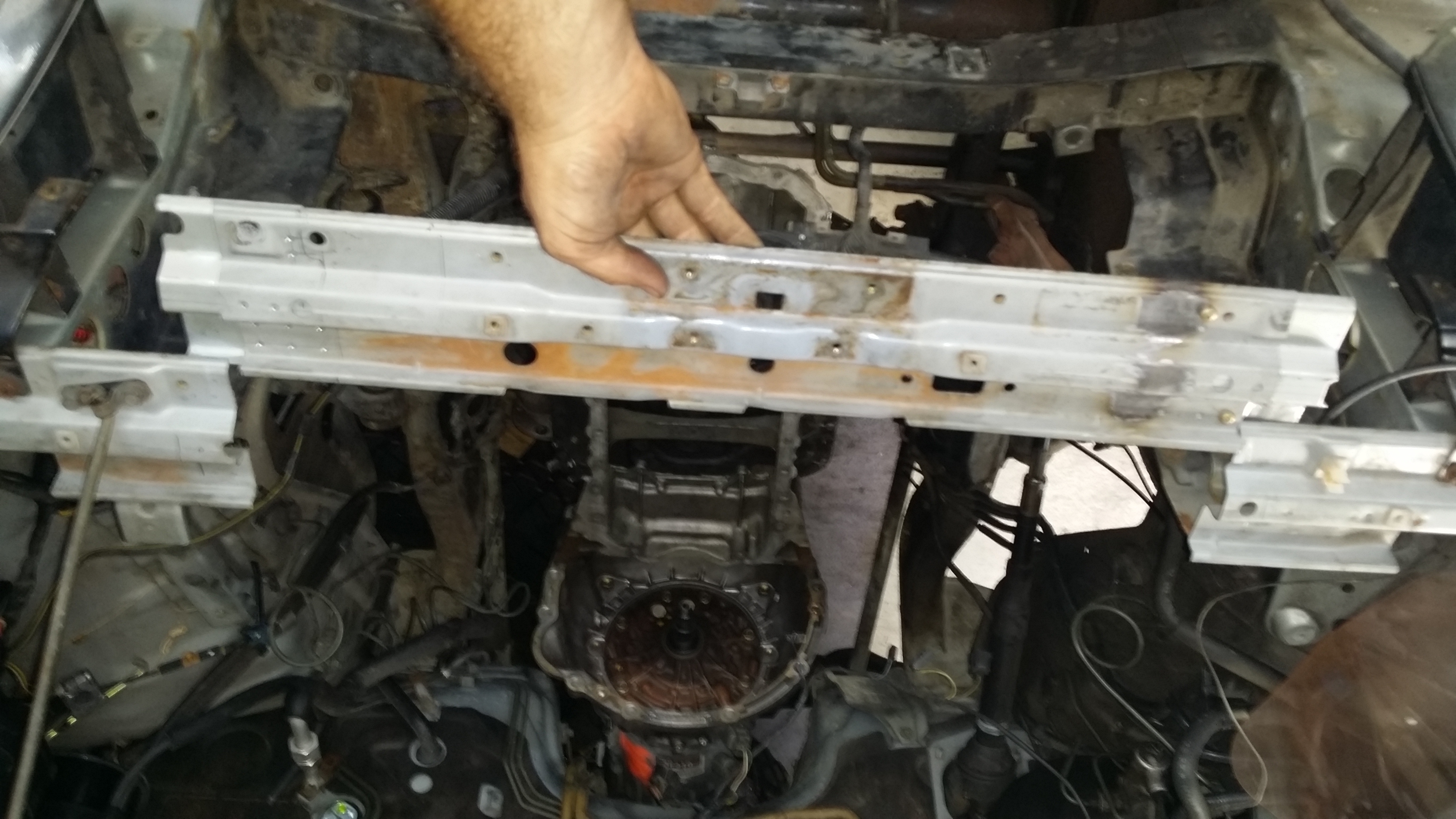

Also got a mate at work to cnc fold up a extrusion for making my radiator support removable. Have cut the panel now and started drilling off the doubler underneath for some fasteners.

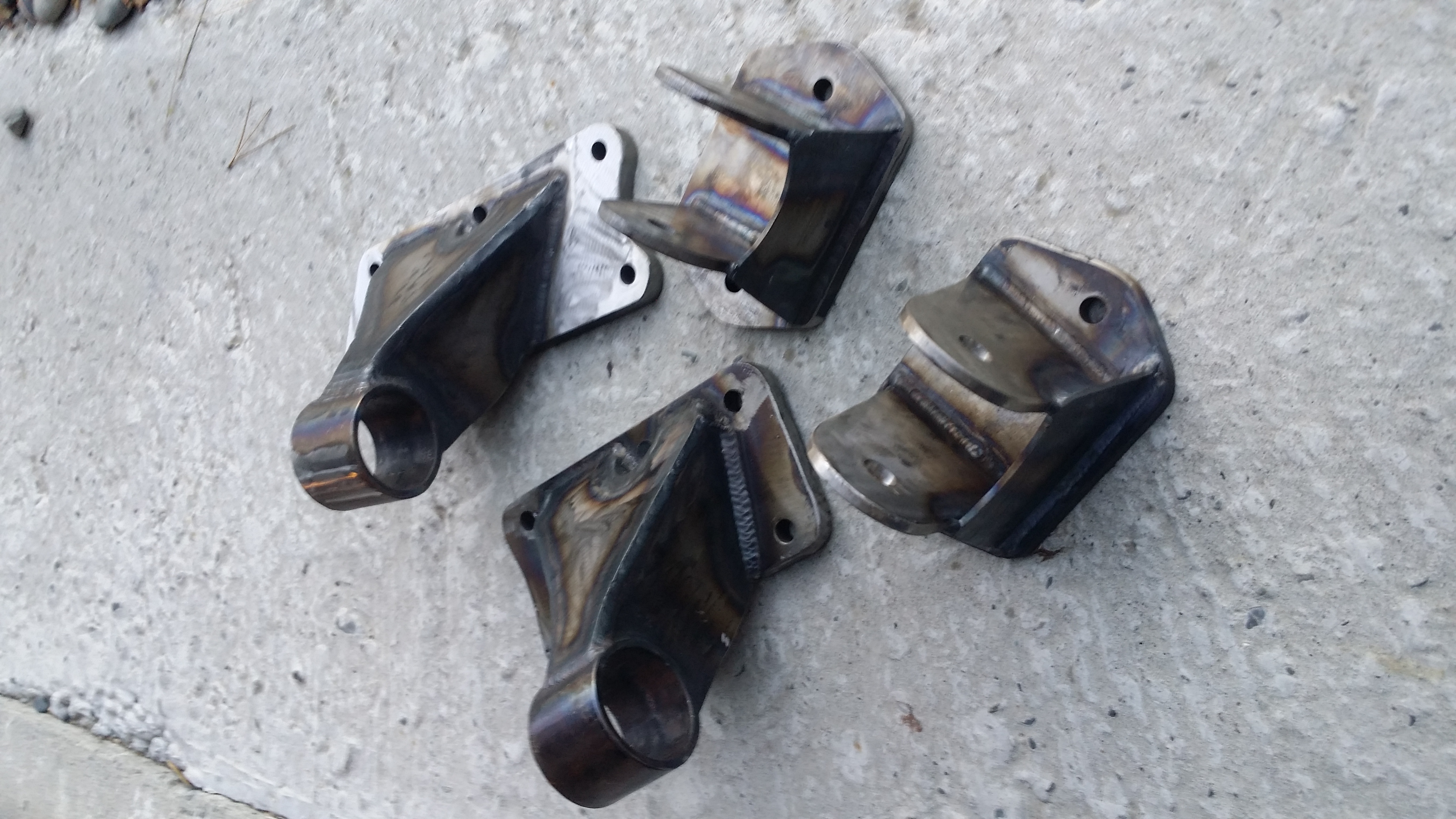

Time for an update,many hours have gone into the truck in the last few weeks, but my engine mounts are now all finished. The motor sits exactly where i want it, and its looking really nice in the hole!!
It dosent look like much work but that lot took me around 40 hours to make. Base is 10mm, sides are 7mm and backing is 3mm. Using y60 safari rear control arm ends and bushings for the mounts. They have come out well, fair to say I bloody love my tig!!!

And all painted and attached to the truck. and there it is, a 2jz bolts onto a pajero just like that

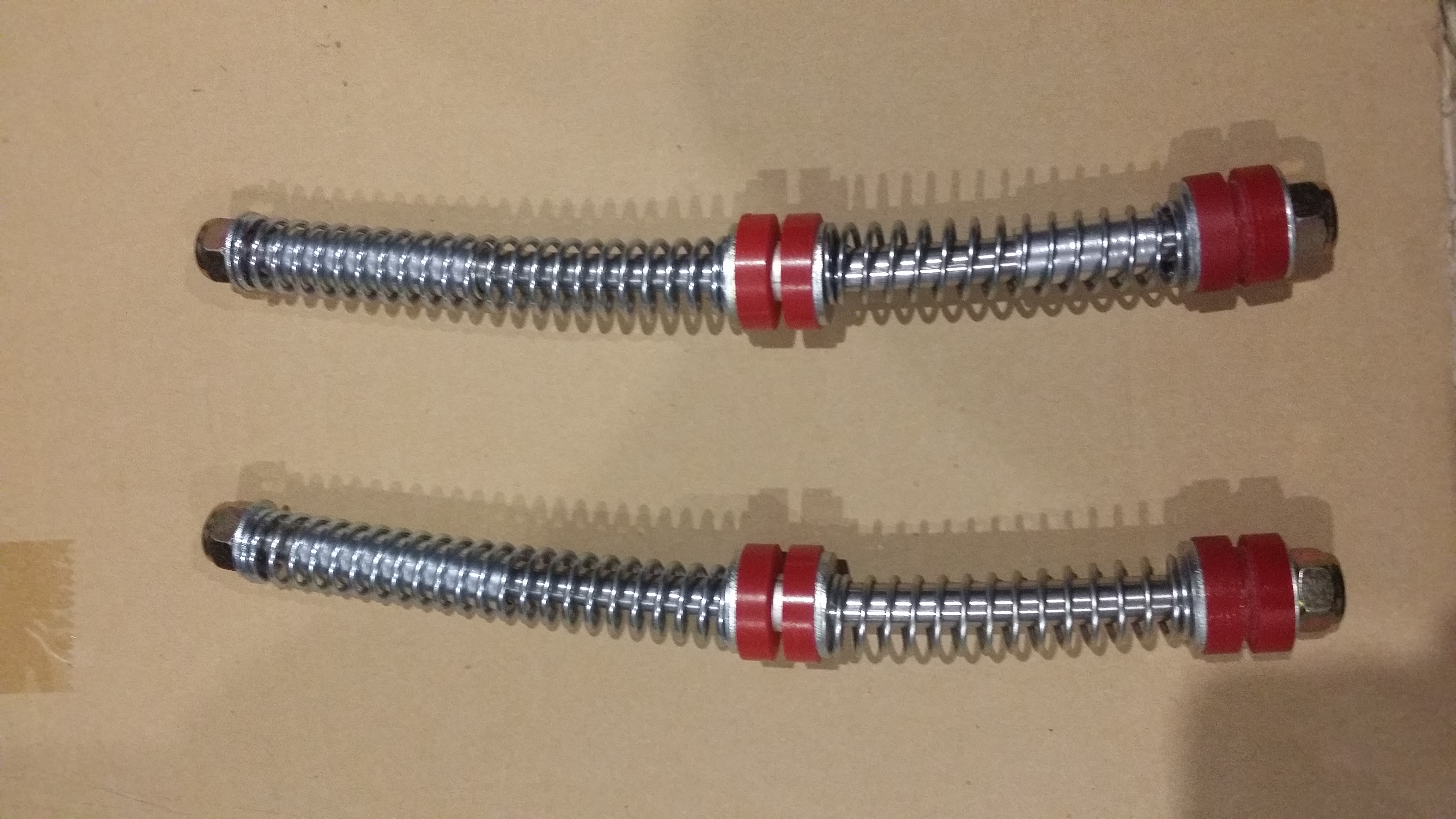

And also managed to get a set of rear swaybar disconnects.

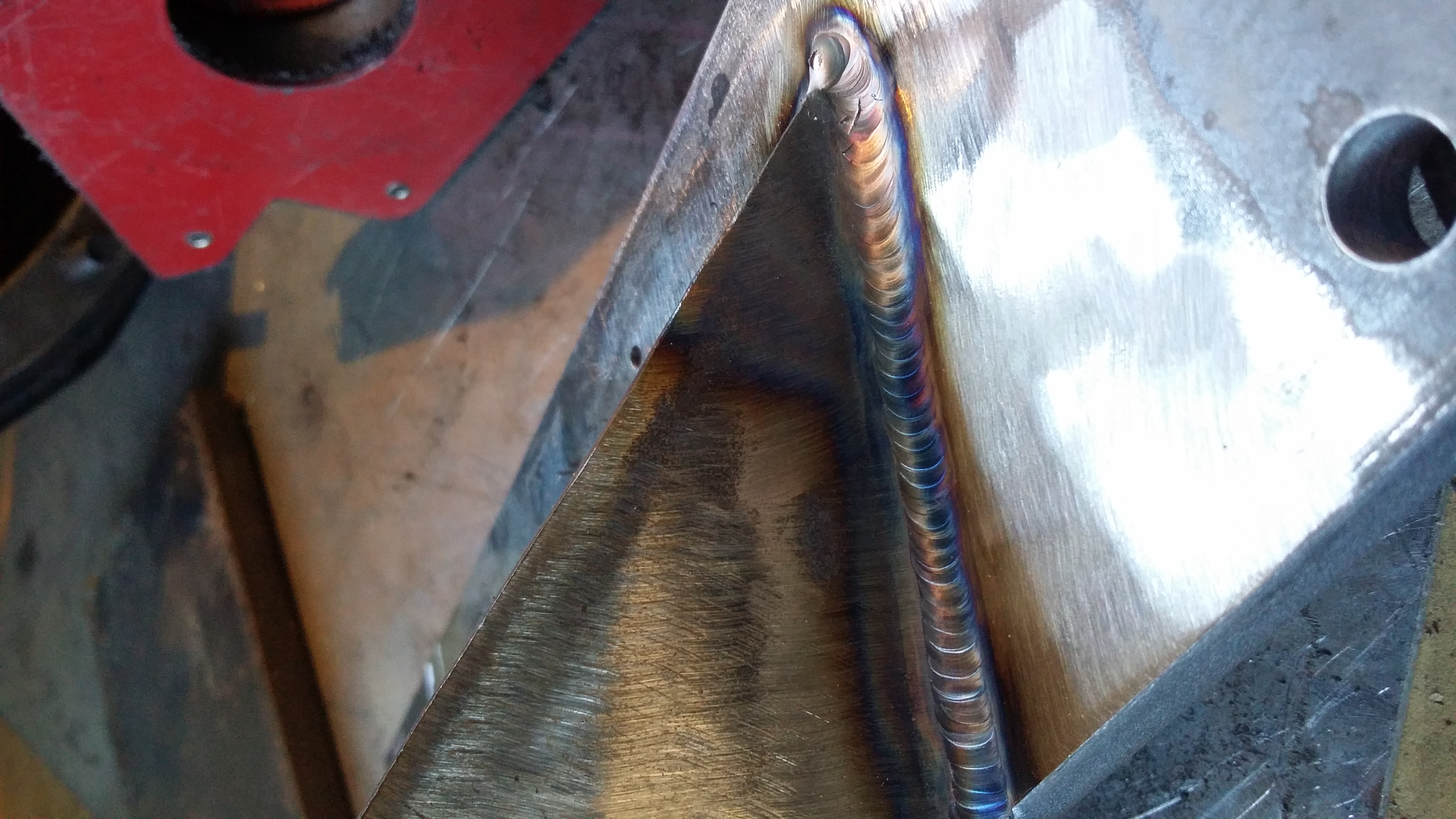

Neat TIG welds there fella!
Re: My Pajero build. The Whale mk2.
Thanks Rusty, slowly improving, I really don't get as much time on my tig as I'd like but getting there.Rusty wrote:Neat TIG welds there fella!

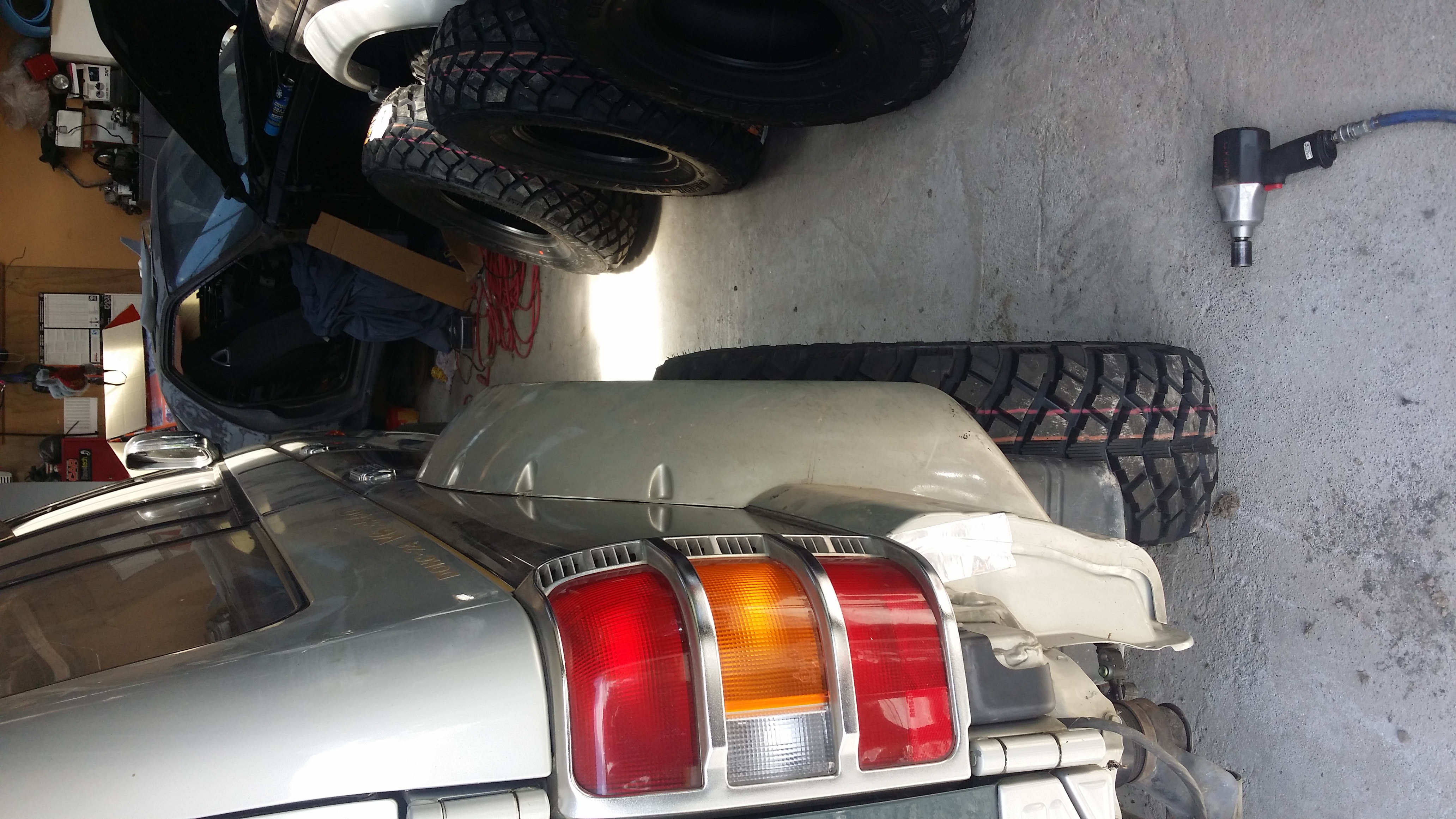

Tyres fitted to rims last week. Getting these dirty for the first time is gonna make me cry a little I think haha.
Looking good mate, guna look better buried in a mud hole at full noise!

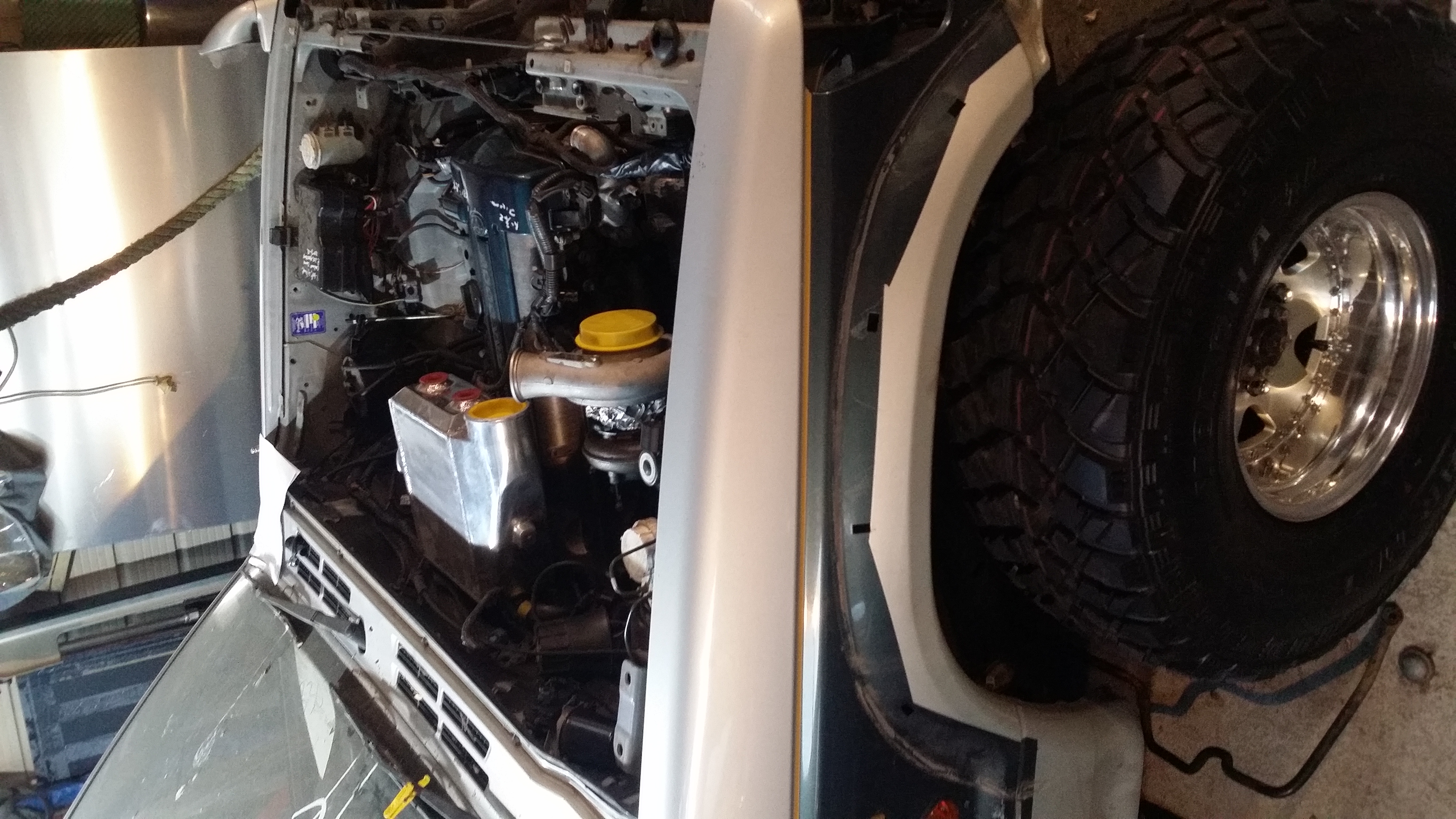

Nothing to interesting to report lately, been working on a few wee sideline projects, mainly a watercooler for my tig torch and a few other bits to make my life easier. Turbo manifold adaptor is finished, turbo placement is sorted so fabrication of the exhaust is up next. 3.5" piping is on order so hopefully have some more visual progress next few weeks ☺
