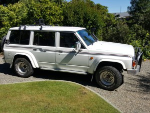

If it's a 1999 then you have a GU or Y61 and they didn't come out as Mavericks. Only Patrols/Safari's. Is it lwb or swb?.
Can you put a pic up pls?
Just re-read your post...a 24v Maverick???!!!. Something doesn't stack up and definitely would like to see a pic!

Nope definitely gq y60. I think it is a nissan chassis and equipment including 24v system, and a lwb low roof maverick body imported from Australia when the run ended. It was built up in 1999 and certified at that time. Bit of a custom build i reckon.Twodiffs wrote:If it's a 1999 then you have a GU or Y61 and they didn't come out as Mavericks. Only Patrols/Safari's. Is it lwb or swb?.
Not sure how to put up a picture?
Anyway followed advice on here and have discovered my 2 solenoids work (the vacuum flicks over between the 2 lines when i flick the switch, the vacuum.is fine at the actuator on the diff and the diff engages. Evenchecked continuity on the signal lamp circuit and it all works....so the only thing wrong is a blown bulb in the instrument panel....will replace that next weekend.
Re: Noobie questions - suspension and diff locks gq y60
Just worked out hiw to add a picture!
