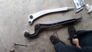

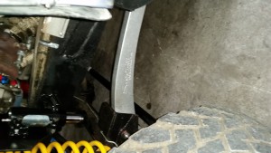

Well arms are in,speedy lube &tyre boys threw it on the machine again..around 5.5° caster so went to cert man he's happy. Did suggest moving panard down 10mm or so tho.
Will add photos later
skidmark
Posts: 616
Location: hamilton
Re: first surf build.
Post by skidmark »
There certainly solid, the factory arms are around 9.5kg the long side superflex is over 15kg...
I think they improved front flex a bit not heaps amazing from what I can tell in my shed.

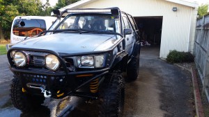

Tentatively say I think it's ready for d day
skidmark
Posts: 616
Location: hamilton
Post by skidmark »

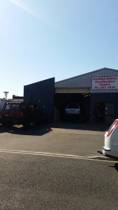

Dropped it off this morning,had 4 issues already before I left,3 are easy to solve
1. Change horn to electric
2.fit seat rail to driver's seat
3. Heatsheild above rear exhaust incase of fuel leak
The 4th possible problem child is the filler is inside passenger compartment,either have to move it outside which could be a problem due to tank height or install a vapor proof barrier...

Called in today at certifier,have made it through bumpsteer tests a small ish list of things to cheak and sort a few Heatsheild attach the brake like every 300 mm (I ran it inside but not attached every 300)
Adjust steering stop.
Somehow balance my silvys.
Speedo is out of adjustment but that's just drive and reprogram..not quite sure what cause 20mm difference between 35 Silverstone and 35 bighorn.
Take spring of rtc steering damper
Plus a couple other small issues that I can't remember

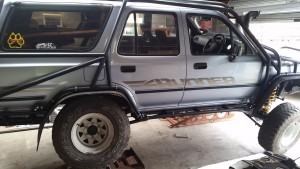

Got it back today
My list
1 drivers seat to adjust
2 change toggle rh dash
3 fuel filler issue
4 electric horn
5 brake line every 300mm
6 tidy weld panhard brace
7 bentsteering shaft?
8 windscreen
9 wheel alignment sheet
10 steering tierod fouls on superior plate,
11 replace some rear susp bolts
12 remove rtc dampner spring
13 sheild fuel line by muffler
14 strip beadlock for assemeent
15 cover battery terminals
16 crush tubes rear seat braket
17 remove seat for inspection
18 sheild exhaust from gas leaks above
19 balance beadlocks
20 speedo to correct
