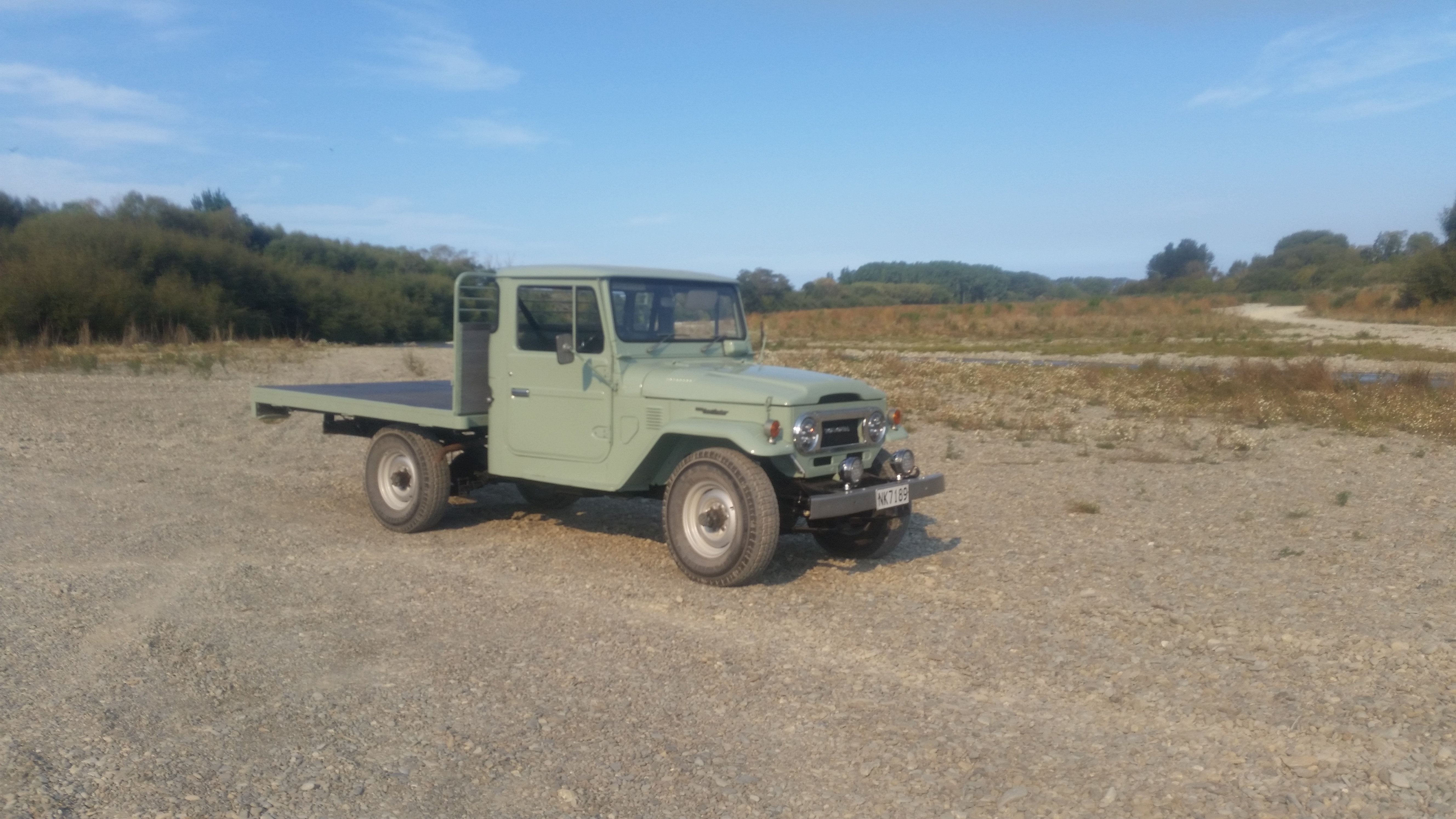

It's left the shed and is on its way to getting a wof. Just a few issues to sort out that appeared on the drive into town and it should be ready. 4wd works as its been in the river already :)

Beautiful truck, I hope mine turns out half as nice.
Just don't scratch the paint taking it offroad :lol:

It has been on the road for a few weeks now but as I've been on call I have hardly driven it :(
My shiny LED headlights and indicators did get a warrant but I have lost main beam on one headlamp already, hopefully my new ones from Caleb will be arriving soon :)
I have changed the door catches and handles for an aftermarket kit from taiwan they make the door shut so much better than the worn originals but they took a lot of "fitting" to make them work.
Still that's what you get for $100 for a pair of kits compared with $250 for each catch without the handles and pins for the B posts for genuine!
My original screen lasted for at least 30km before commiting suicide and turning into a million class cubes, I had a new laminated screen cut to replace it.
