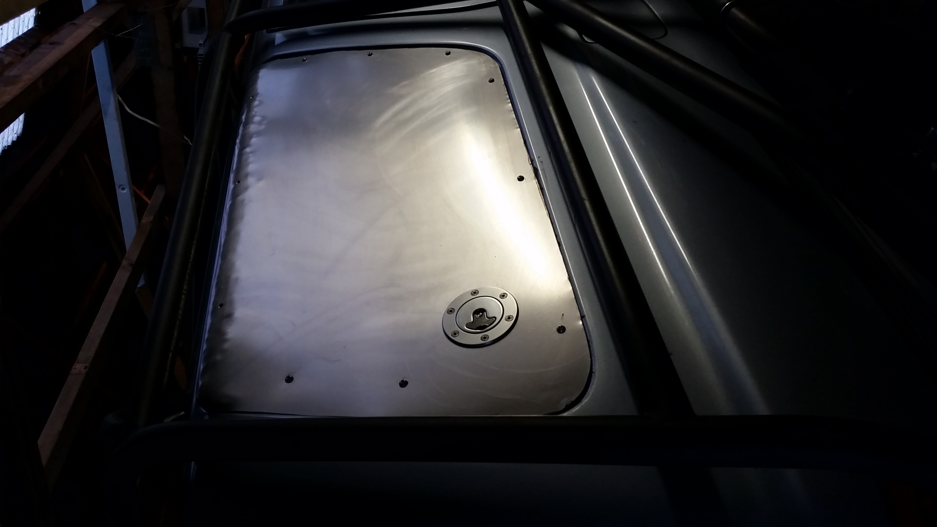

Have replaced rh window with alloy sheet for fuel filler. Thoose were the major issues anyway
