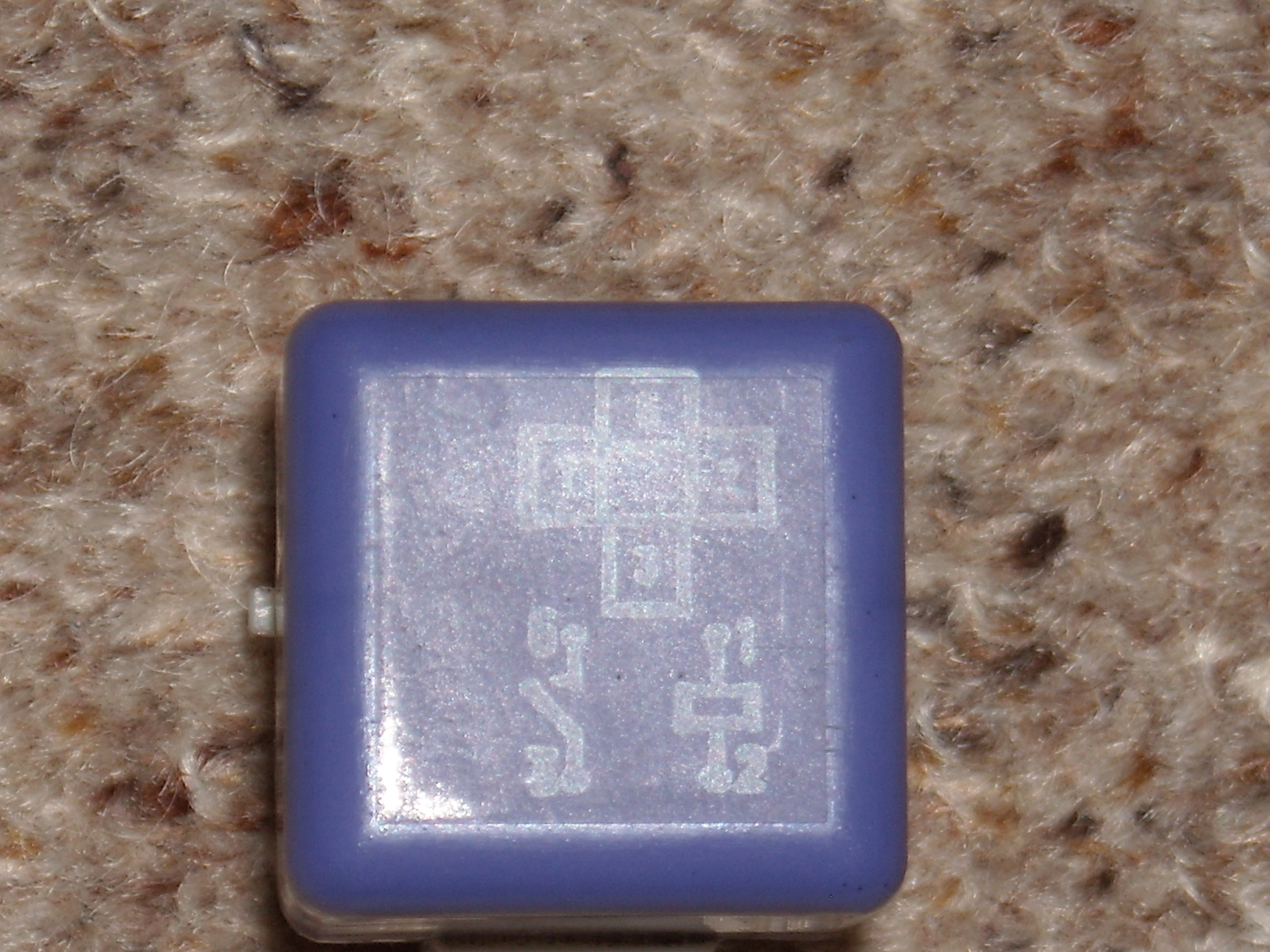

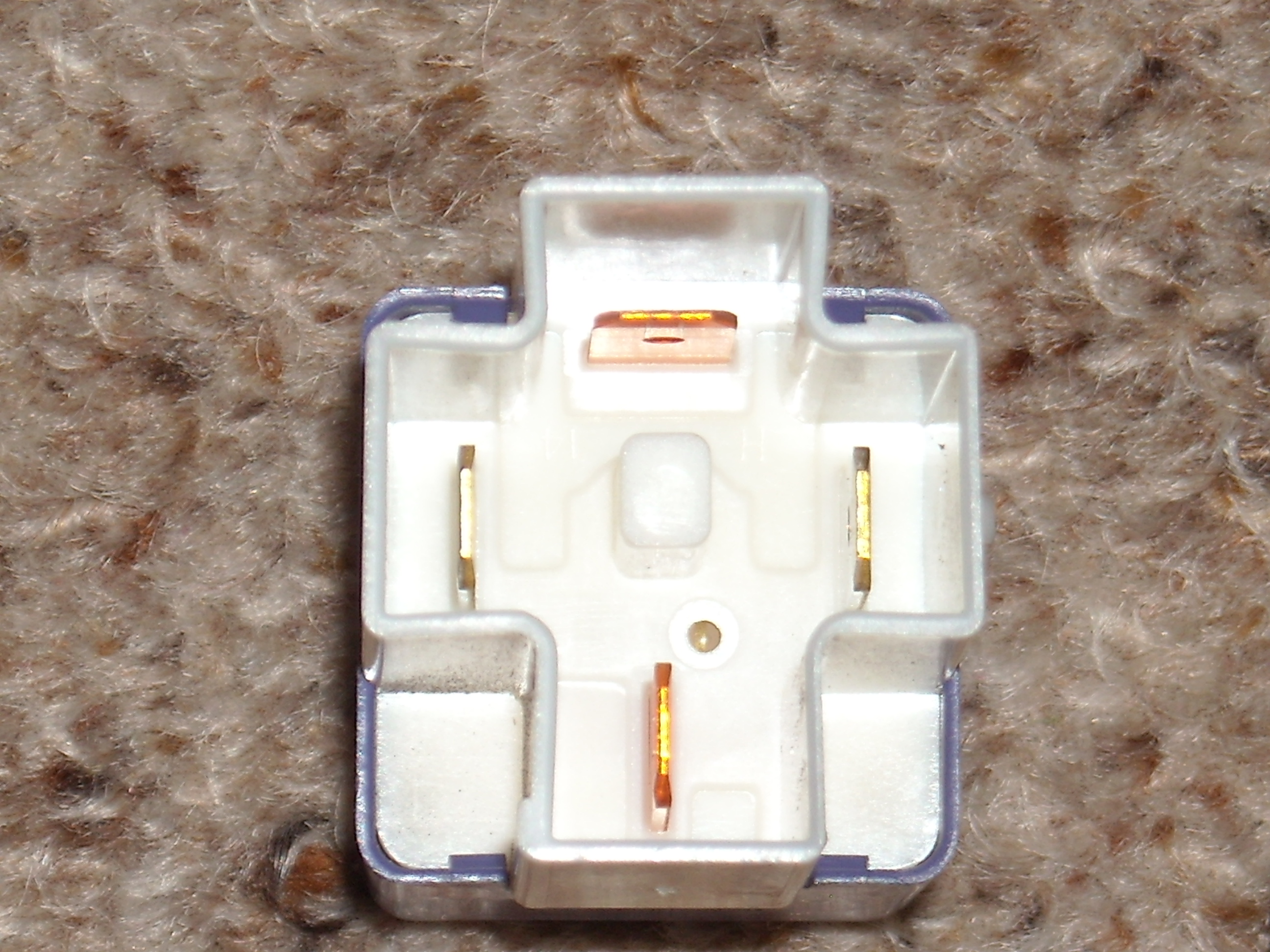

found it.ChurchurDan wrote:Im sure it is in the under bonnet relay and fuse box and is labeled start.
there is 4 the same size, 1,2,3 & 6. the picture has 1 & 2 with a box between them, 3 & 6 have a gate between them so looks like they are either joined or not.ChurchurDan wrote:bridging the 2 big terminals in this should make it wind over.
Andrew 0272226292.
Andrew 0272226292.
ChurchurDan
- Posts: 574
- Location: North Canterbury
Re: scan tool power
3 and 6 are the contacts of the relay, bridging those should make it wind over. If it doesn't check you have power to either 3 or 6 and then that the power is getting to the starter with it bridged.
The other 2 are the winding, one should be an earth and the other should come live with the key in the start position.

just joined 3 & 6 and it turned over. could hear fuel pump.

just thinking, if it turns over when you bridge those 2 pins in the starter relay, and one of the other pins has power when key is turned to start, but there is no power at the small wire on the starter when key is turned to start, could it just be the starter relay not connecting when key is turned to start?
if I bridge those 2 pins to turn it over should there be power going to the small wire on the starter while its turning over? or is that wire just connected for the key?
Andrew 0272226292.
Andrew 0272226292.
Re: scan tool power
If it turns over when you bridge the two pins then it will be fine between the relay and the starter. If it has 12 volts on either 1 or 2 when you put they key in the start position then either your relay is buggered or the 4th pin (the one left out of 1&2 that doesn't get 12volts on it when key in start) isn't earthed property.
Check resistance from that pin to battery negative. At a guess should be about 1ish ohm. If it's no good it will be really high or max out your meter.
If that's good then try another relay

couldn't get anything, but was probably doing it wrong.Petemcc wrote:Check resistance from that pin to battery negative. At a guess should be about 1ish ohm. If it's no good it will be really high or max out your meter.
tried it, the same.Petemcc wrote:If that's good then try another relay

thought I would check other things again before I unwire the supercharger computer.
the small wire onto the starter, when key is turned to start has no power. its supposed to aye? I also checked the wire where it comes out of fuse/relay box and no power there.
but when I bridge the pins 3 & 6 in the starter relay it turns over and the small wire to the starter does have power, so thinking wires to inhibitor switch, or inhibitor switch.
so do I just earth the earth wire from the starter relay that goes to the inhibitor switch? without cutting it?

Re: scan tool power
just tried again. won't even register on multimeter. key off/on/start, positive connected/disconnected doesn't make any difference.Petemcc wrote:Check resistance from that pin to battery negative. At a guess should be about 1ish ohm. If it's no good it will be really high or max out your meter.
between negative/body/chassis/engine all show up from 1-2 ohm.
earth it straight to body?Petemcc wrote: the 4th pin isn't earthed property.

Re: scan tool power
pushed a wire into pin and put relay back in, fixed wire to earth on body for negative terminal, no different.
so forked if I know.
