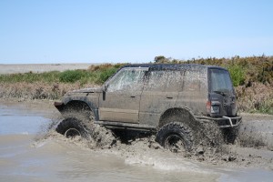

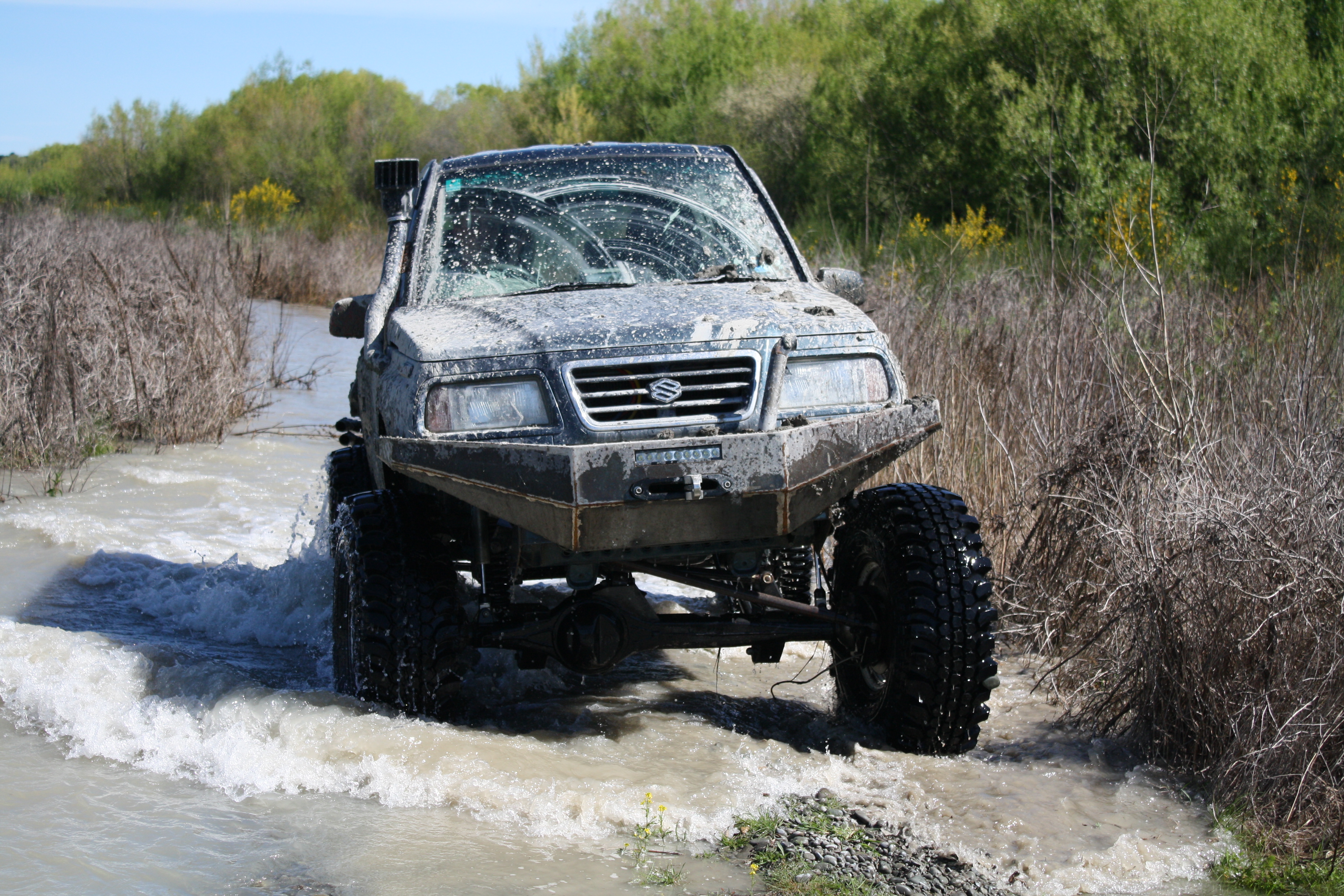

You could do what my cousin did:-
- Toyota Land Cruiser 80 series front axle w/ air locker
- Toyota Prado Rear axle w/ 2in wheel spacers and welded diff
- 36x12.5/15 Simexs
- Custom Suspension
And hes now thinking of putting 16inch coilovers in it
Just as a sagestion
Not sure on the price though
Drove it last weekend
:D:D:D:D *Best cousin ever*
