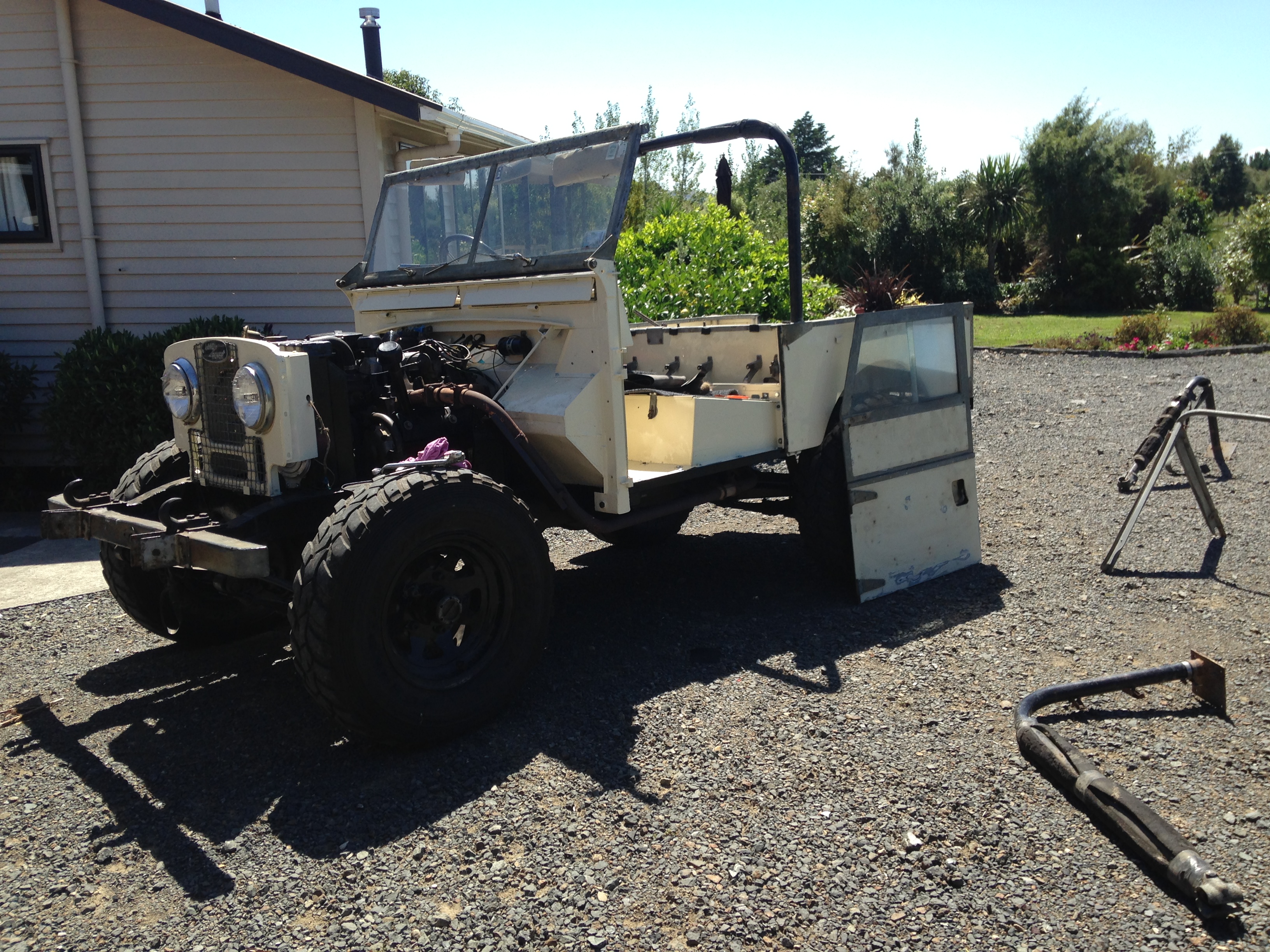

Anyways, i painted the tub this weekend
Looks ok for a back yard special
Re: Rocky Rover 1955 Series 1
Decided too have a crack at fixing the seat box. Roped Daniel in to try some alloy tig welding on it
It should do the job. Radiator panel next up
In case you were wondering

Bit of a landmark moment last night, engine back in
The tubs also just sitting there for safe keeping out of harms way
Many many more hours to spend still

The other weekend it left the garage under its own power for the first time in 4 years.
That afternoon we got carried away and started fishing parts out of the depths of the shed to refit....
We have had the restored front fenders stashed away carefully, so with the exhaust valve clearances set (side valve engine), the time to fit them was now
To finish off the guards and hide some of my repairs, we adapted some S3 alloy guard tops to fit. They make good work benches too.
Time to sort out some of the minor issues, wrecked doors, tail gate that doesn't fit the new cross member, bent bonnet etc
This is the best I can do to give the doors another chance short of making a new skin for them. Maybe I'll do that on the next rebuild
So what your looking at, is two alloy doors that are quite damaged. Once alloy is damaged it doesn't come back into shape, it stretches and gets a spring to it.
So the experiment is to make a reinforcing plate to go in behind, and urethane it in place to take the spring out of the skin. Most use rivets to hold the reinforcing plate in place until the urethane sets. You them grind the heads off the rivets and job done.
In this case you see both sides of the door skin, so rivets weren't ideal. Tried self tapping screws as an experiment and seems to have worked out ok, the screws came out tonight and the plate stayed tight to the door skin
