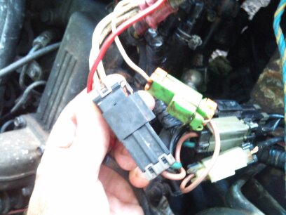

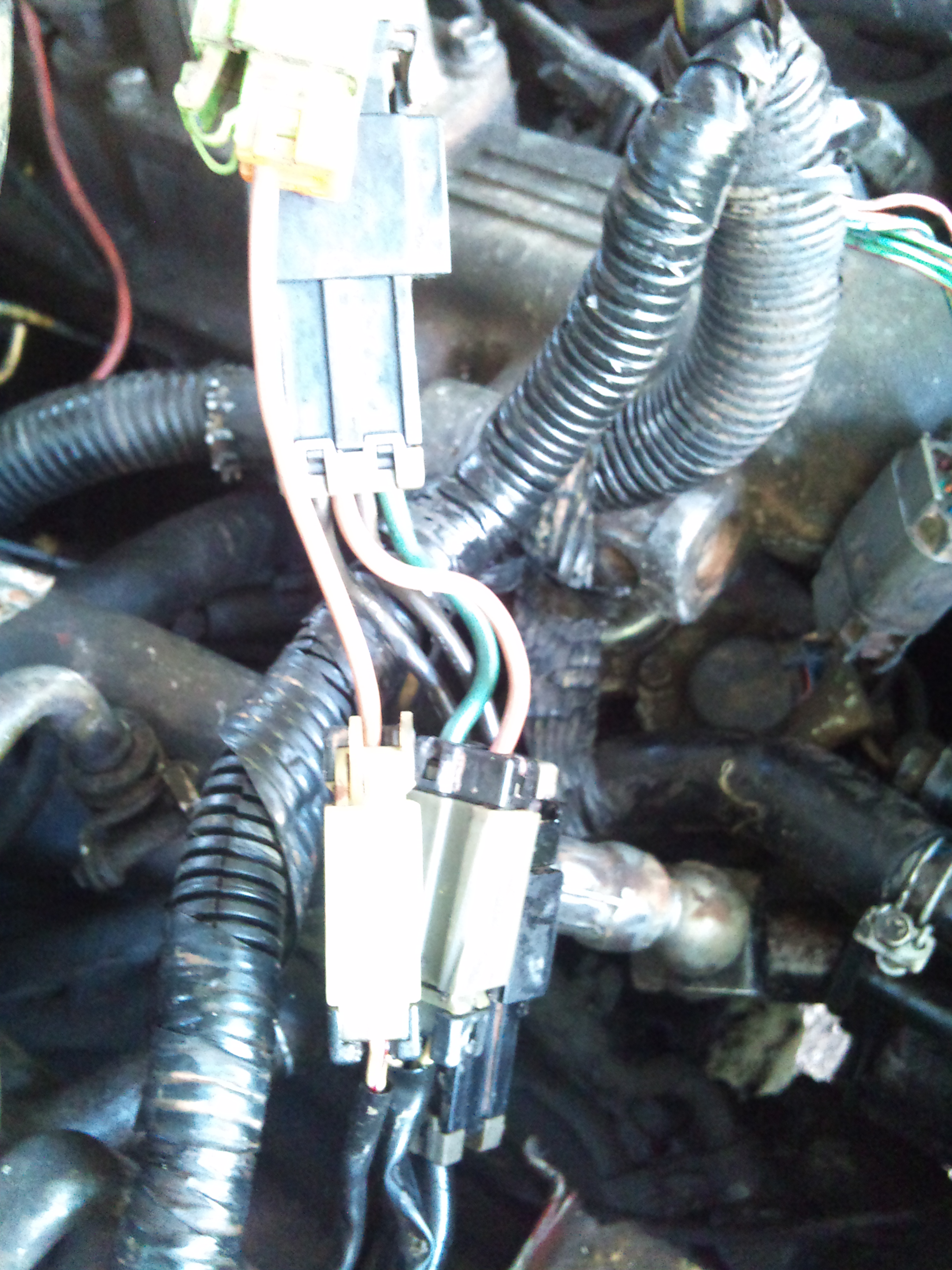

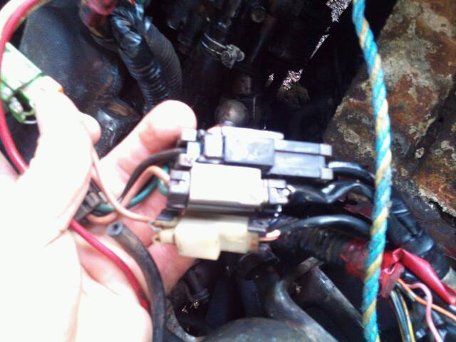

Not sure which plugs you are meaning.....these pics are all the ones running off the positive terminal. Cant see anything that I recognize as a fuse link.....?

That green & orange one, check that little bugger :D

Those short pieces of green orange and black wire are the fuse links.
