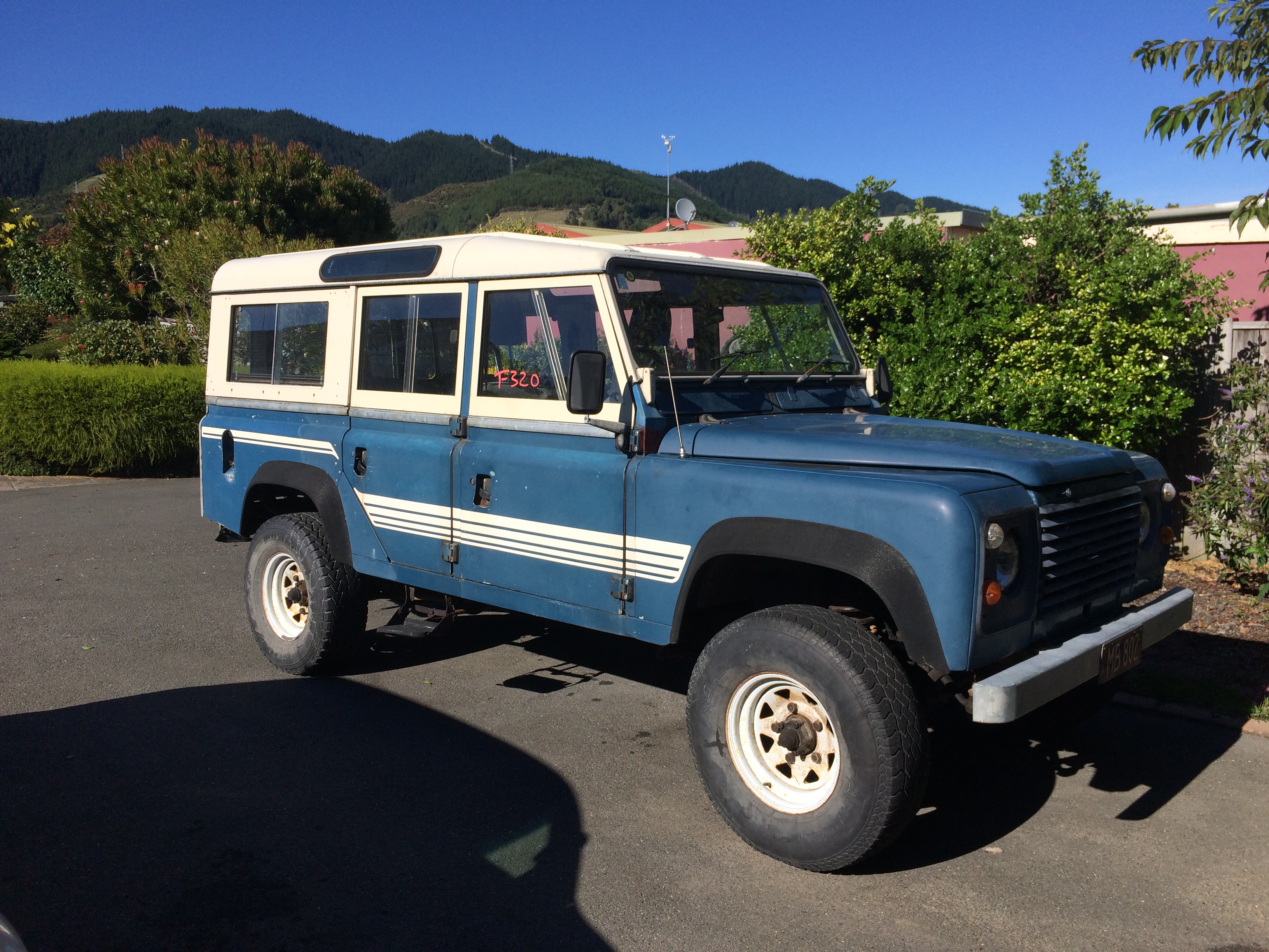

Before I shell out for a new air filter - currently the standard barrel size one at that back of the engine bay - I'm open to suggestions of better performing Air filter options.
It's a carburetted 3.5 litre Rover V8 in a 110 Defender.
