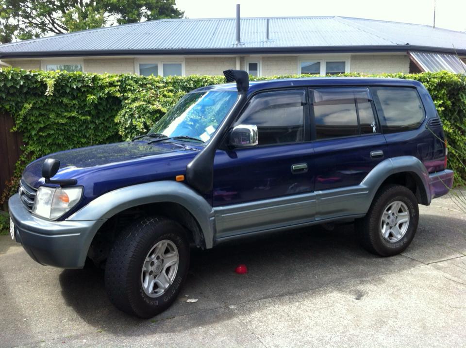

Re: Snorkel on a 1996 Prado
On a mates Prado. He got it off Trademe from a bloke in Amberley I think. Fitted it himself with no worries.
http://www.trademe.co.nz/motors/car-par ... 500131.htm
