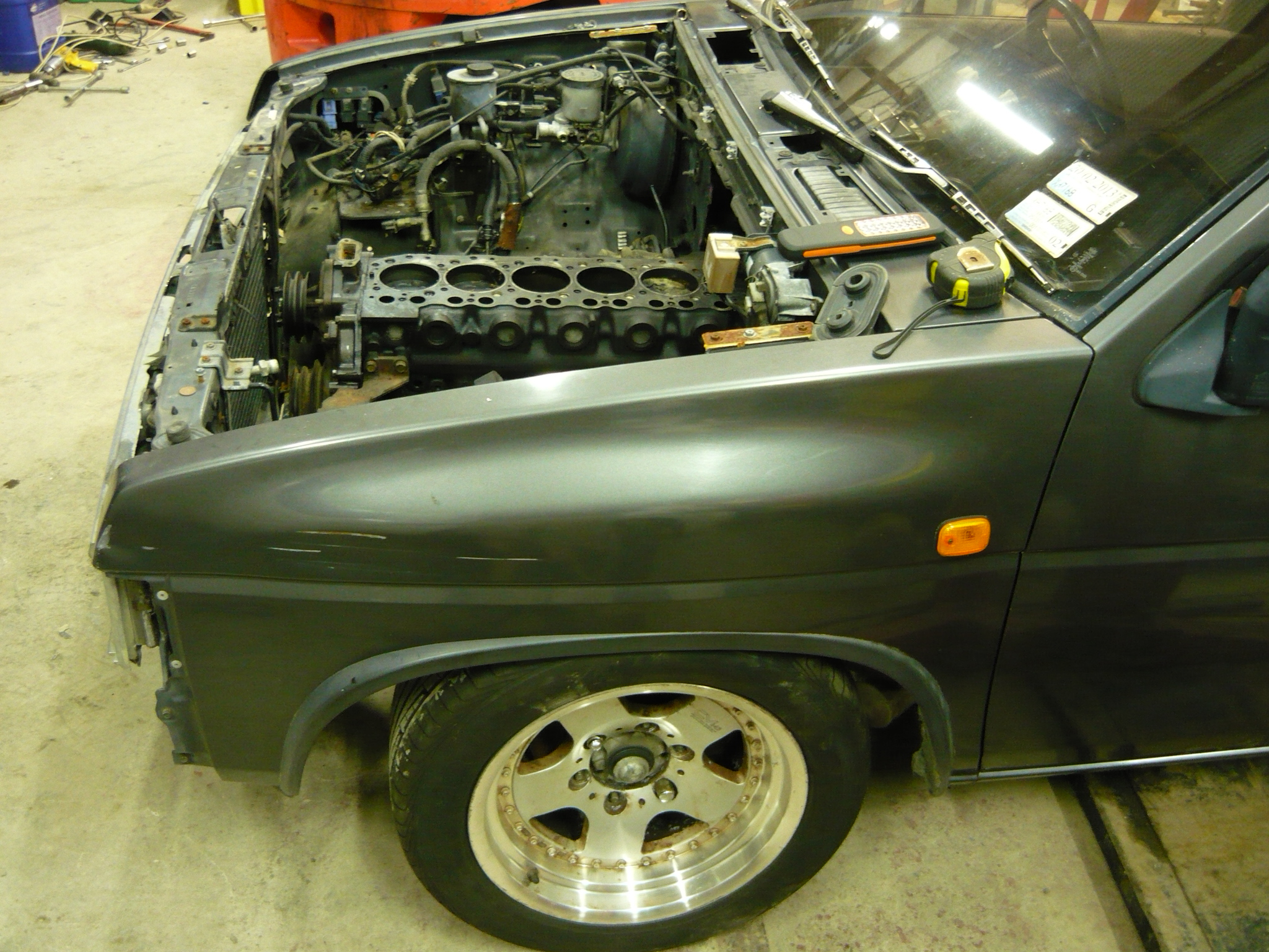

Body swap onto a ute chassis done. Dummy engine in place.
Using a RE4R03A transmission from a 300zx
Fitted bigger vented discs and callipers off a V6 Navara (same size as standard Terrano)
Going home now.
