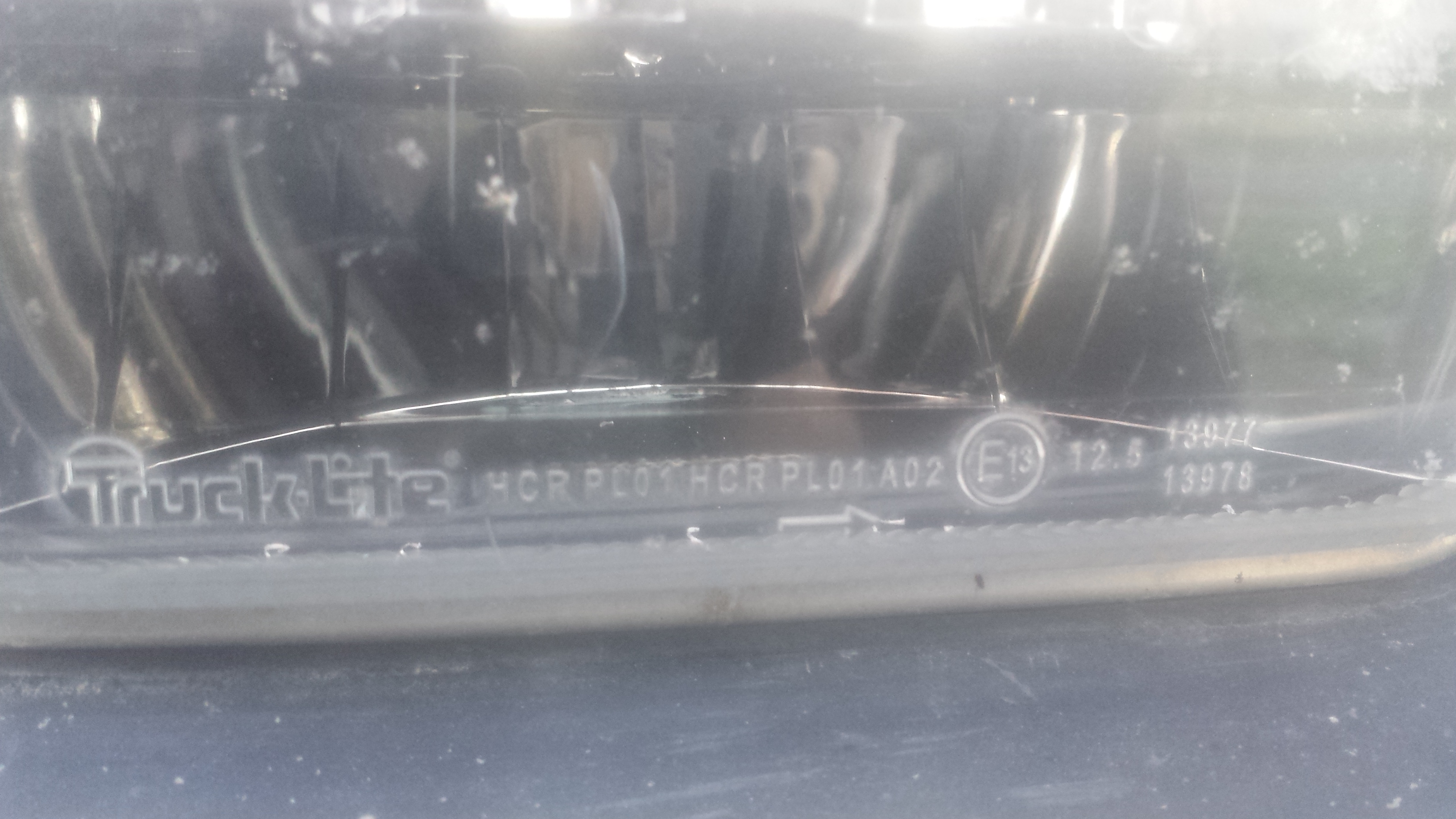

If the lights have an E mark then you will have no problems. I have a set from Caleb that I am not going to use as I preferred the chrome look but they don't have the mark. He has had them fitted for WoFs and got a pass . There are pics on his Facebook page filthy4x4.

Those speaker lights are great, but they are not cheap!
I have trucklite units in my l200 and they are nearly as good but cheaper.
The chrome ones came from scarles and have lost one of the four main beam leds but I got nowhere with warranty from them and they don't stock them anymore.

Trucklites are now rebranded and sold through Narva in Australia (and New Zealnd). Margin is a bit more because of that locally.

I paid $720 for the pair of trucklite 5x7's when they first arrived.

I know what CRI is. The fact is that halogens will probably give you the closest to natural light in driving application (90+ CRI). However, my point is that not all LED driving lights are the same. More expensive sealed ones like JW Speakers and others are purpose built with projector and LED combination. Simple LED inserts into old halogen housing will never be able to cut it properly.
Trucklites/ Narva, again are specifically designed as a lens and LED combination and work well.
