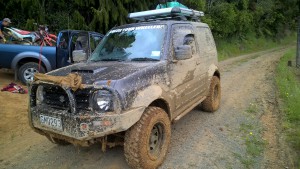

We have 3 Jimny's in our club, one of which is mine (2012) and it goes everywhere. When I do get stuck it's easy to recover as it only weighs 1100kg. They use less fuel than the bigger trucks. Of course you can't carry as much stuff, but I often have 4 people in mine (2 kids under 14 in the back). Adults can fit in the back, but would be a bit uncomfortable for an all day trip. There's plenty of room up front. Sure the engine is small, but it's light and driven correctly it will do pretty much everything you ask of it. Ground clearance can be an issue, I run 215/75 R15's (standard is 205/70 R15). 235's can be fitted with a lift, but gearing becomes an issue then. There are reduction kits available if you want to go that way. Been a narrow truck however there are often alternate lines which can be taken.
It's true there isn't many aftermarket parts available in NZ, but parts can easily be imported. I've sourced most of my gear from the UK (http://www.jimnybits.co.uk). There are Aussie suppliers, but I've found it's actually cheaper from the UK! I've made my own sliders & front & rear recovery points. (The factory recovery points are weak!)
Auszookers is a good place to get a lot of advice or there is a Facebook site, "Suzuki Jimny Owners of Australia".
Video from one of our club trips: https://www.youtube.com/watch?v=LVmqjHARhQg
