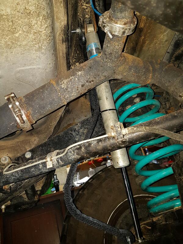

Things havebeen a bit slow since the last outing... had rim repaired with a new centre fitted...only got a shitty rattle can black this time round.

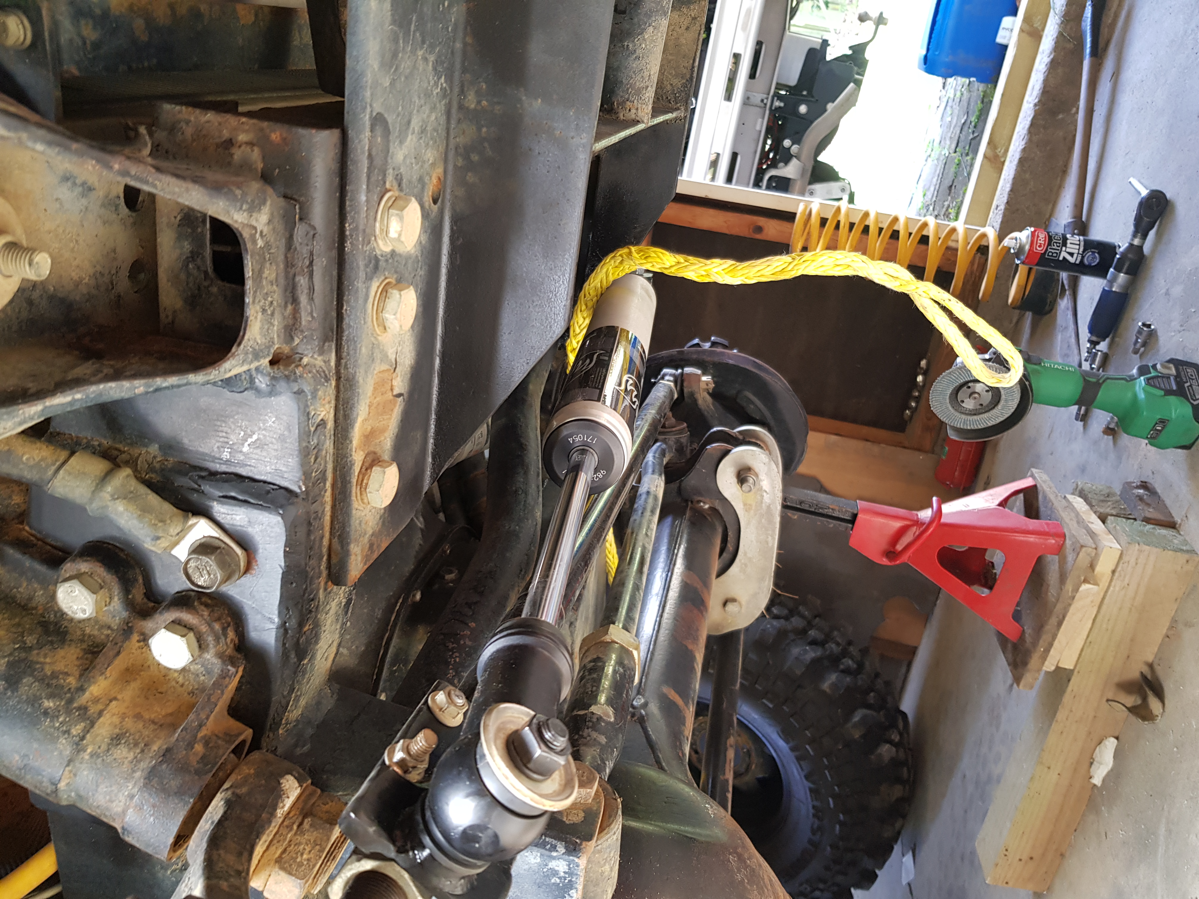

Fitted a efs panhard from force 4.
Noticed a couple things i needed to do. Fitted a set of winch horns. Orederd and fitted a set of limit strap front and rear as suspension outflexed shocks and didnt want to cause premature stress to them. Also wired up trailer plug and reverse lights onto rear frame.

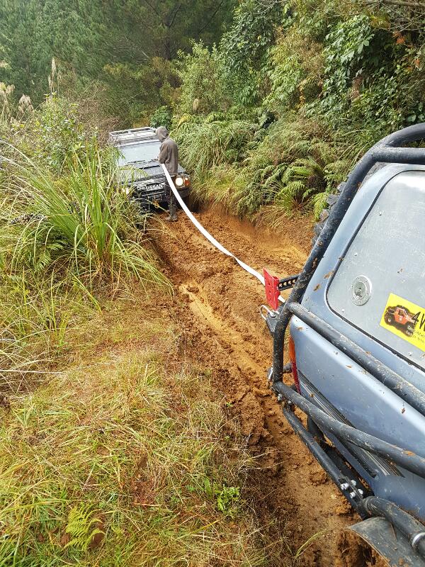

Went into ngaroma on sunday .certainly underestimated the 26km from the road into the camp..would possibly recommend uploading at the gate if your trailering?
Had a couple small issues we had to sort but my truck perfomed mint this time. Will try uplaod a video, no sound cause i didn't realize the case muffled the microphone so much

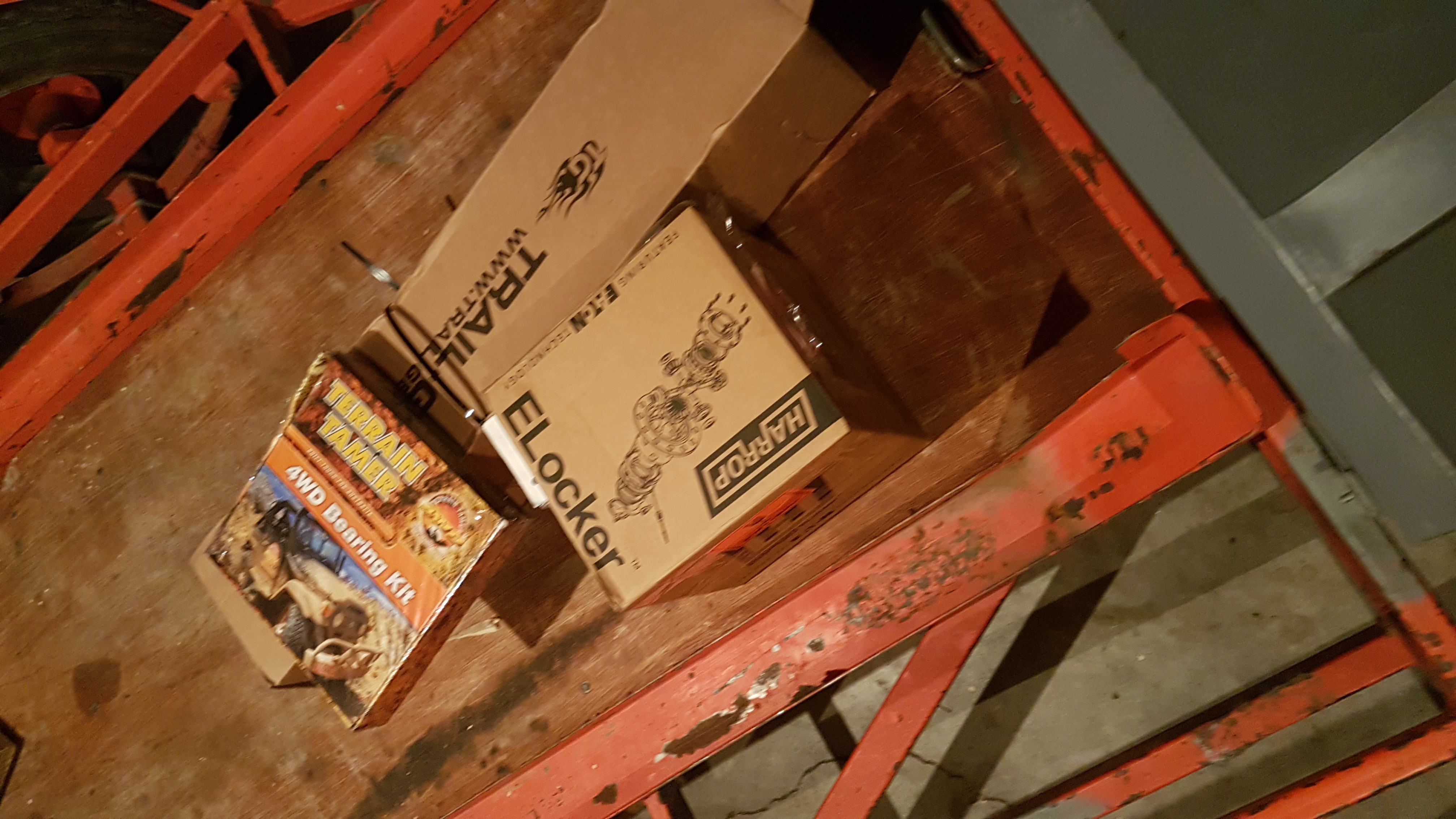

Well a couple things happened...brought some goodies for front diff

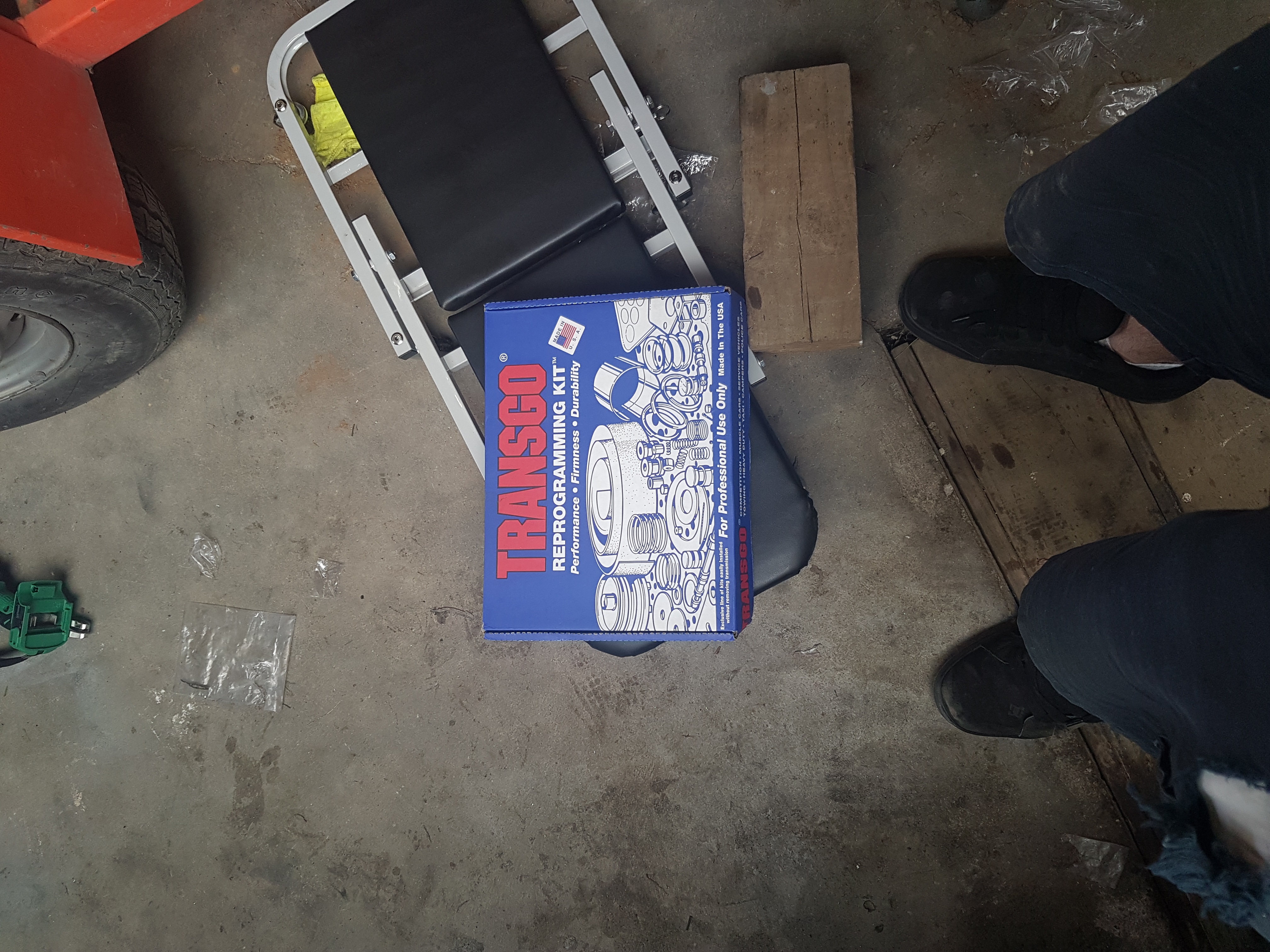

Turns out its been a while for a update... got front locker fitted. Went out for a trip to ngaroma and the hydraulic fan lunched itself.. Manga fed to track down replacement parts and fitted them. Did cambelt and water pump while was apart.Turns out they run a oil cooler factory that I hadn't known about.
Seems to have done the trick..haven't had a chance to take it out again but finally fitted the shift kit into the trans today. Definitely made a noticeable improvement. Used to be quite sluggish and would slip a lot engaging the next gear.now it's a lot more positive . hopefully prolong trans life a bit... no pictures cause too much atf everywhere.

It's can look up the parts number, it firmed up the shifts which I wanted,although it makes a few funny noises on initial start up,yet drives fine.Big wrote:what setup did you use in ya trans..? as I got the same one and have been playing around with it through the lexus box but now have the prado box and looking at it again..to make it a nicer shift.. you need a bigger paddock too so you can let the horses out ..![]()
The kit didn't match up exactly tho,and it says one of the valves didn't fit. Only set it for truck rather than hotrod.

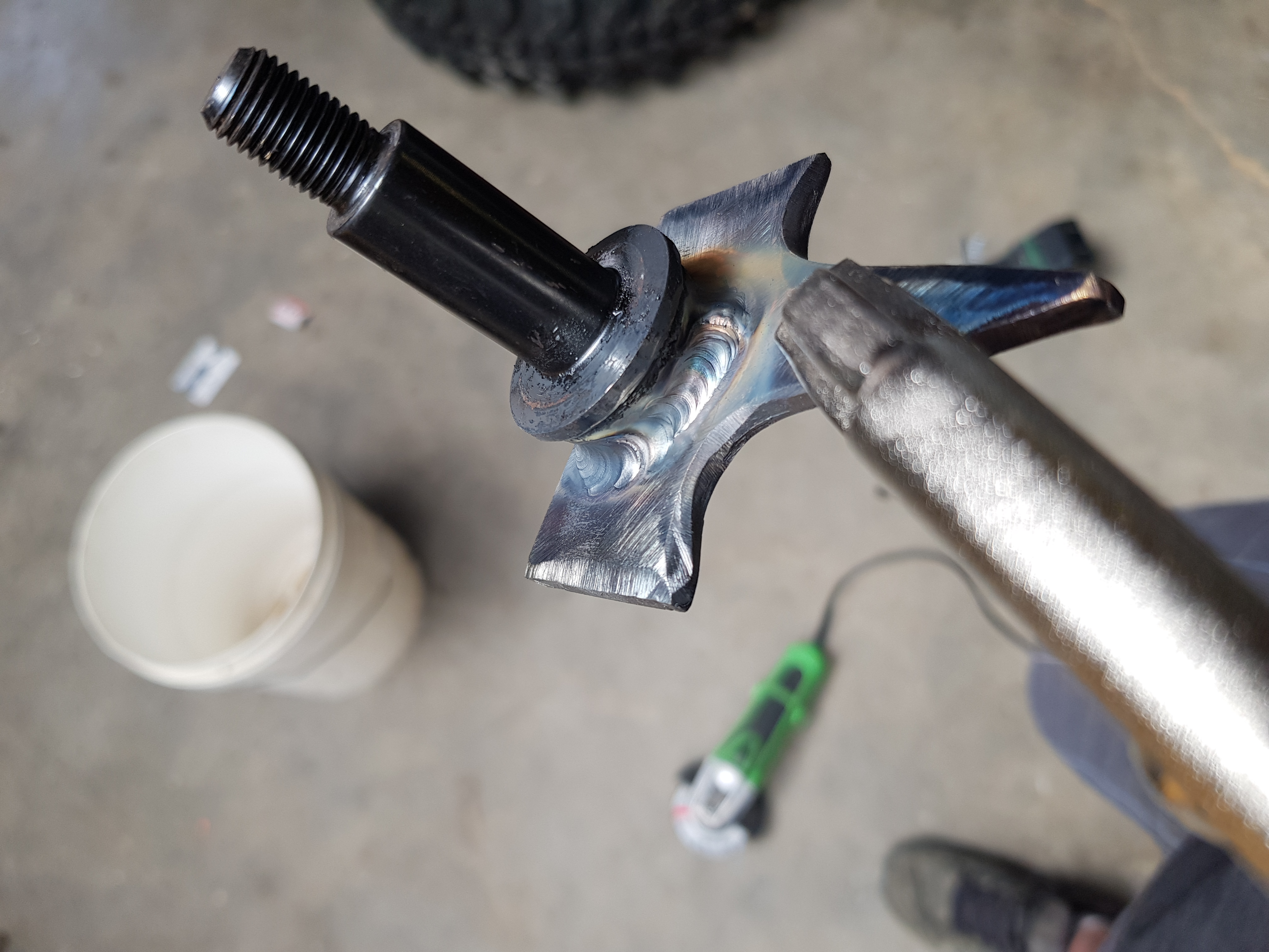

Well haven't had it out anywhere as much I would have liked, time and money have slowed me up quite a lot...haha but using it as a tractor around the house to try pull out stumps and roots etc, managed to bend my tow bar... (spouse I did have winch doubled back attached to a tree infront....) so used a chain and a bottle jack straighten it out and added a couple braces.
Had it at up woodhil previous to this for the nzoffroader open day thing, went good apart from not knowing where we where going.
Going to look at making a rear sway bar from a torsion bar, to help improve roll stability. And hopefully make the front work better

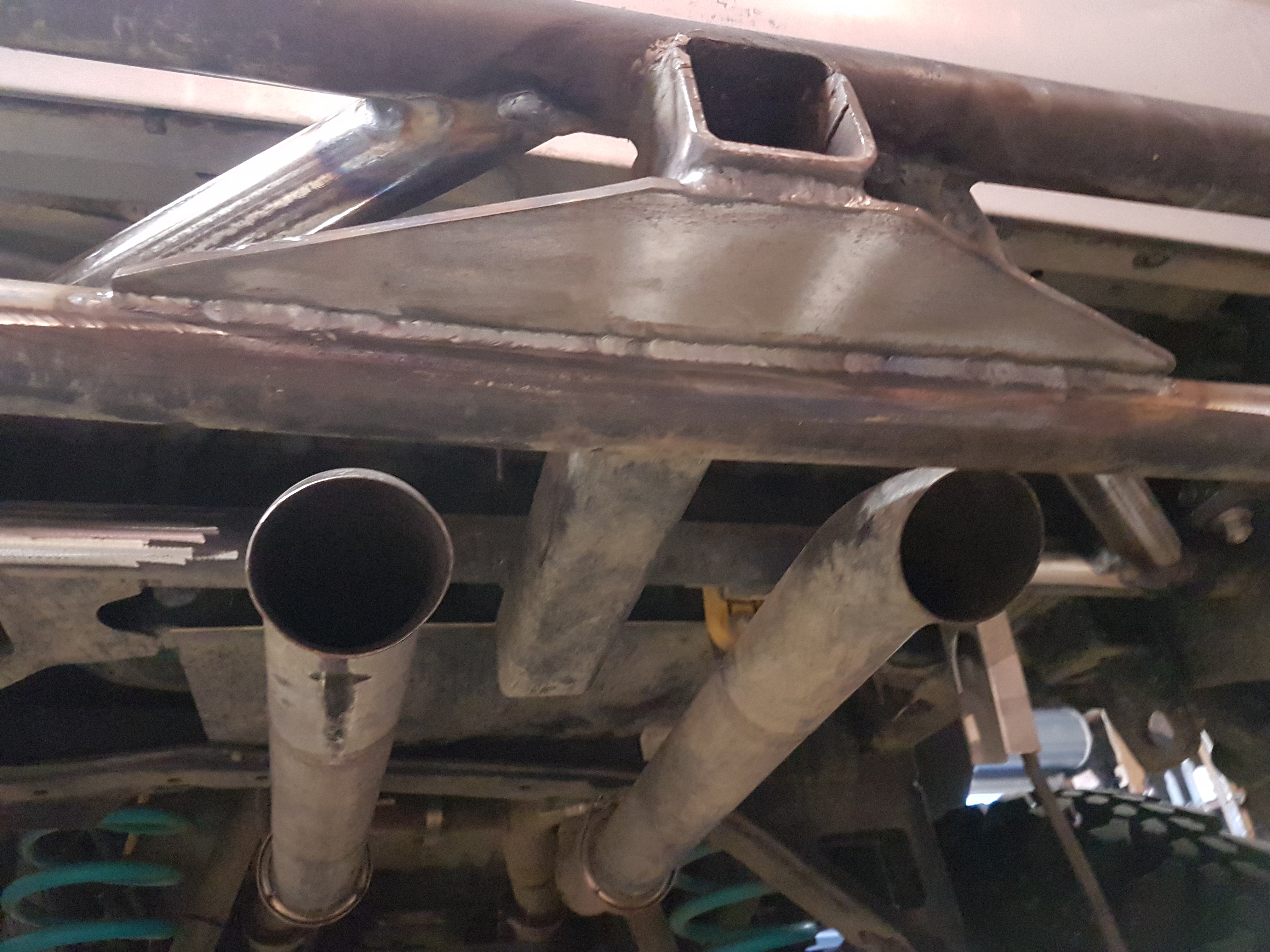

Brought it out of the shed once since my last post, got a wof and back in the shed....
But have roughed up a sway bar haven't driven with it but grabbing the cage and rocking it makes a huge difference.
Just waiting on some misalignment spacers, to give the heims some more movement then slap some paint around.

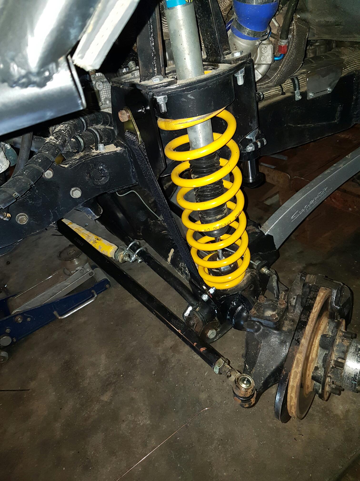

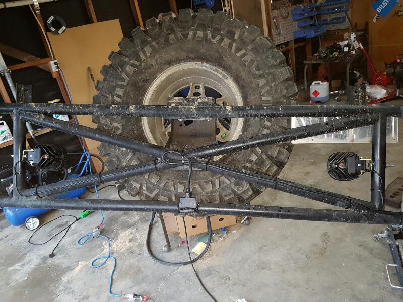

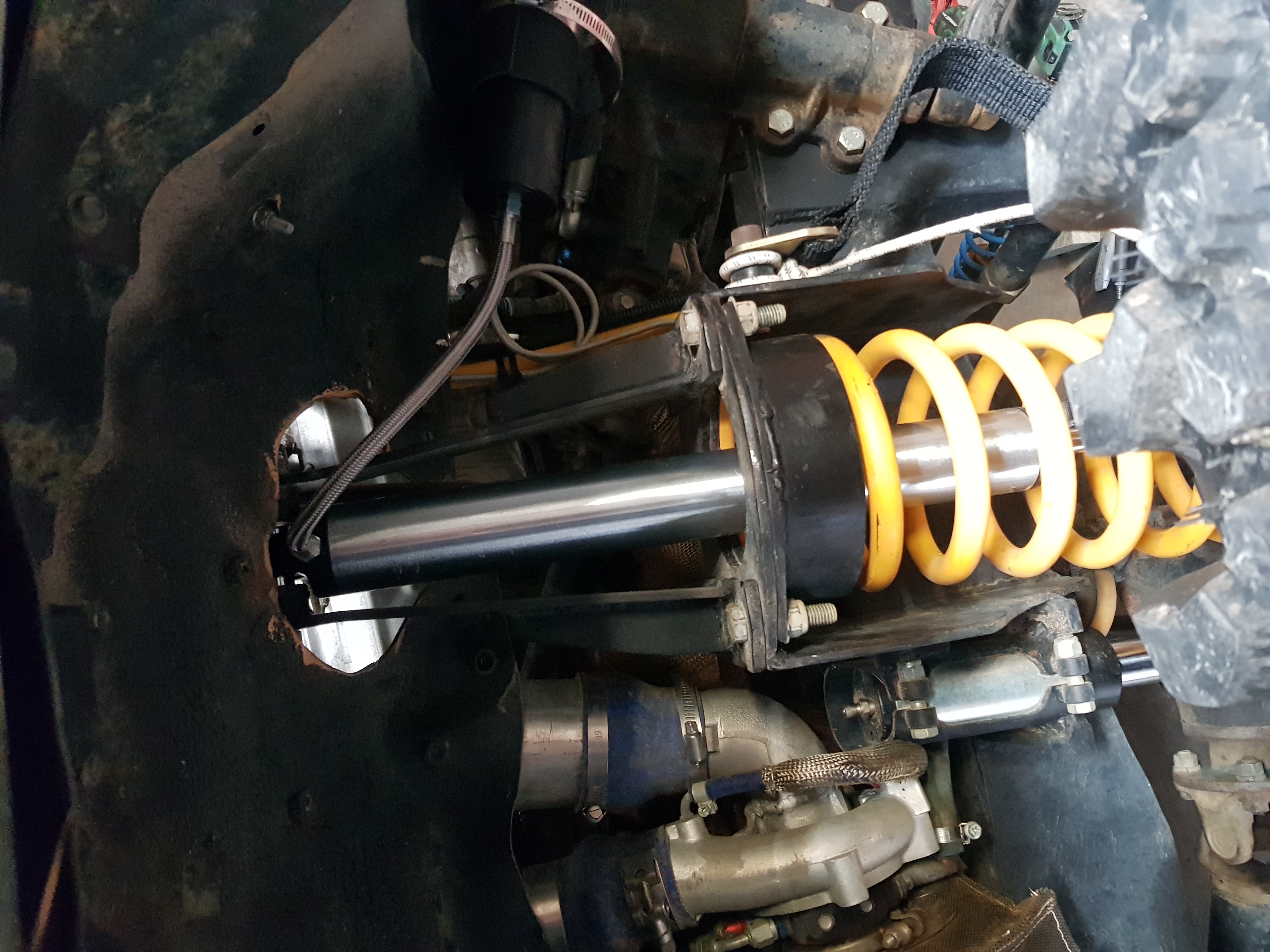

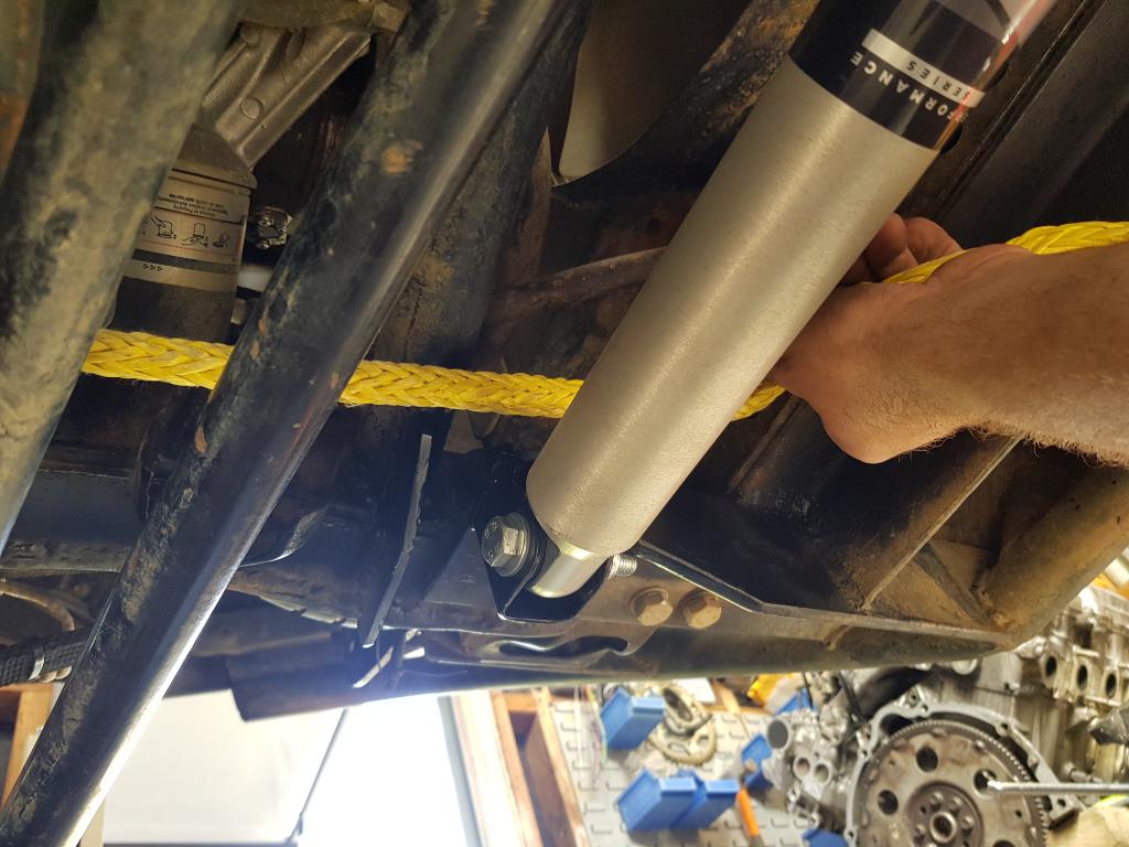

wow over a year since my last post, truck hasnt seen much action but recent trip to America caused some money to be spent... fitted them up over the weekend. haven't taken it for a skid yet..
rope hanging out is ensuring I've left room for my future( once wallet recovers...) plans for a rear mount winch
think I like modifying it just as much as driving it....

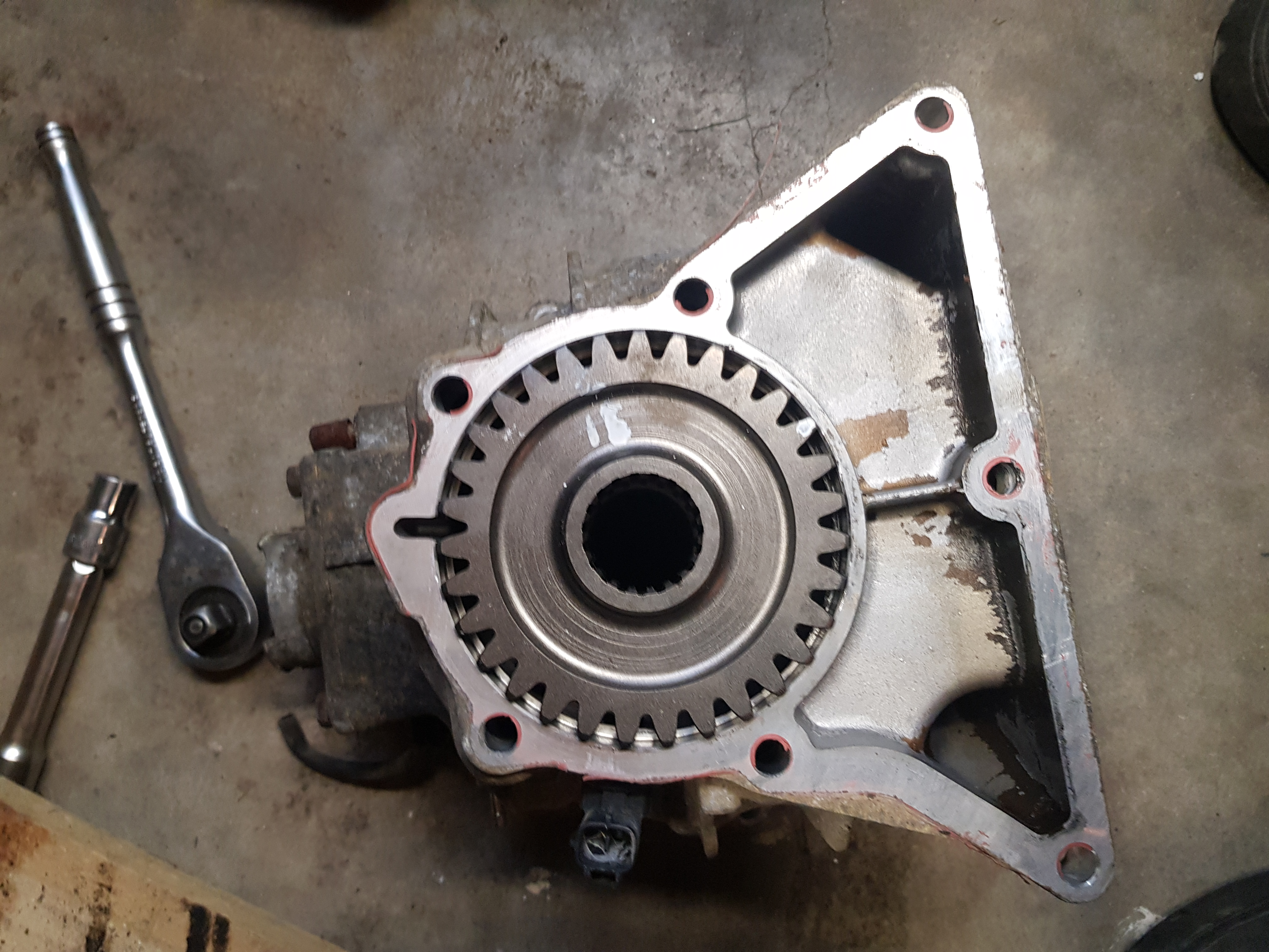

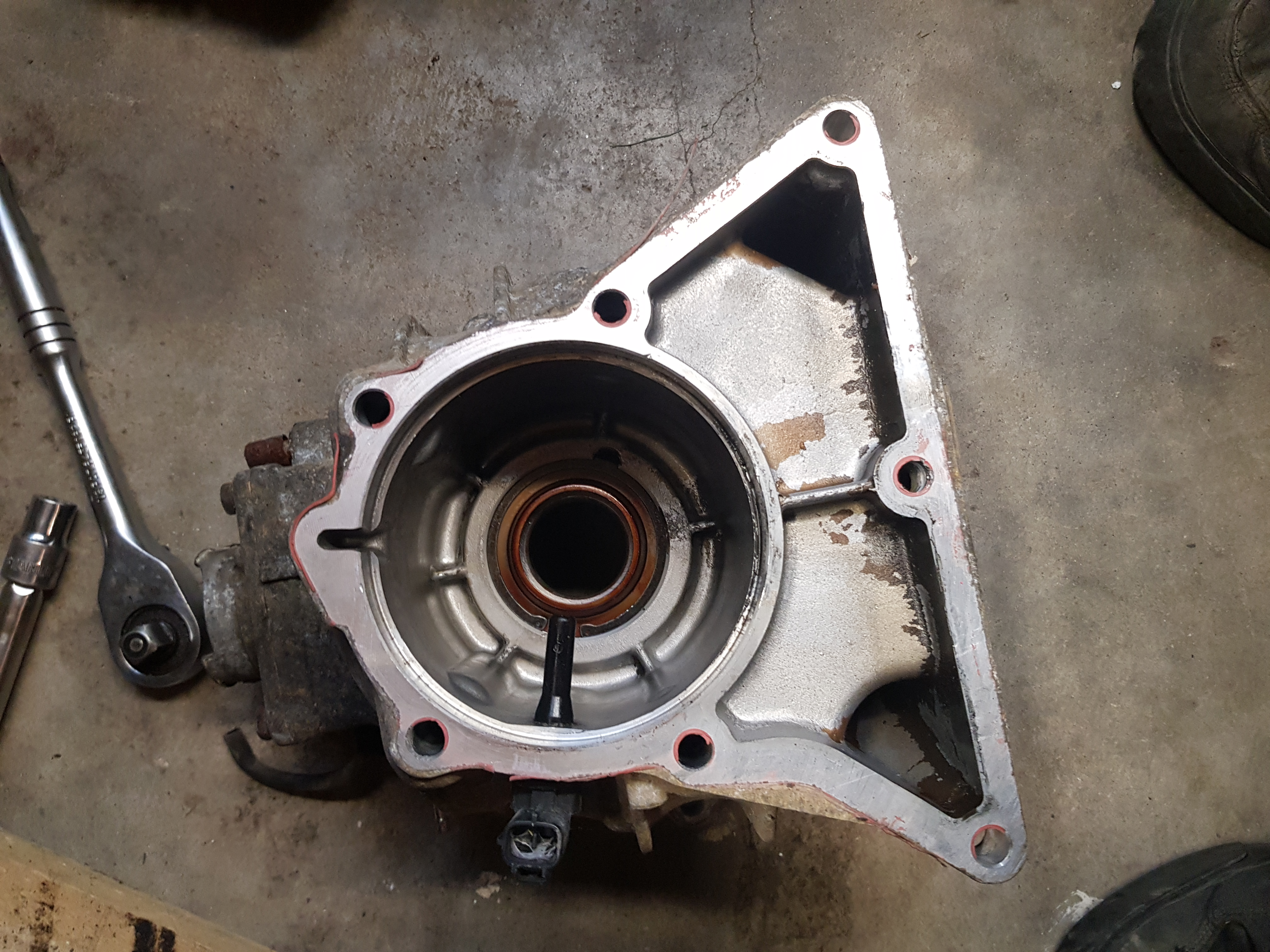

I thought I'd start investigating into my plan of fitting a pto to my trans, and started to split the parts transmission I've had sitting on the floor for at least a year- this is where it went down hill... my memory had told me the intermediate housing between the trans and transfer case was one big hollow item.
This isnt the case and theres a bearing and seal and.... well the pto gear doenst even fit in there. this plan is out the window. I wont give up yet and have two options that seem do able, one is a prado transfer set up, but I need to measure up the lengths and see how short the front driveshaft will be, and deal with offset rear driveshaft, probably not too much of a issue as this does very little road kms(very little kms at all actually)
or option two I found on YouTube a vague video of someone modified a hilux gear drive transfer to take a land cruiser pto drive.
will look at option one for now
