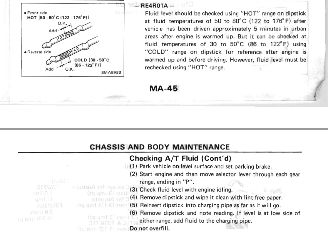

Whats the "correct" way to check auto trans fluid in an old 95 Mistral auto? Have drained and refilled mine twice but would like to know it has enough...or if I've overfilled it.....
Hot then idle in park, or neutral..or cold?

From FSM
Re: Correct way to check trans fluid
Thanks for that info, is it idling in neutral or shut off and checked immediately? Thanks
