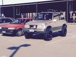

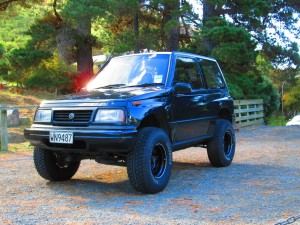

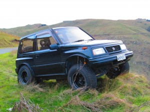

I found the gearing alright. They aren't fast anyway so it didn't bother me but it affected it a little. I also had an Escudo with a 3 inch suspension lift with 15x8 -19 rims and 30's. I preferred this set up mainly because I dislike body lifts.
Here are some photos of the 2 inch body lift and 2.5 inch suspension setup.

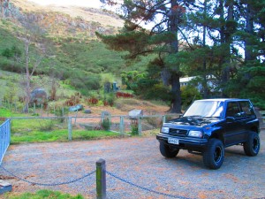

And this is my 3 inch suspension lift setup.

Both of those are sweet, making me reconsider the search for a LWB model

Like the stance on those to above
well done both of you
