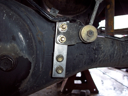

do you have a pic of your bracket handy?

no wasn't really into recording everything then, been a few years since I've played with 130s.
just use a piece of flat steel 30mm roughly wide or whatever you have lying around. about 100mm long or so, enough to lift the holes up 50mm.
drill 2 holes in steel to bolt onto bracket on diff, then measure 2 holes 50mm above for the valve to attach to. \
like this.
