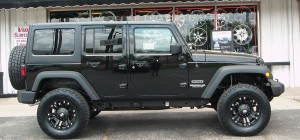

silveradoman wrote:hi how do you tell the models apart from a glance?
The model/version is usually displayed on the side.
See picture attached as illustration

Rubicon has different Rubicon only rims and a hood sticker to easily identify from the outside from a distance.
It's a bit of a personal preference between them visually, Rubicons don't have body match painted fenders and hardtop. I prefer that. To me painted fender and top looks unnatural.
