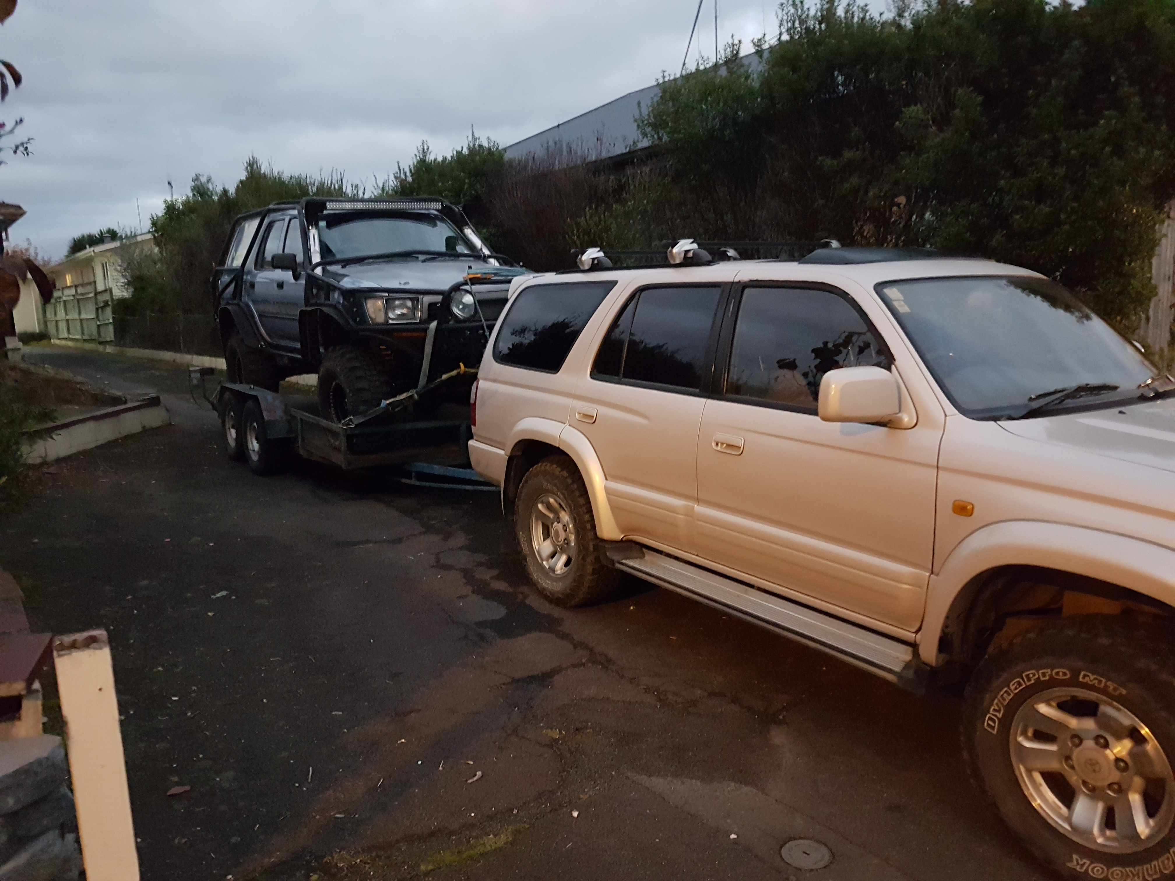

So my shiny/tow vehicle is a kzn185 manual owned it for about 5 years.been meaning to Intercool and exhaust on it for a few years.but now that I like to load it up and tow my other pig I have more motivation before I pop a head.haha

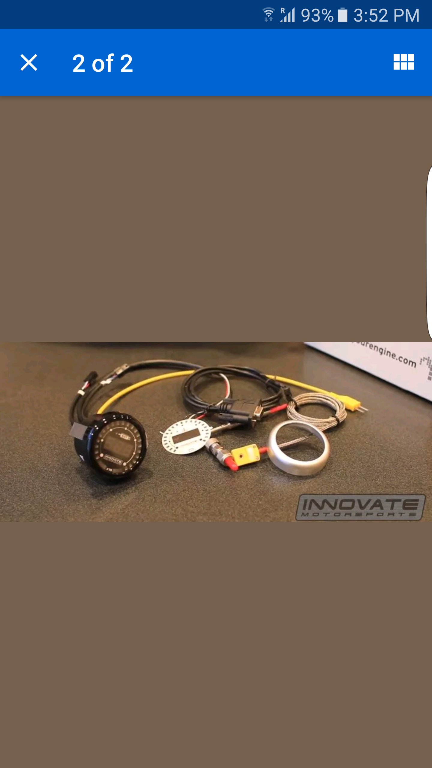

First step is I've ordered some gauges that I'm going to fit to see what the standard readings are and see how the changes effect them.
Have a boost gauge I'm replacing with
Which is boost controller and afr gauge (mainly just wanted elec boost control)
And a egt
Will fit and get a baseline.

(Just saw I ballesd the pictures up,egt right at bottom)

how does the 185 get on towing something (surf and trailer) heavier than itself? crawling up hills or not too bad? does the weight push it around on corners?

mudsurfv6 wrote:how does the 185 get on towing something (surf and trailer) heavier than itself? crawling up hills or not too bad? does the weight push it around on corners?
sorry no help with your questions.
It's not horrible,but far from perfect. It does struggle so bit on hills but even on the flat I kind of stay bellow 70odd kmh. Have had a scary moment coming down the Kaimais where it tried to pass me but didn't have enough weight forward on the trailer/trailer got a puncture and started swaying big time
Ideal world I'd have something bigger to tow with but budget says no!

Looking on the website, that gauge measures your air/fuel ratio not your exhaust temps.......can this be done on a diesel? I often hear exhaust temps are a good indicator for a diesel.
EDIT: I see you have 2 gauges and I got confused over the dual gauge functions of the first one - ignore me :oops:

jonboy80 wrote:Looking on the website, that gauge measures your air/fuel ratio not your exhaust temps.......can this be done on a diesel? I often hear exhaust temps are a good indicator for a diesel.
Haha no worries mate,I wrote a response but never hit the submit button..probably didn't help I put the wrong picture in the original post either

Have finally fitted the gauges,and had to program egt to celcuis. Haven't gone for a good drive yet tho
This will give me my baseline standard settings,mainly just for my curiosity and see how each Mod changes the egt
