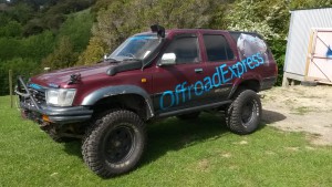

It's been two years since I've got back from the islands so I thought it's about time I got the surf out of the shed and road legal.
Rear disc conversion is almost done.
Just finished modifying rear bar for receiver hitch plus two extras which allow for motorbike frame and recovery points. Strengthened for towing trailer with landy on it.
Next steps. De rust front. Pull off front bar and paint. Replace flares, Take for cert. Build draws and bed in back :)

So the surf is now certed, wof'ed and rego'ed. Got a last minute wheel alignment from upper hutt tyres (cheers skid) and then gave it a 2000km test drive to the Bay of Islands and back.
One little issue with the front hubs where the CV goes through rattling away. Fixed by finally getting some free wheeling hubs in whilst in rotorua. That commercial and 4x4 wrecker there is awesome!
The torque converter lockup mod I wired in the day before leaving was magic. I pretty much drive it like a manual now. Just need the intercooler on it to give it that slight edge on hills.
Should be out on trips a lot more now :mrgreen:

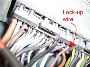

link to thread. http://toyotasurf.asn.au/forum/viewtopi ... lock#96174
then scroll down to grant-man post on Thu Apr 19, 2007 1:56 pm
which has 6 pics but basically you just cut this wire and insert a push button toggle switch which is capable of on|on so it toggles between a common(wire to lock up solenoid) and two power feeds. Feed 1 being the ecu which is normal mode and feed 2 being 12 volt supplied from somewhere like your radio or something.
Mine is a 94 and it was the same as this pic for the wire to cut.
I got the push button switch from jaycar, nice little unit with lots of pins so you can wire up some power and the light will come on.
Should have done this mod years ago. Was way to easy and worked straight away.
