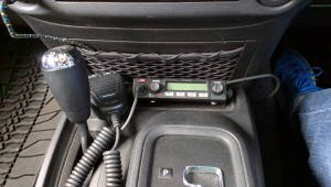

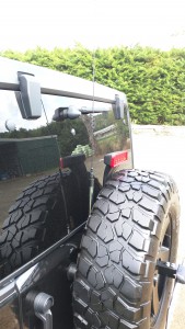

GME radio and antenna

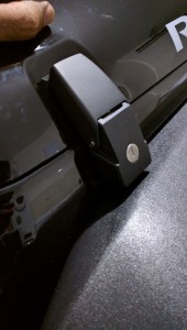

Put Rampage locking hood latches

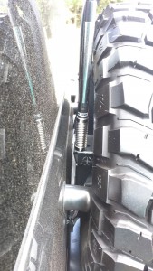

Installed Mopar hood lift struts. Easy install with no drilling.

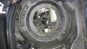

Changed the headlights to JW Speaker 8700 Evolution J LEDs. These are full replacement and ECE and ADR approved for LHT use (i.e. RHD vehicles). Had been looking for them for sometime but the price had always been too much for me.

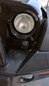

Out came the old headlights:

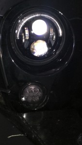

In went the new ones:

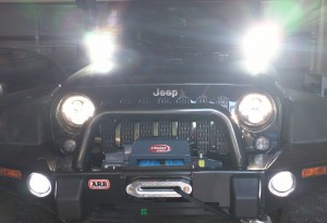

Headlights, windshield lights and fog lights all on for a quick check:
There is a chrome ring around the lamps to keep them in place, I painted it black as well. I have not driven at night yet to see how much the difference is yet.

Took it for a spin last night, and light is amazing. But lights need both vertical and horizontal adjustment. It was not focused properly in front of me driving.
Also discovered that now the passenger side vertical light leveling motor is not working. Driver side motor works. I will take everything apart again and see what is going on. It was working before I changed the lights.

Got the motor working again, one of the wires had come off. Oh well.
Aligned the lights best I could do, and it's day and night in terms of visibility over factory halogens. Nobody flashed me coming the other way on test run, so beam must be aligned correctly.

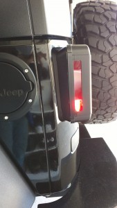

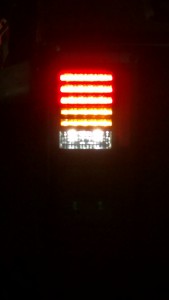

Well, I like things that match. So:
Got JW Speaker tail lights as well.

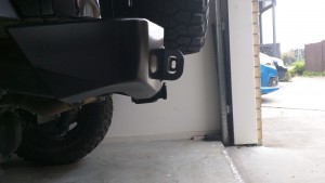

Bit of an update, long weekend was very helpful. Installed a tow hitch. It sit just level with the muffler/exhaust and does not stick out in the back to cause hindrance.
Tongue is removable, I was just looking at how it fitted together. I have the factory wiring loom, which I will install later in the week.
