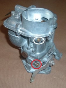

The Solex carb needs a bit of a once over, never pulled a carb apart :D

those carbs are simple as. clean it up and it'll be sweet.
rimmers or somewhere similar probably do a kit for pretty damn cheap. I imagine yours will just have a stuck float and a haggard top gasket. my citroen was similar. washed it with brake cleaner, knocked a new top gasket up out of a weetbix box to get it going and never bothered to come back to it haha

Is the top circle (white) the mixture and the bottom one the idle?
Cameron
Posts: 733
Re: Grandad's Series 2
Post by Cameron »
nah the white one will have a jet or somethign behind it.
red circle is idle mixture
green circle is idle speed.

The Solex carb was actually buggered. The emulsion tube was broken and not repairable, I guess the engine swallowed the top piece of the carb :shock: .
