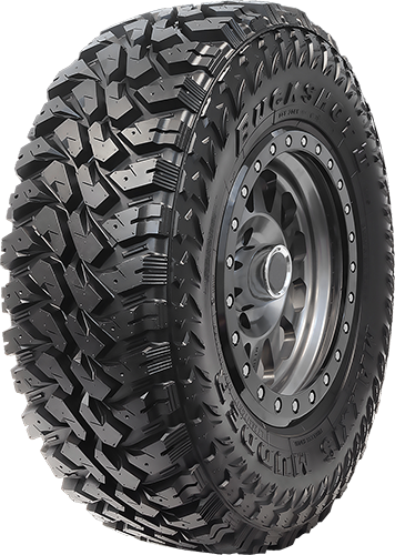

Little bit of an update.
I have decided not to go with the Silverstones after all. Been reading through some tyre threads on here and have heard they wear really fast; but Simexs have really good wear (Unfortunately they are out of my financial reach........). I would also have to have an on-road set of tyre because with such an aggressive tread I can only imagine the wear no matter the brand.
So I have decided to go with a less aggressive MT. Something like the Maxxis Bighorn MT762 or MT764. On other websites 97% of people running the 762 have been really happy and some have gone onto their third set of 762s.
I like the more aggressive nature of the 764, but have read on here that they wear faster than the 762. Why might this be? Surely they can't been too much different in design apart from tread pattern. I have a friend who's dad is a Maxxis dealer here in Dunedin so getting either of them wouldn't be a problem.

you have just answered your own question. more aggressive = more void less rubber = less rubber on road.Tumor wrote:I like the more aggressive nature of the 764, but have read on here that they wear faster than the 762. Why might this be?
unless the construction is different, both same ply though.
I have had 764s and would buy again.

764s it is!

Big question is, what size????Tumor wrote:764s it is!

31x10.5R15 I decided....................
