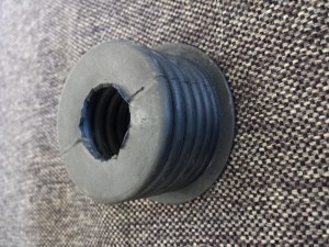

Re: 70 / 60 series transfercase mods
I have a butchered shaft bellows one you can have pm your details and I will post it to you.
