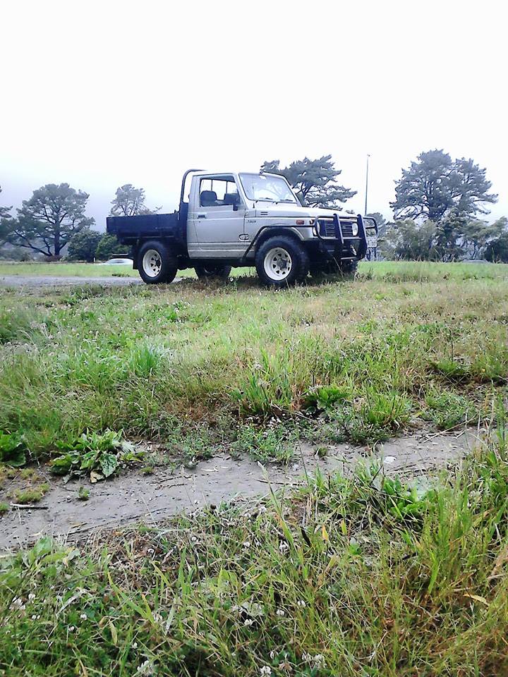

so now has a wof ! and 30 inch tyres ! on 15x7 rims ! looks pretty good if you ask me from what it started life as and how i got it as a saggy faded old girl to now im happy

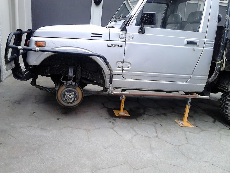

Nice effort, good to see jack stands being used...

cheers sorry for big gaps in the build so many photos to up load right now !! I have been a busy bee !
new tyres
rear mounted radiator
rebuilt starter
rebuilt alt
new clutch
new oils (maintence I know )
next up power steer !
new tyres
rebuilt starter
rebuilt alt
new clutch

this was over at pretoria road little bit of a change since i first brought

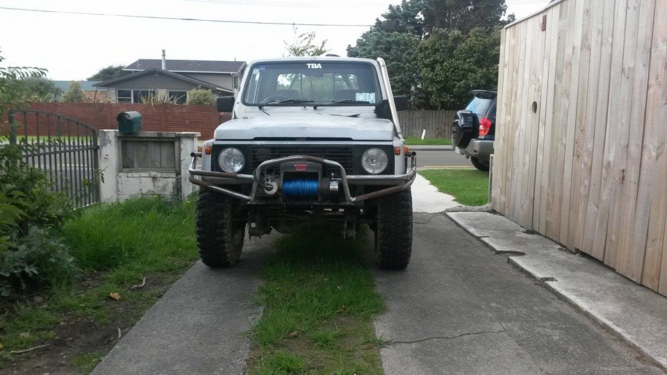

soooo a while since ive been bothered to do a write up but she is going for a cert on friday (today is monday )
so pretty much ive done the 1600 conversion
power steer
lockers both ends
29x10.5 swampers on - 50 offset rims that are beadlocked
custom shackles
i reset my own springs in the pipebender works a treat!
exo cage
light bars
bullbars
custom tray
rear mount radiator
custom front drive shaft using a hilux front universal
led tail lights
to do is finnish up beadlocking the rims
shave the diffs
front and rear gussets on the diffs
storage (god damn i need some )
re make rear hook mounts as bud bent mine with the lard ass minsteral
bout it for now ill dump a shit load of pics when i get on my computer next
feel free to as questions
