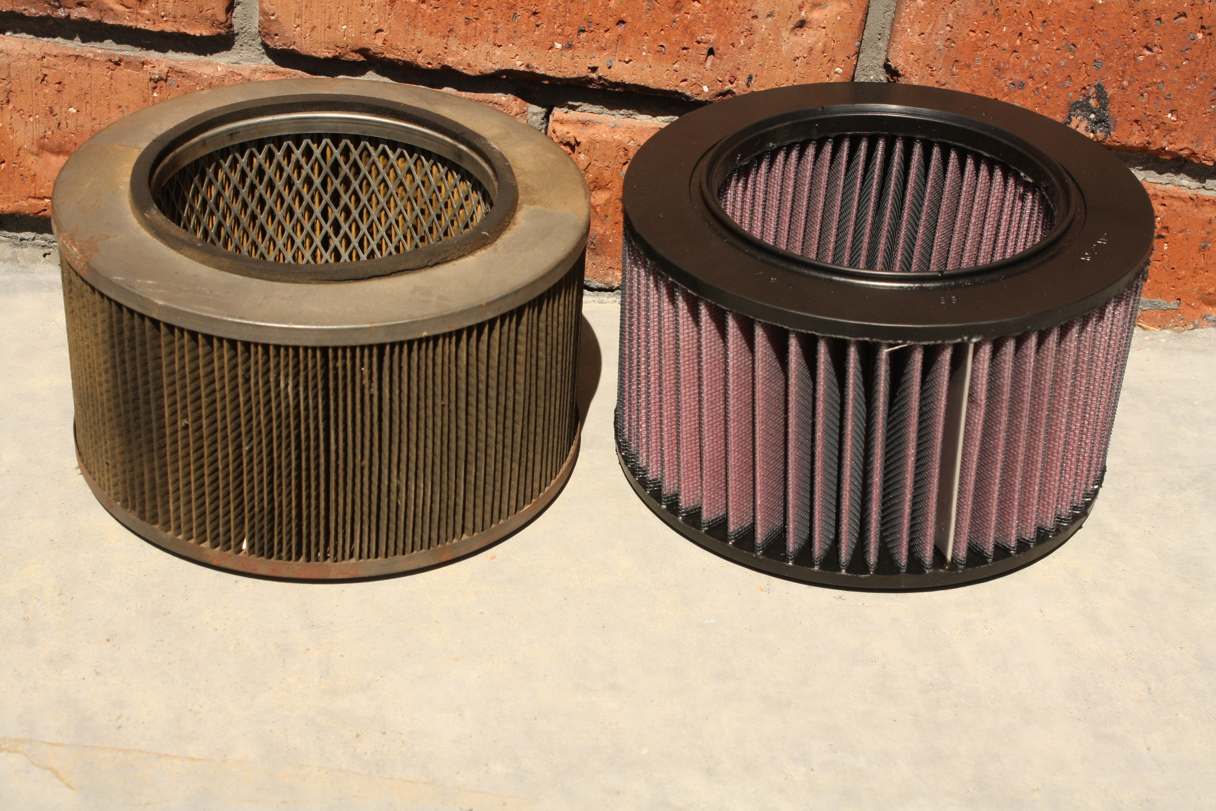

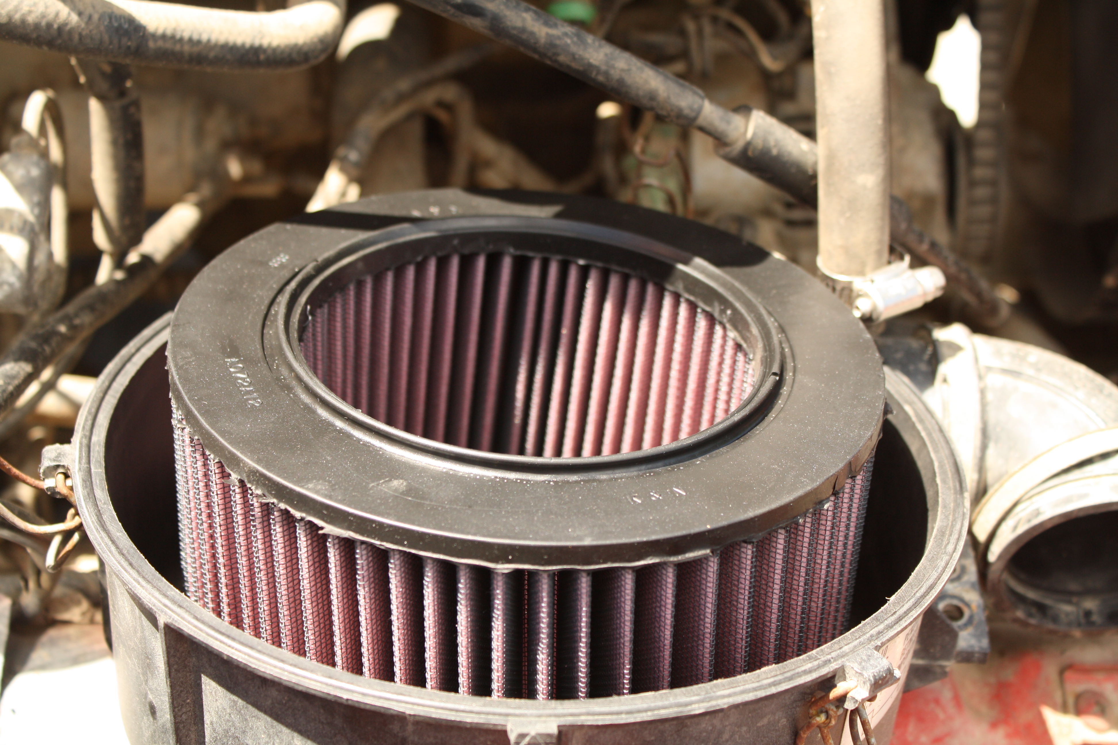

So I am still buying stuff for it despite my last post.
I got this.
I got this.
