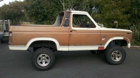

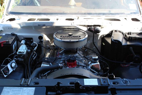

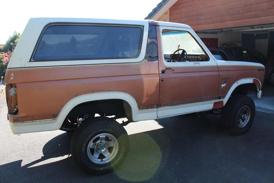

Bronco Pics...hopefully this works. Has 460BB, alloy heads, shorty headers, 750dp, mild roller cam/lifters etc, C6, 4 inch lift, hydroboost brake system. Really just a cross between me liking V8's and Trucks generally and crosses over as something we can go camping in. Started pretty average so did a full rebuild of the running gear but not quite a body off restore but stuff like brake lines, calipers, cylinders etc I've replaced. Its at the panelbeaters at the mo. Still to do interior but got some bits like seats etc lined up for it plus full set of rubbers to go in. Been fun but buckets of time. Pics don't do it justice but shes pretty big.
Anyway, Pics below:

Engine bay:
.jpg)
Anyway, Pics below:

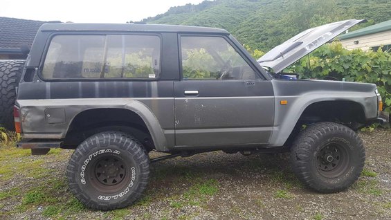

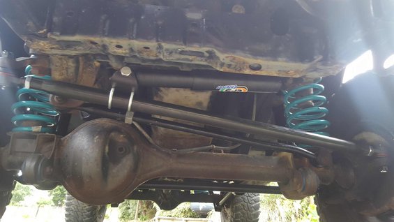

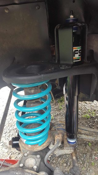

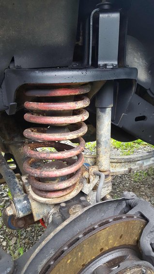

Ok so its been a while as was working on the bronco. Started ion the rebuild of the GQ. Started with suspension. Have swapped out the old lift for 3 inch dobinson coils and EFS shocks. Also did adjustable panhards and superior engineering drop boxes rather than caster correction bushes. As part of the process I went to heavy duty rear lower control arms and new rubber bushes for the rear arms and the front radius arms. She drives very smooth now. Hope these pics work.
Old suspension
And new:
Also while I had the welder out i took 40mm out of the lower edges of the front guards and moved the lip back to give better clearance for my 35's. They did use to clear but only by about 10mm. Now they got plenty of room and you can hardly tell the guards been cut.

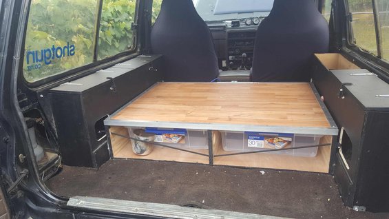

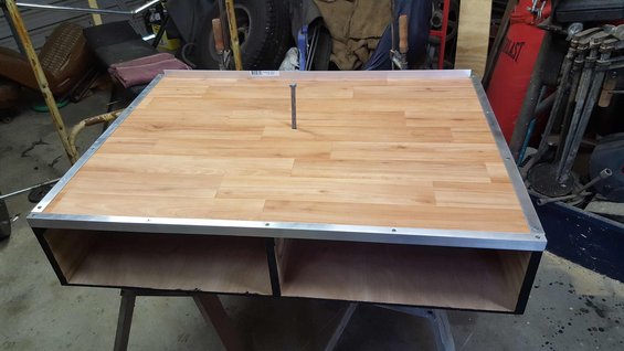

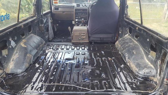

Also tidied up the interior. Cleaned out the floor area and did POR 15 in the rear and mat tblack up front. Then made new storage bins for the sides and a box for two bins in the center. In the middle I made a steel bracket so I can lay the spare on top and pull it down with a long 12mm bolt and bracket. Plastic bins and stretchy stop everything sliding out and don't rattle.

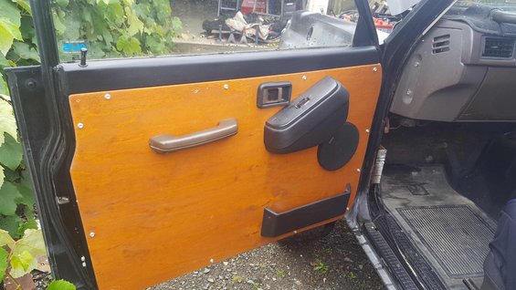

Also my old door cards were poked so made some out of 7mm ply and stained them. Actually came up better than i thought they would!

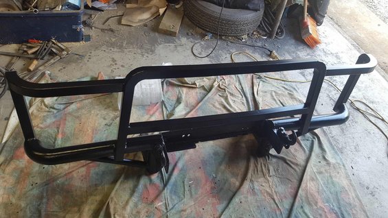

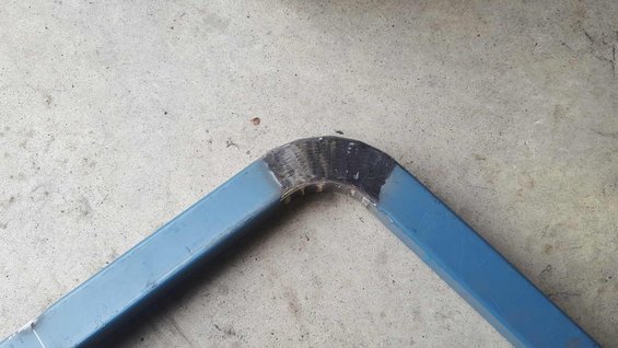

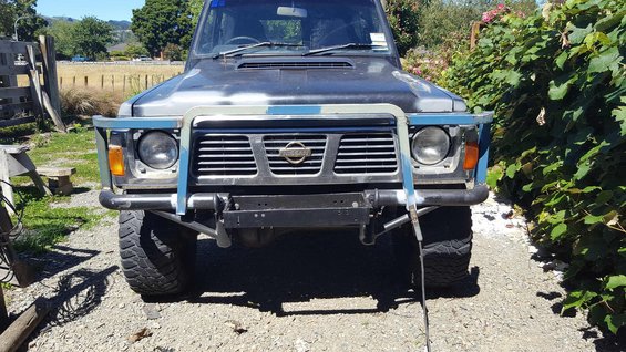

Last thing was finishing the bull bar. Started a while ago. Now got myself a good PTO winch so rearranged the old electric cradle and added some bar work. I went with 40mm box only cos it suits the front I reckon. Bit of time to create the curves but looks the business bolted up.
And tacked onto the old steam pipe base bar.
Painted with primer and two coats of killrust matt black enamel.

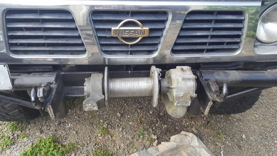

Also replace my old grill. After a few years it was cracked everywhere so got one off TM and thats tidied up the front. Now just got to mount the bar and winch then start shifting my 3 inch exhaust to get the winch drive mounted up. Also looking to repaint the truck myself at some stage. Just working on colours to tidy it up and protect it a bit.
