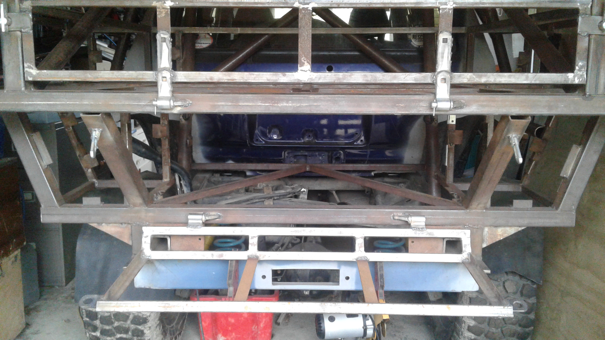

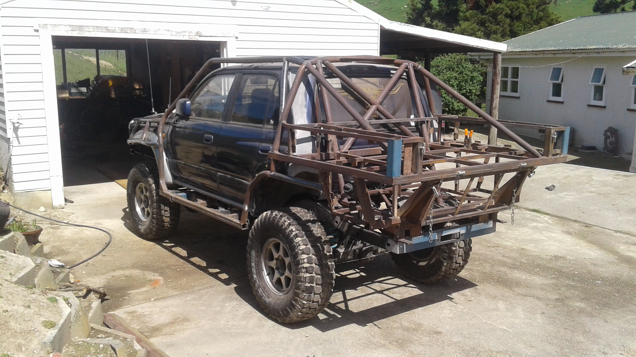

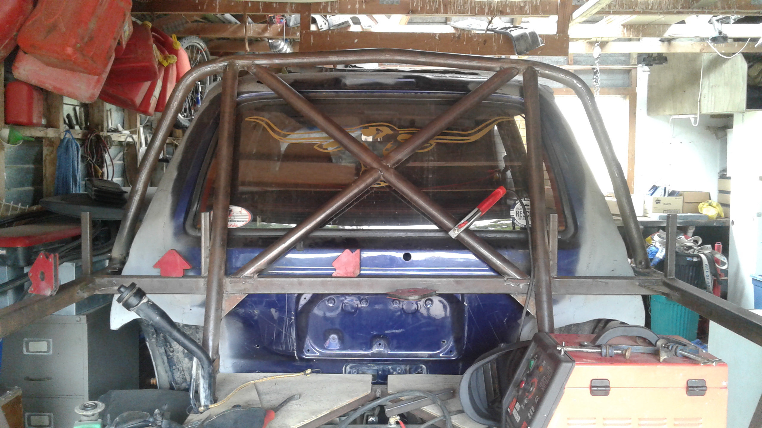

Made a start on rear, spare wheel will sit on that frame then 350 mm above that will be the deck.
Ignore the big box sitting above wheels
Andrew 0272226292.

Bit more progress.
Andrew 0272226292.

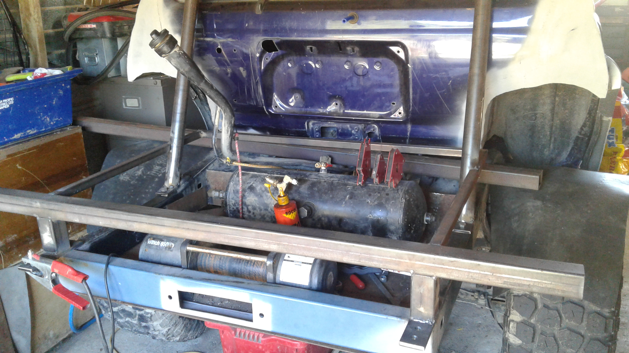

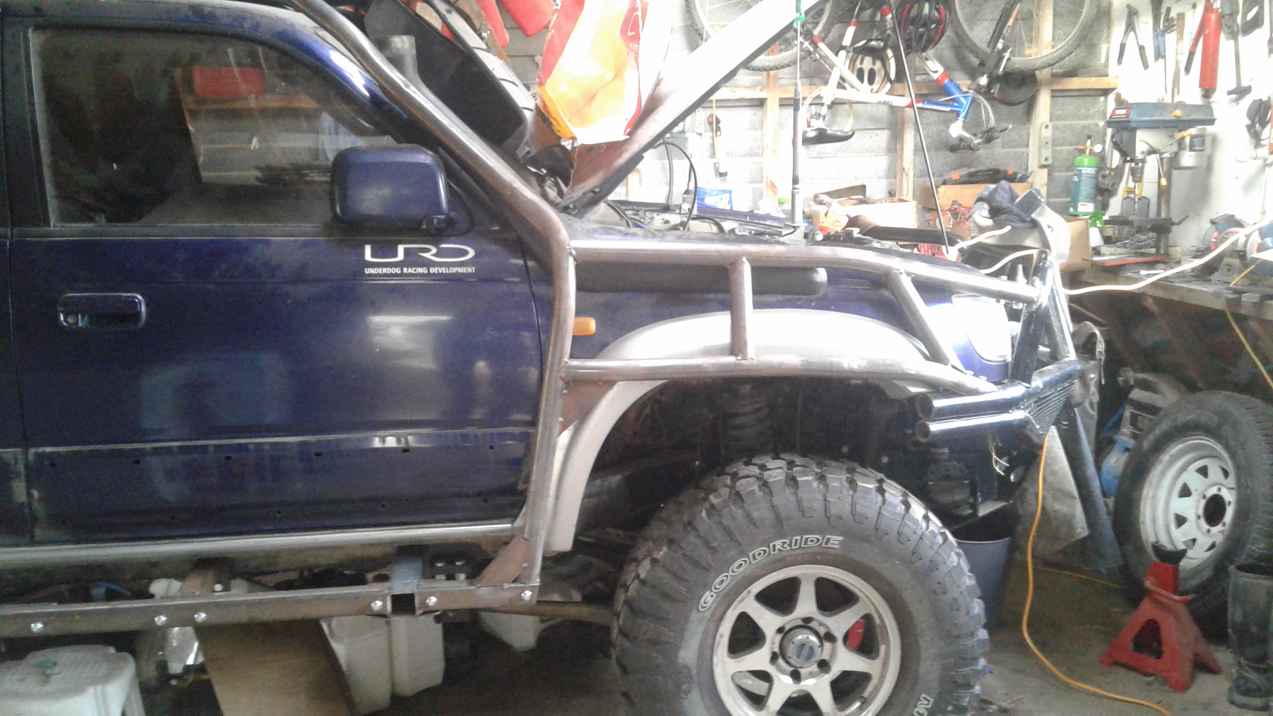

A bit of progress.
Hoop over top isn't perfectly even but that's what you get using a cheap $200 bender.
Hopefully not too close to body, will find out one day, if it rubs might have to solid mount 2 rear body mounts.
About out of steel so will have to order some more.
Andrew 0272226292.

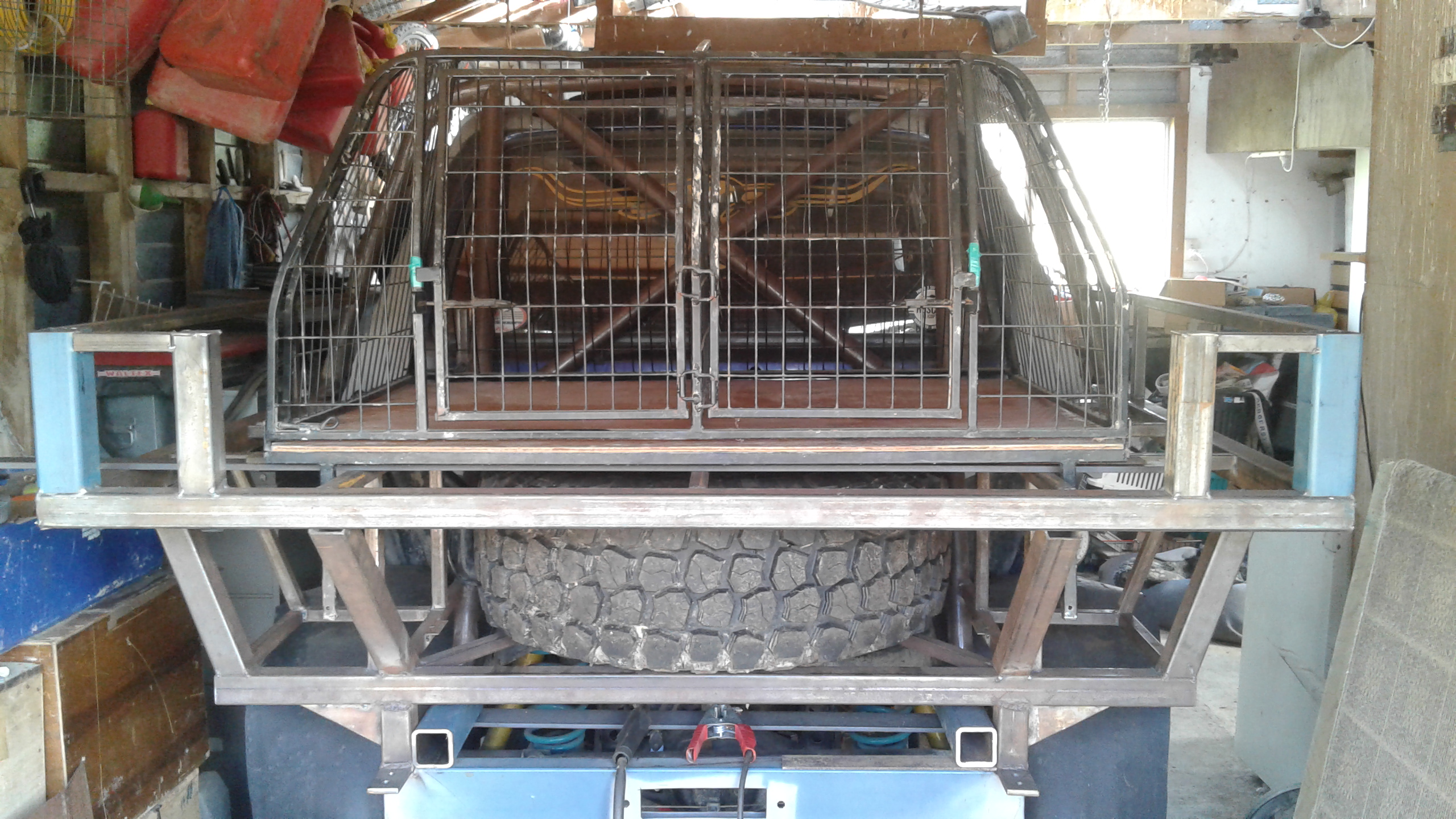

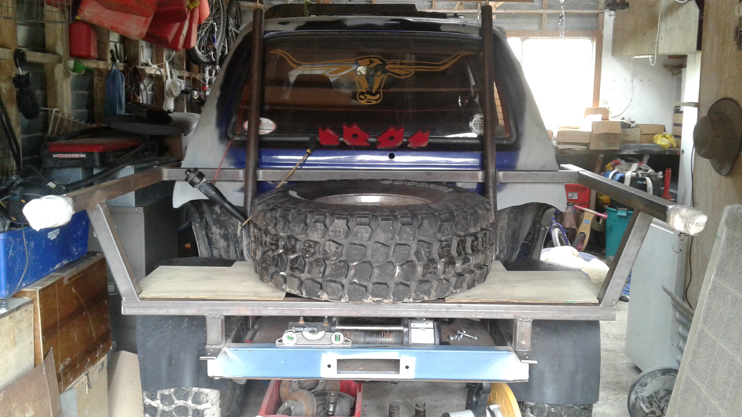

Finally a bit more time
A 10.5 wide spare will go forward about 50 mm further forward.
That dog box used to fit in back of surf when it was a wagon, comes apart/clips together.
Will put holes in deck so the legs on box can go through so it can sit flat on deck like that, usually a 230 mm space underneath.
Good for safaris too. Will get a canvas top to go over a frame one day.
Stays to make up next, on the side of crate.

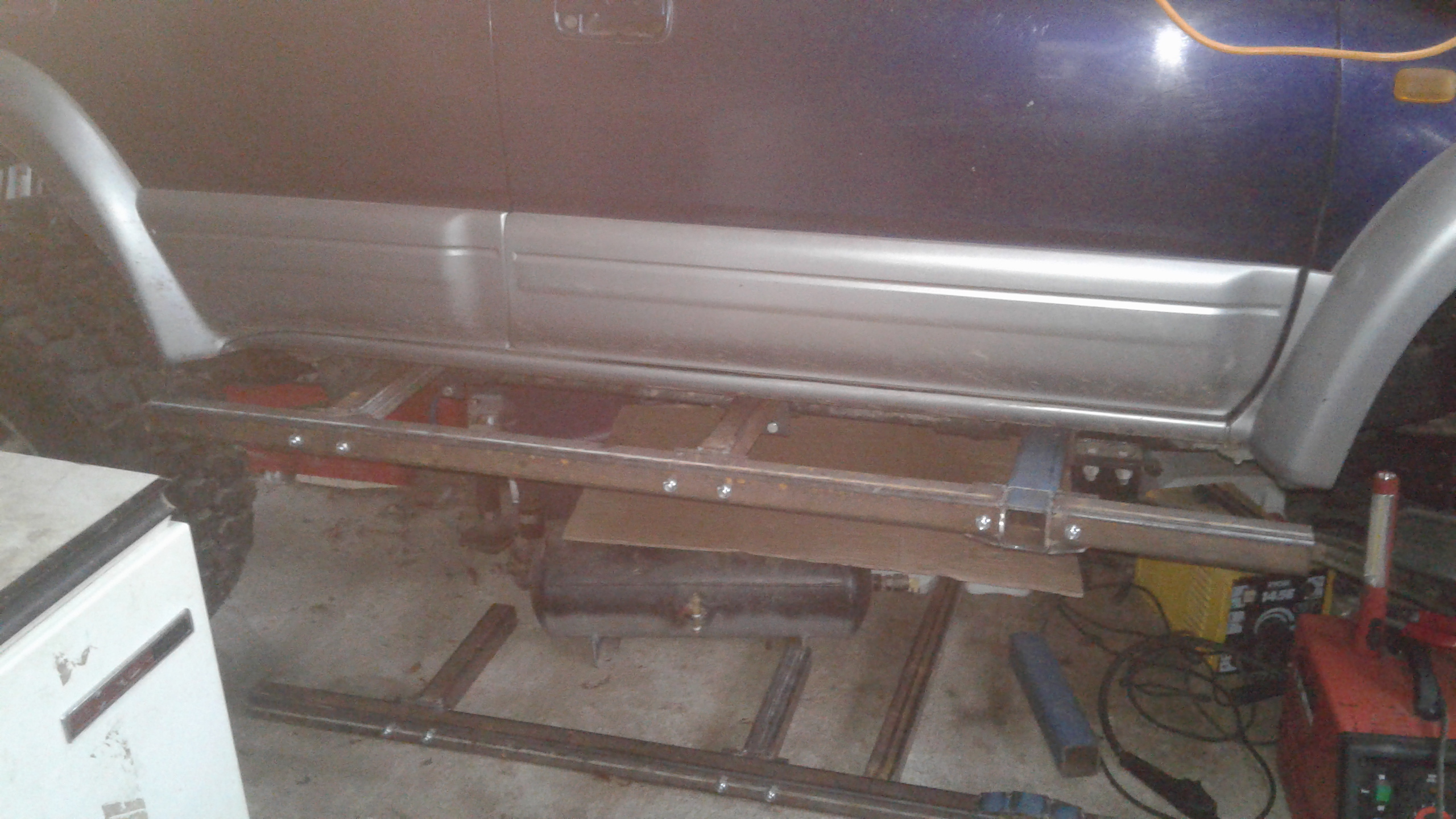

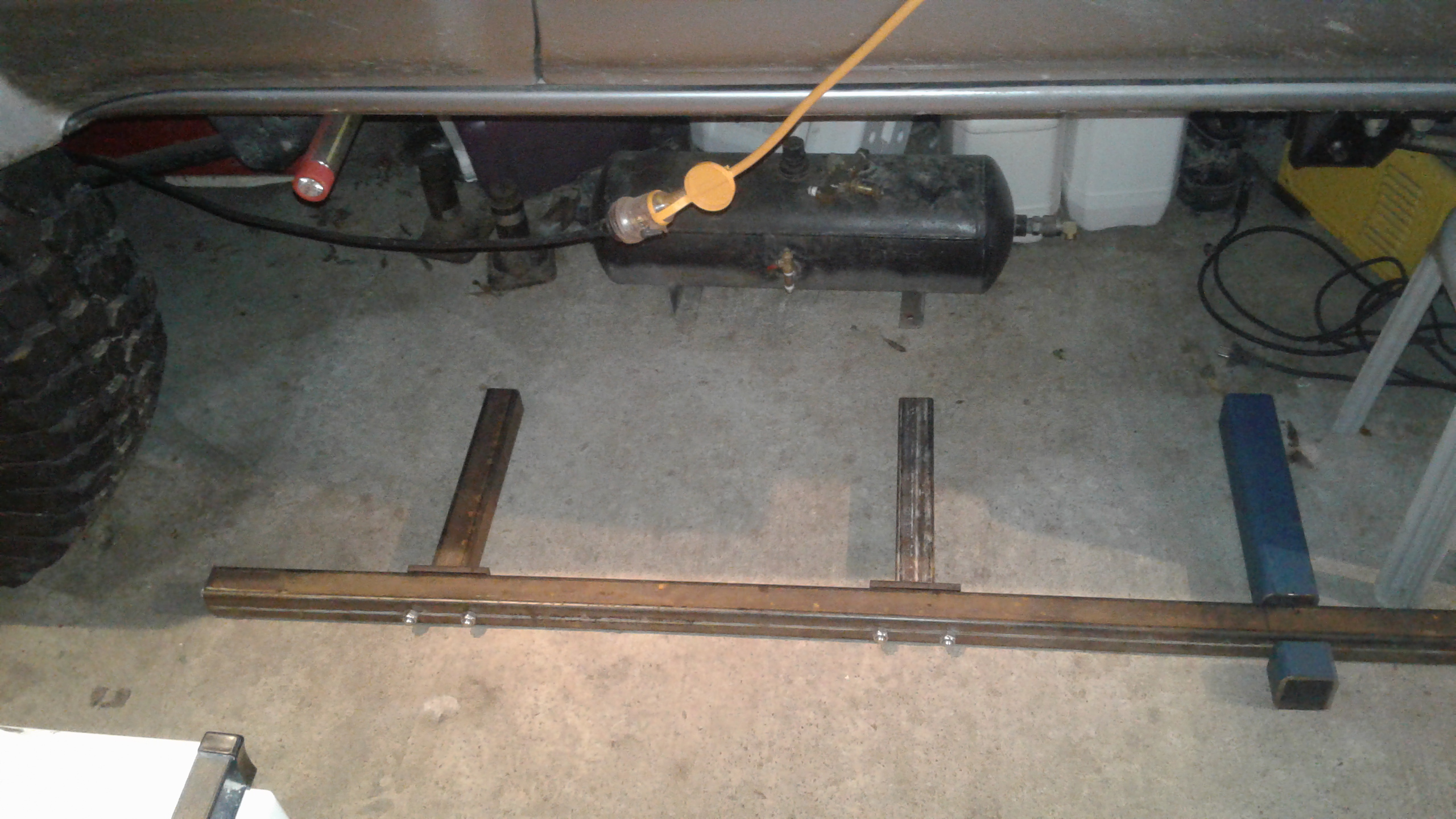

Brackets to fix sliders to chassis.
Start of sliders, bolts will be other way around, just don't want to melt nylons welding.
Hopefully bolt heads won't get caught on rocks or anything.
The box running front to back will be part of the complete exo so when/if lifted off it won't just be attached to the main hoop in one place. I'll put a bar from slider to below where hoop sits on deck behind rear door.
big blue box will be open end (have something in to stop it filling with mud) so can have a box slid in held by large pin (like a tow bar) in case a winch/whatever point is needed on the side low down, pulling straight off chassis.
that short piece of blue box will be welded sideways into smaller box and have tabs to bolt on like other two.
Andrew 0272226292.

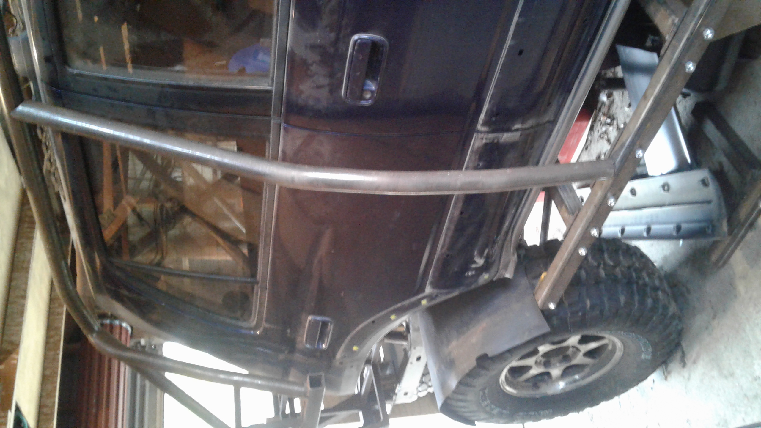

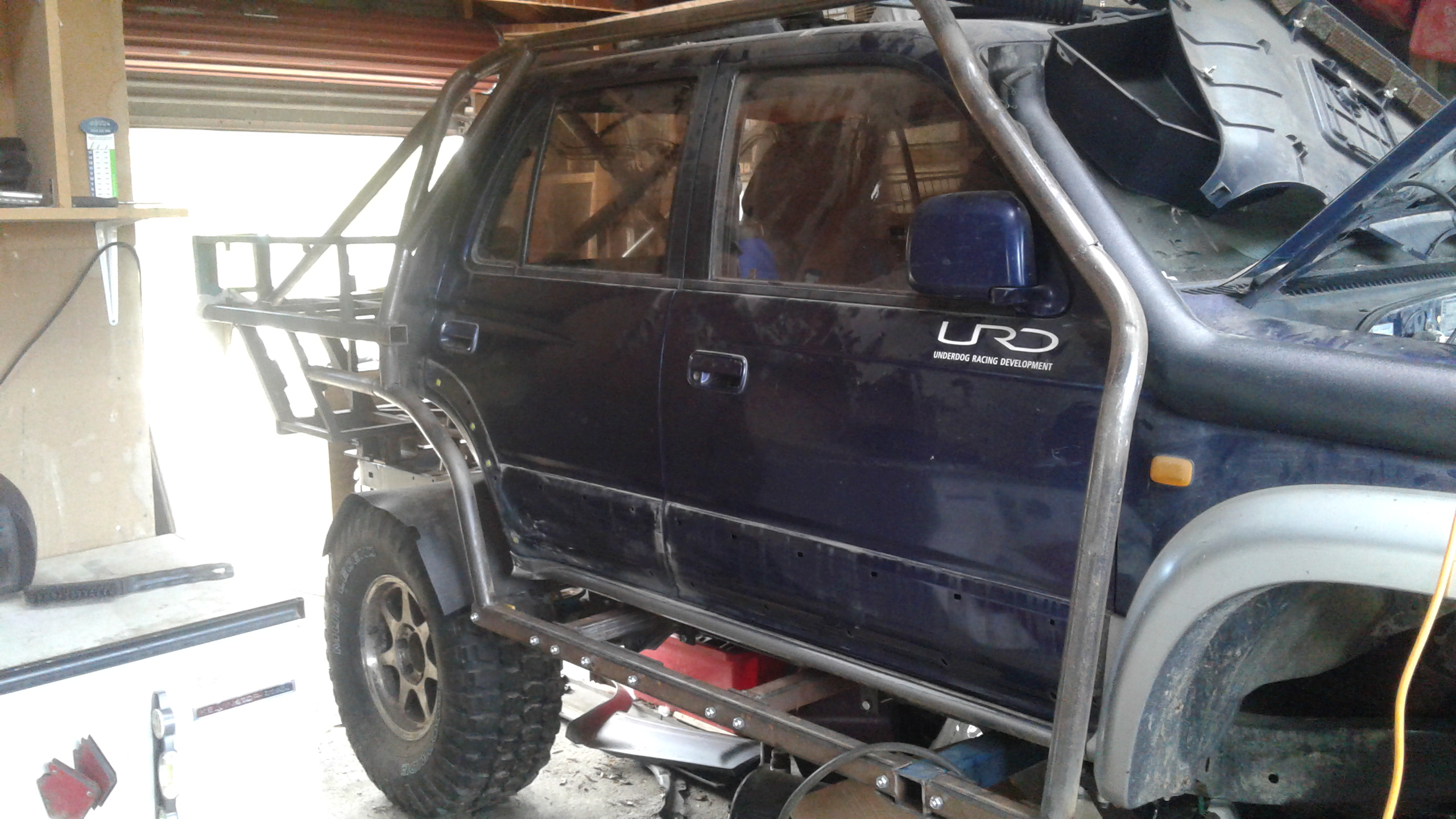

In place, some diagonals to go in to strengthen it up.
Can start building up off it now.
Hopefully clears body when/if lifted up as part of the exo.

Bit more, 2 bars along guard to join up to front bar next.
End of box behind rear door be cut on angle and capped.
Was planning on adding a bar between doors but had to be out so far to clear doors when open that it just looked ridiculous, and would also get caught on things, so will make do without it.
Rear door still hit it when fully open, and front door only missed by about 5 mm.
Andrew 0272226292.

Post by skidmark »
I had thought about that bar aswell, I haven't really required it on mine yet.....ps should be sweet with clearance, looks like plenty there. The bpillar bar on mine was real tight, aprox 5-10mm in places and well let's just say the there's some nice curved clearencing been done.... about 15mm would be about right id say

Hard to see in photos but it stuck out a lot further than the other bars along side, figured it would get caught up on things and probably just cause more problems. So I cut it up and used else where.
Andrew 0272226292.

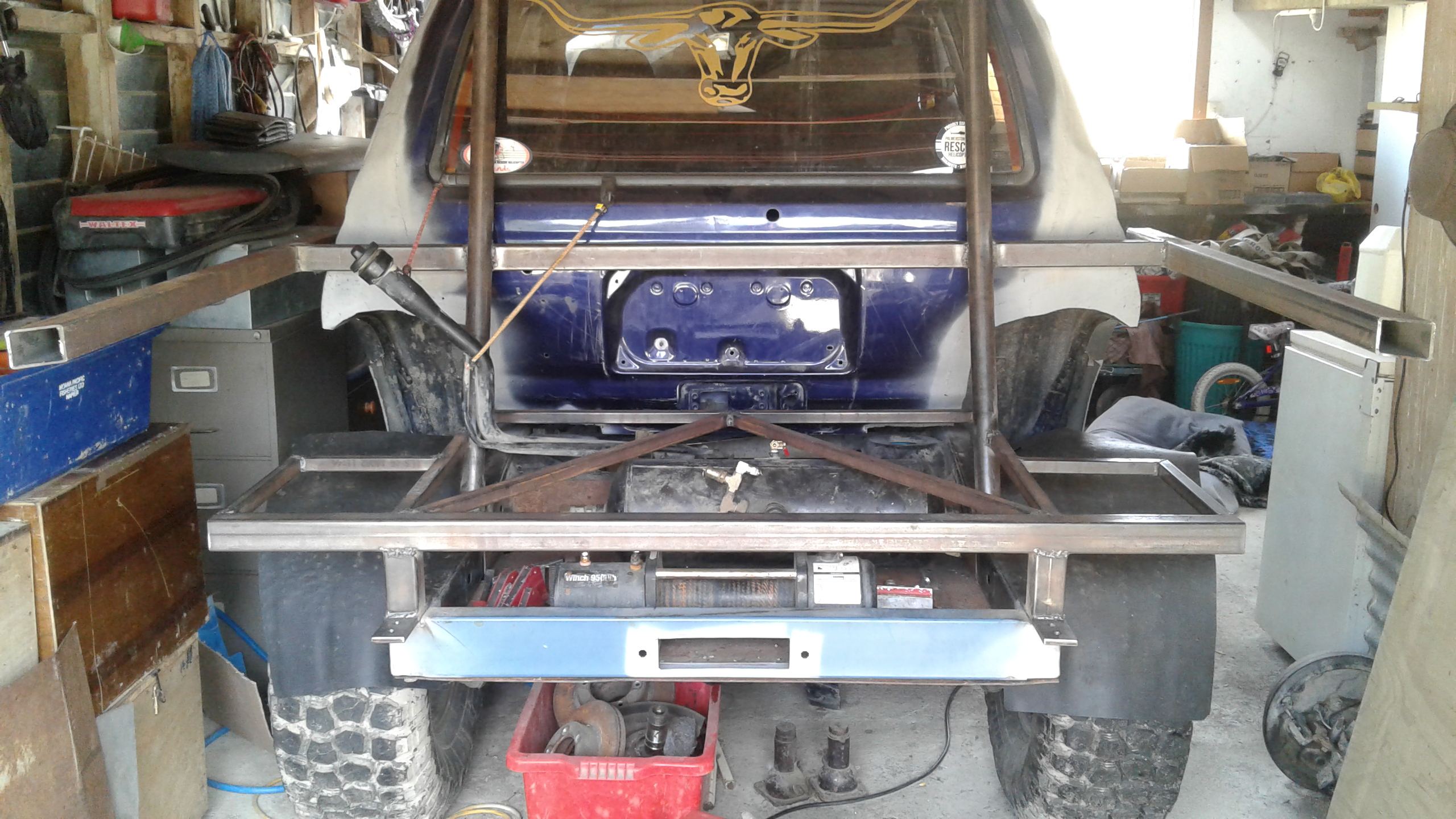

Tail gate frame made up.

Post by mudsurfv6 »
Spare wheel cover also acts as a step for getting onto deck.
Still got to plate side for strength and put chains on to hold it level.

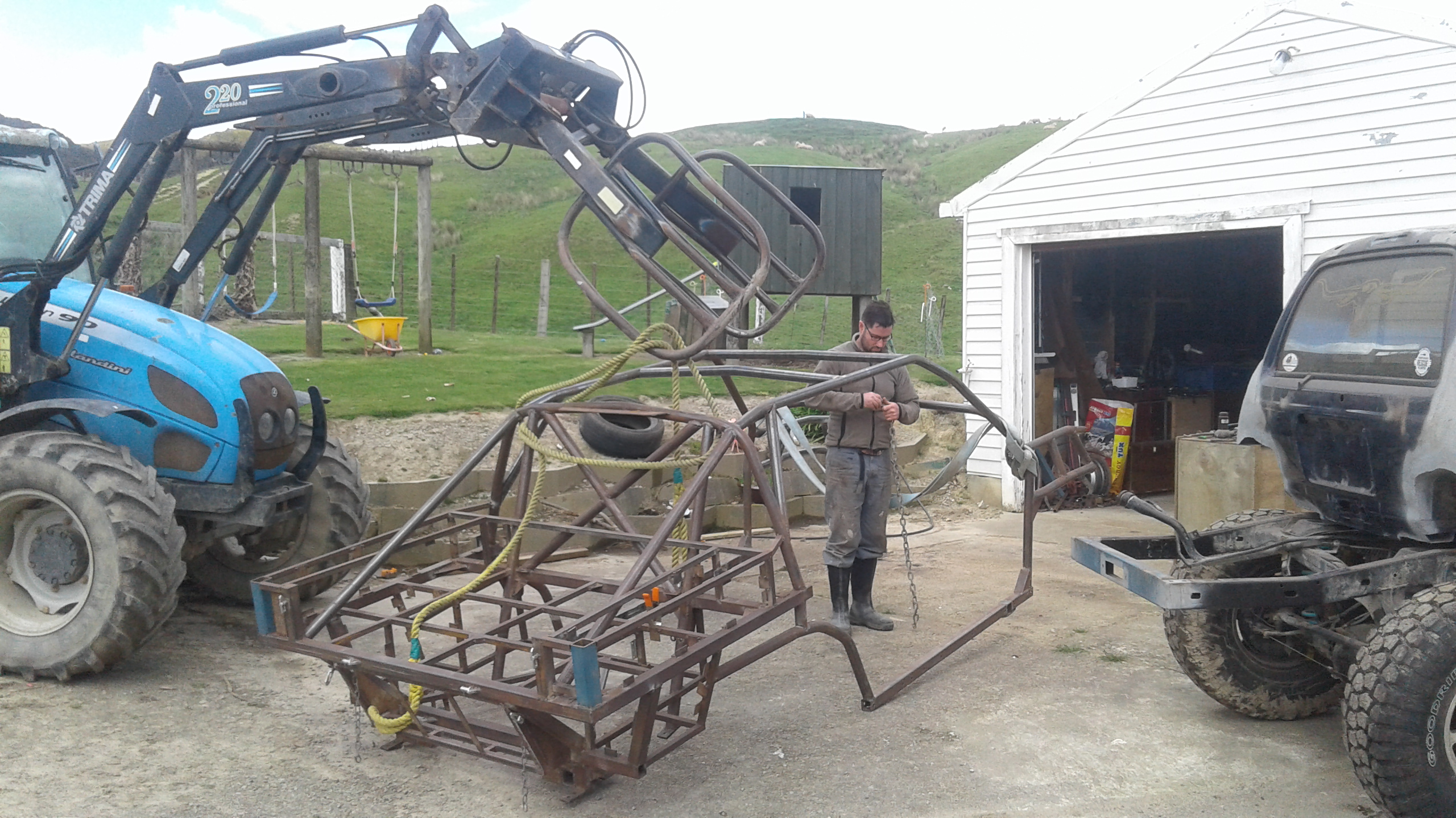

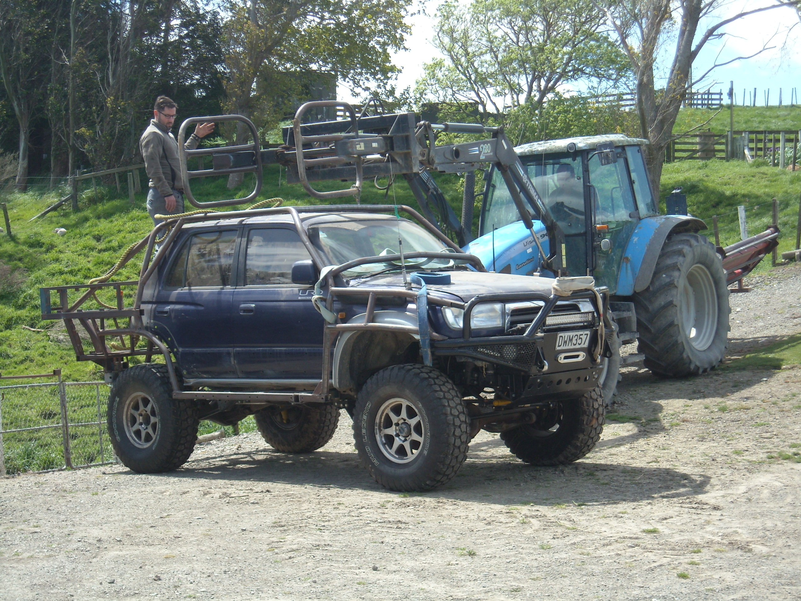

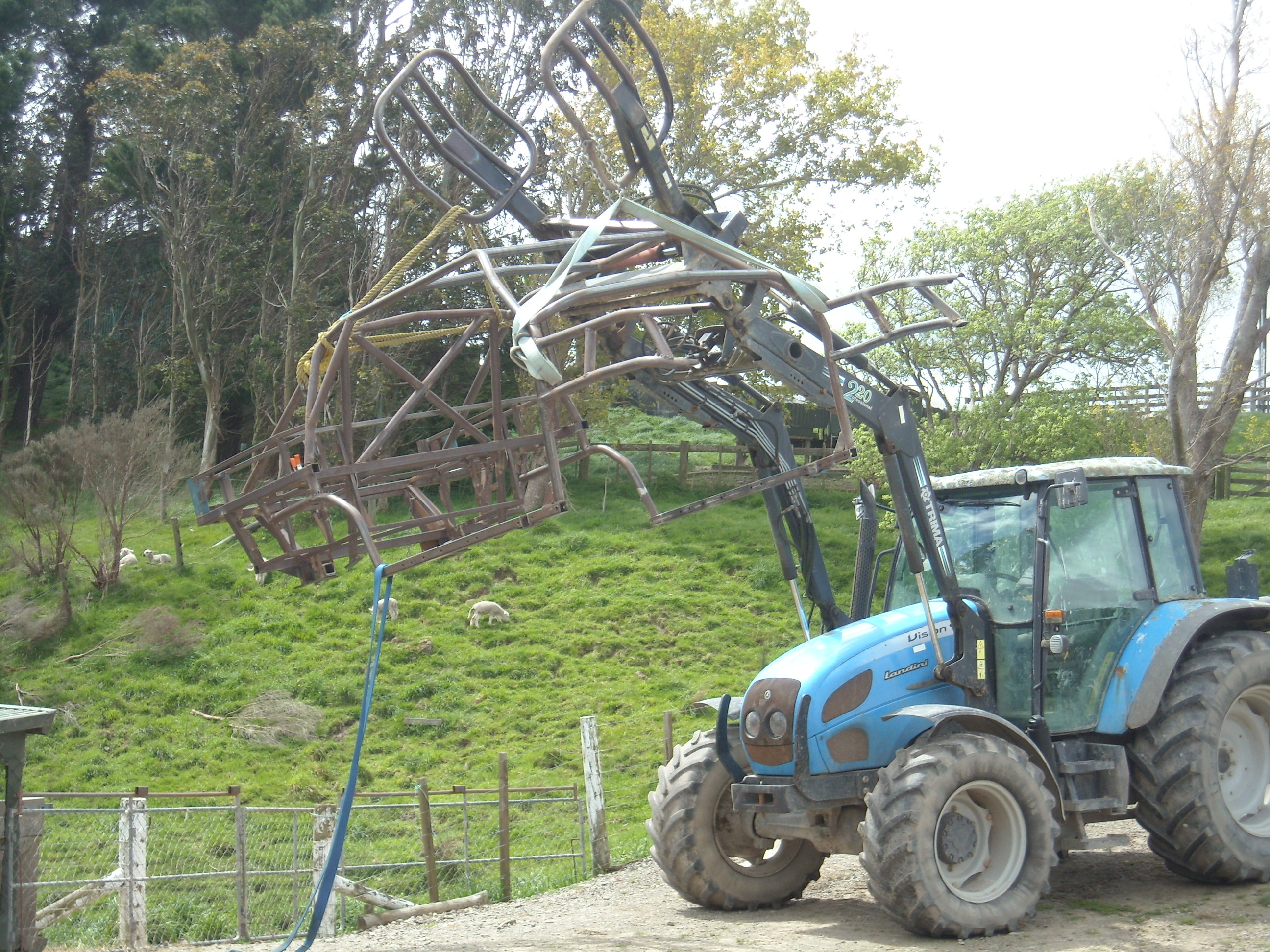

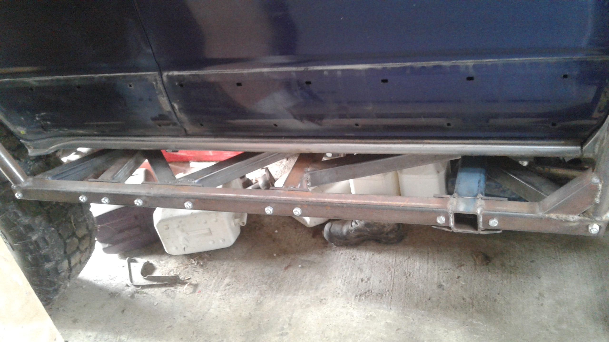

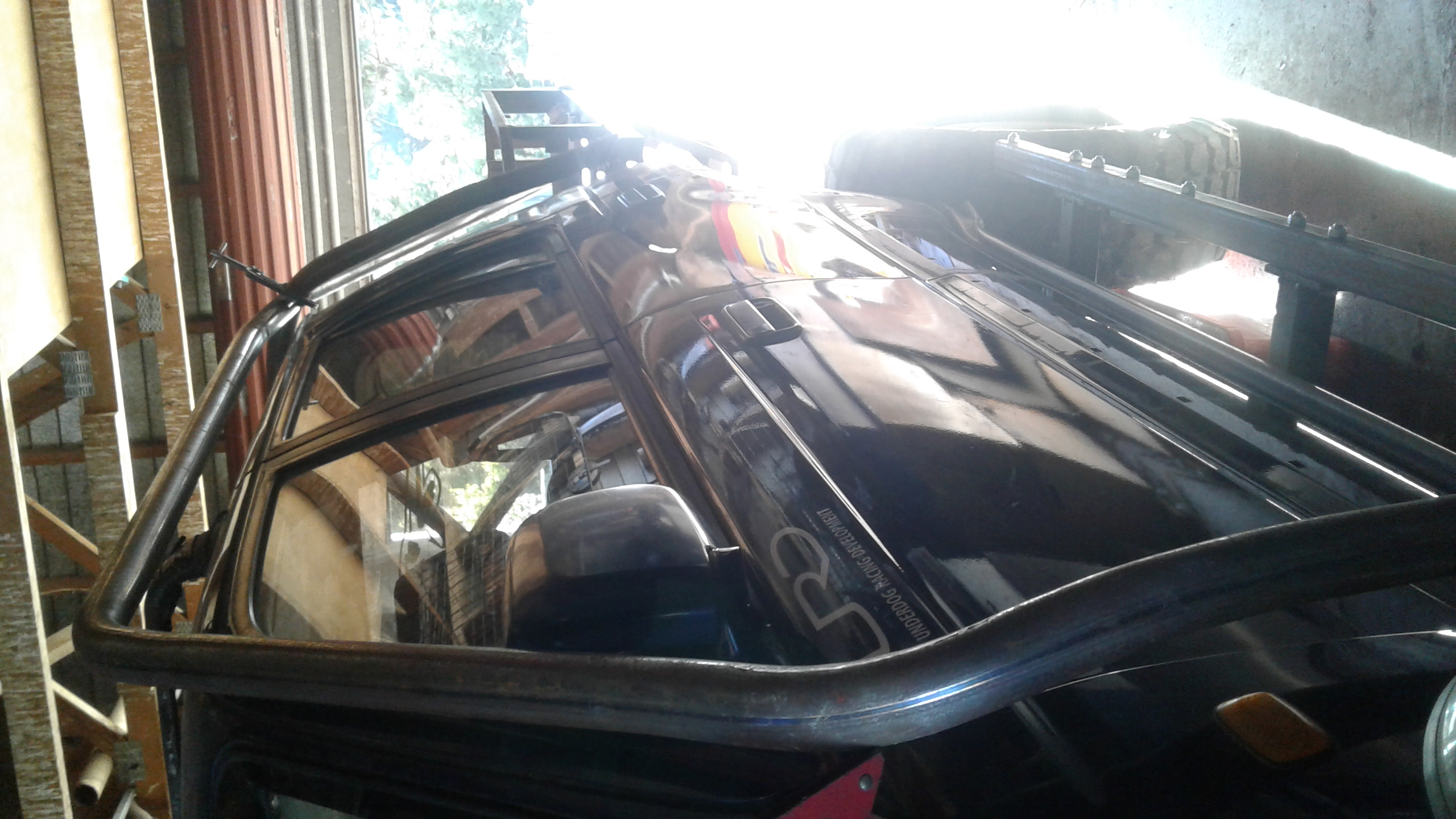

Got a whole weekend spent on rest of bar work and lifted it off. Got a heap of welding to do now.
Photos will have to be one at a time, for some reason all photos in one post show same.

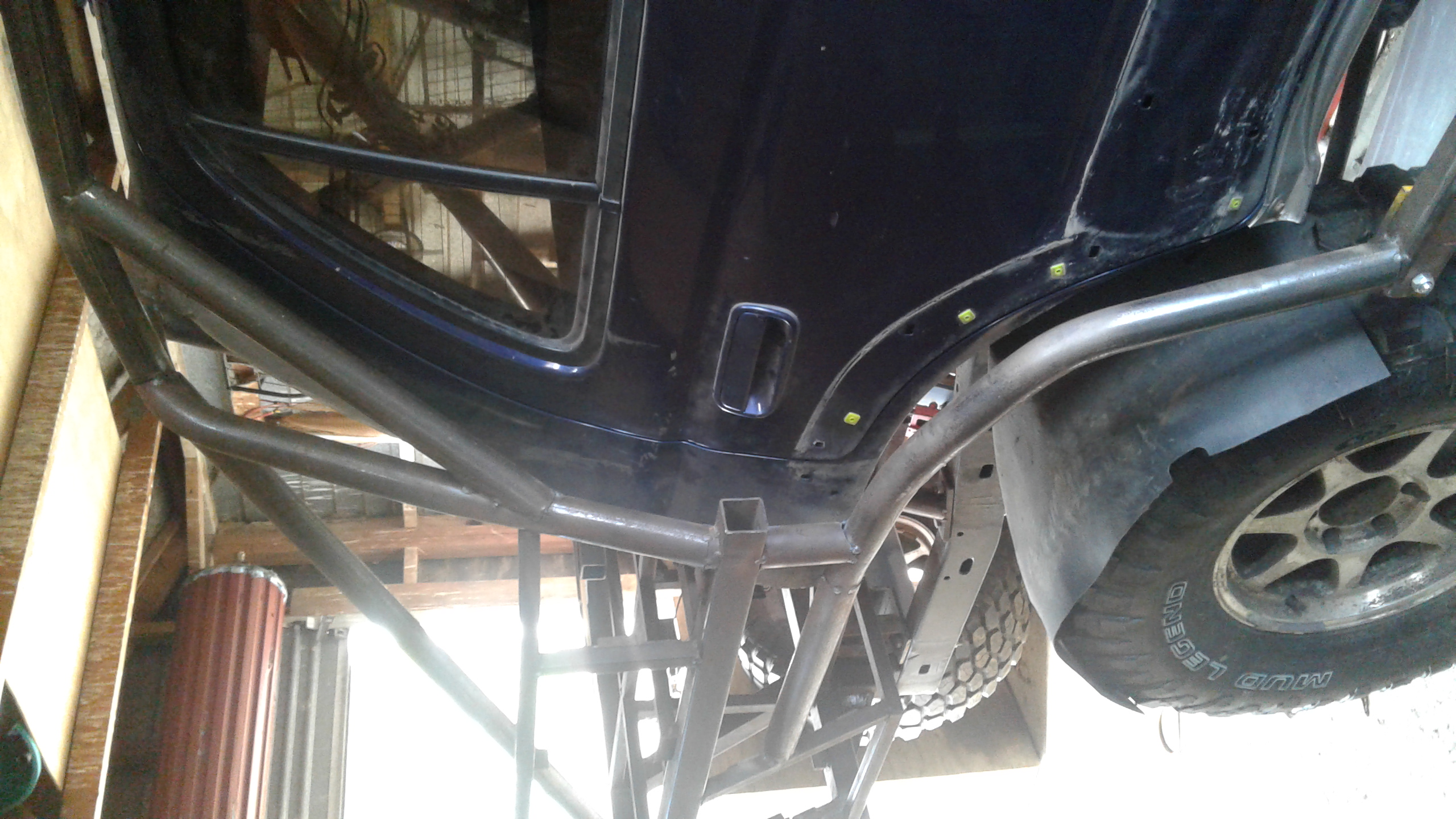

handy having a tractor.
