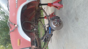

Rolled the surf i built and now got a new project and started frm scratch apart from motor and wheels, done cross over steer, rears up front, front and rear u bolt flip, braided extended brake lines got 12inch bilstein shocks for front and rear and done ifs hub swap and bigger calipers lsd diff in front and welded diff in back so far and going to try get done for rallywoods on queens bday weekend

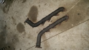

Busy weekend moving trucks around and doing some work to get motor ready to go in got manifolds heat wraped and draining trans to mount transfer box bought a copper safari radiator to mount on back and have a runva competition winch on its way

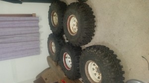

Rear winch done and few other bits and pieces and few more sets of wheels and tires and exo cage started almost ready for rallywoods agen
