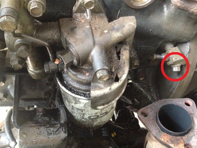

Hi got a 2.7td terrano that has what appears to be a head gasket leak just wondering if anyone can tell me if there is a drain plug etc
on the block to completely remove coolant from engine. I believe td42 does not sure about 2.7. I am not near car at moment
to get under and look so any advice would be gratefully received . Thinking about trying product a mechanic pit me onto but its needs coolant flushed out totally to work. I realise its a band aid but if works I only need car for another few months. cheers

a small bolt right beside the turbo water return line, to the right of the oil return line.

Awesome, I was just about to ask this same question! I'm just about to do a flush and new thermostat...
But without taking the turbo out of the way, won't the drain plug be a bastard to open??? :cry:

go in through wheel well. use alot of extendos

Yep, thats how I went in today... But the plug is seized and it turned the whole fitting, which caused the water feed to the turbo to snap off. YAY! Not...
So I had to take off the turbo downpipe and engine mount to get the broken bits out. I'll go into work tomorrow and braze it back together. On the plus side none of the exhaust nuts and bolts were seized. Oh and I had no problems draining the coolant! :lol:

That.. would just break my heart. I dont know how many times ive undone that plug on terranos but never that ^ :lol:
