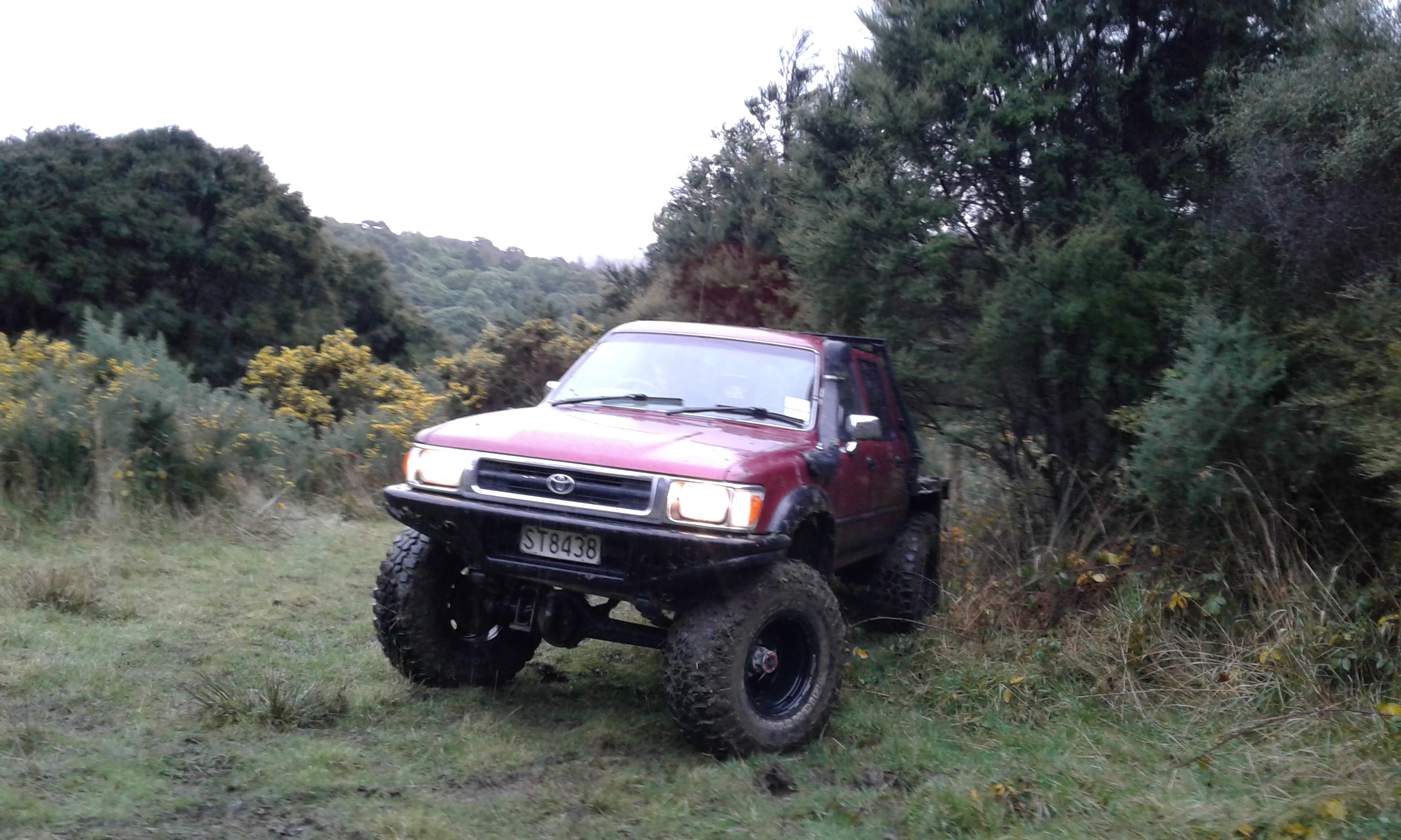

Recently brought this
1994 SR5 Ln106
2.8 Turbo Diesel
RUF
New Raw 4x4 shocks in the rear
Have them for the front just not installed on the front because it needs different bushes
2003 HiLux rear leaves
Snorkel
35x12.5R15 Maxxis 762 Bighorns
Rebuilt front and rear diffs
4.5 Diff gears
Front bar
New head
Think thats all.
Took it out yesterday for its first run.
Extremely happy with how it preformed. Still needs a WOF and Reg. But other than that the plan is just to drive it at the moment.
The only part on it thats leaking is the oil catch can and the exhaust where it attaches to the manifold. But thats easy to fix.
Do I need to worry about the catch can leaking?

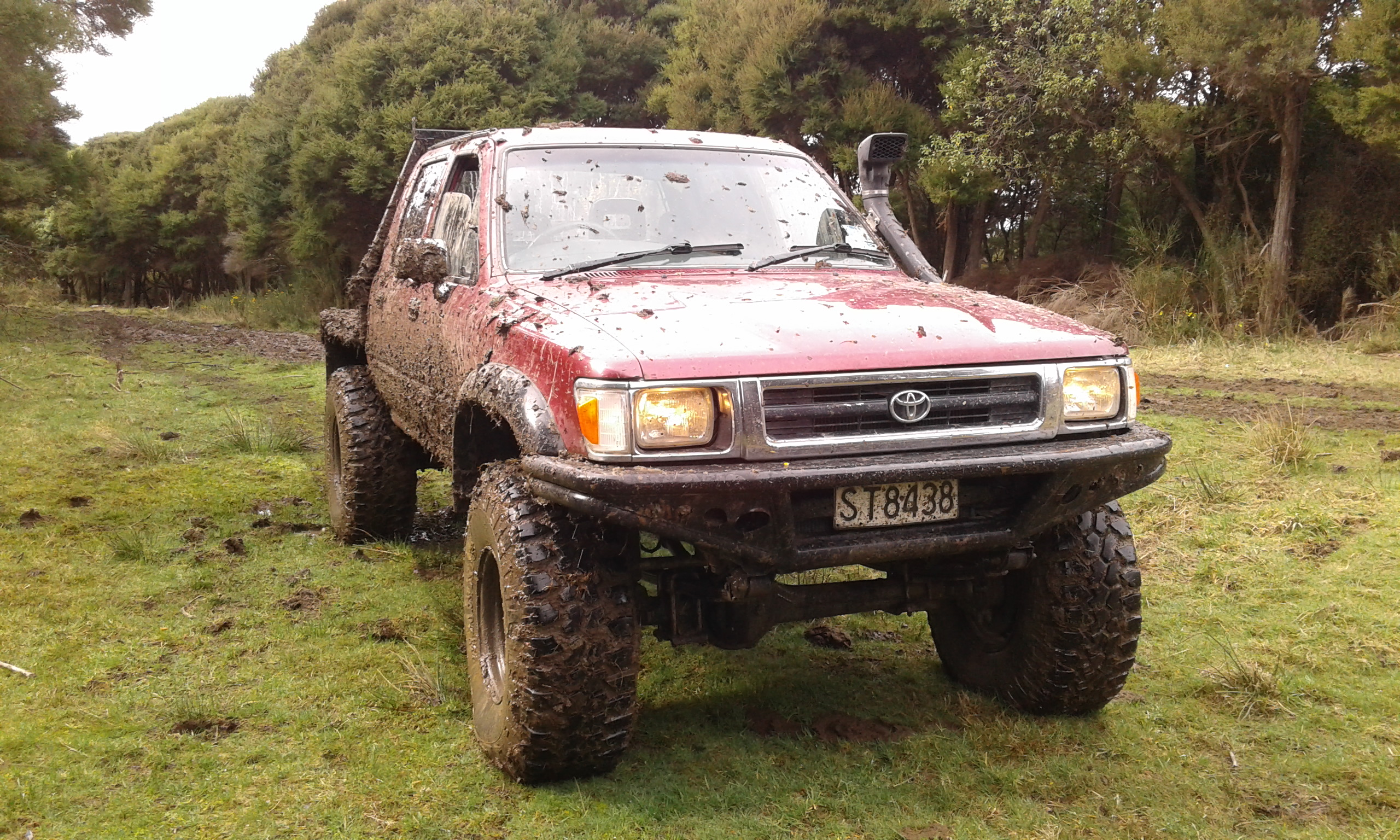

Re: '94 SR5 Ln106 Build
Went out on Saturday.
Seriously boggy. Still a hell of a lot of water around.
