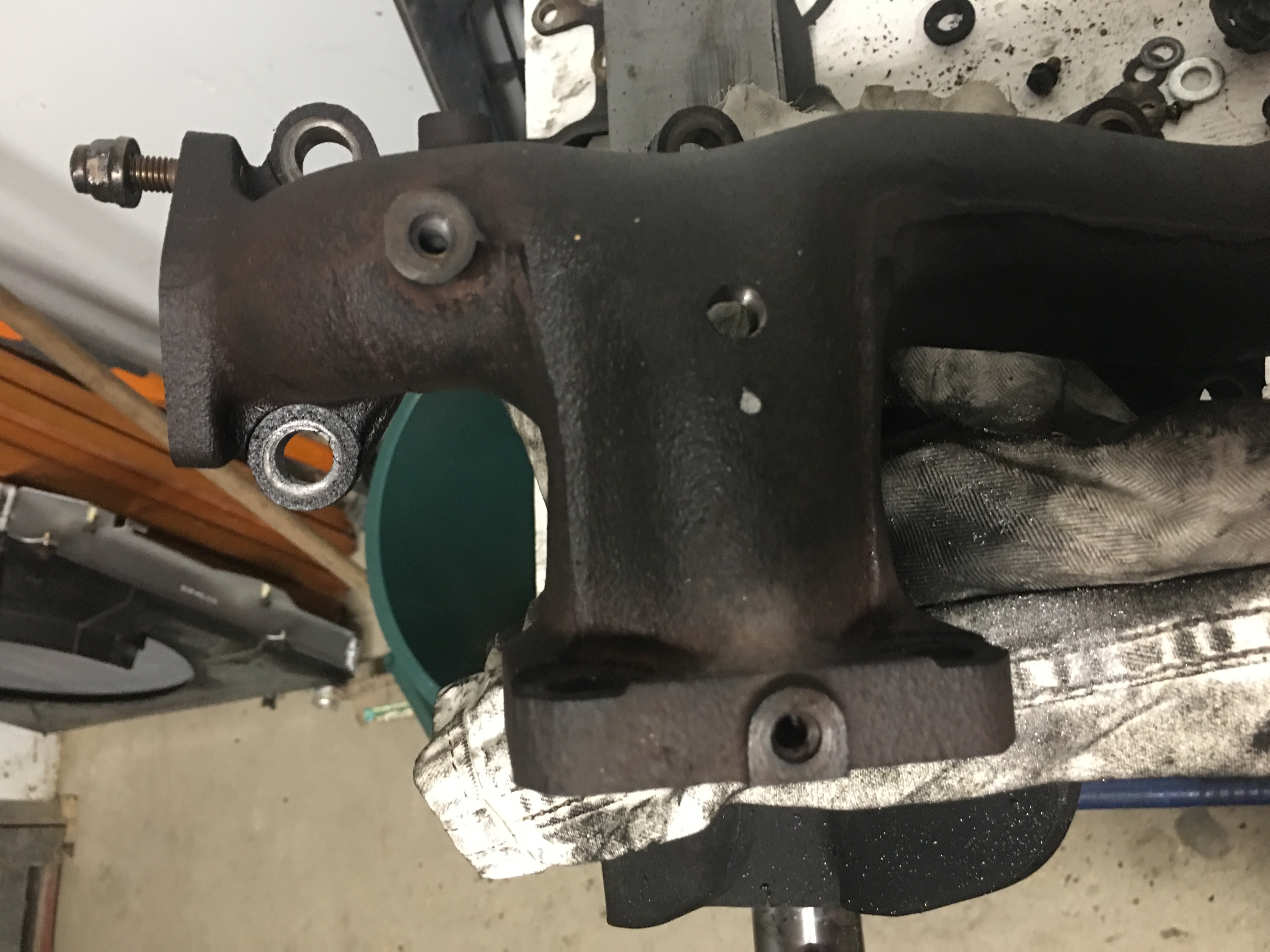

Next mission for weekend missions as the work ute gets me round at the moment. Cheap surf. Blue, 190kms never switched, but never seen a service. Opened bonnet, engine bay covered in oil like a BP pipeline spill. Drives fine, no overheating or signs of it - so the heads bound to crack soon. Not if I can help it. :x
Strip it right back
About 8 cans of degreaser later, turbo off, manifolds off, rocker cover off.
New water pump, new timing belt kit, rocker cover gasket - responsible for the oil paint job. New gaskets everywhere.

Throttle plate? you don't need one of those your a diesel get outta here. Yes, the intake and head ports were de-egr-gunked after this pic
EGT sensor tapped in
Aaand spot the pitting on the turbo wheel. The intake flexi was completely snapped when I took it off and someone had (failed to) repaired it with masking tape. like who needs an air filter? she'll be right. Off for a rebuild, with a cheeky hi-flow on the side.
