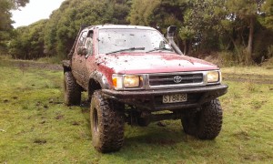

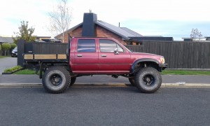

Recently brought this
2.8 Turbo Diesel
RUF
New Raw 4x4 shocks in the rear
Have them for the front just not installed on the front because it needs different bushes
2003 HiLux rear leaves
Snorkel
35x12.5R15 Maxxis 762 Bighorns
Rebuilt front and rear diffs
4.5 Diff gears
Front bar
New head
Think thats all.
Took it out yesterday for its first run.
Extremely happy with how it preformed. Still needs a WOF and Reg. But other than that the plan is just to drive it at the moment.
The only part on it thats leaking is the oil catch can and the exhaust where it attaches to the manifold. But thats easy to fix.
Do I need to worry about the catch can leaking?

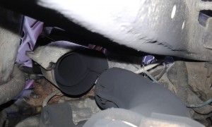

So a little update.
Thought id take the exhaust off today to get a new gasket for it.
But as it turns out there's more than just a leak.
Looking up at the turbo it looks like this.....
New exhaust time. But that's okay because I needed to make it longer to get it legal.
Anyone got any tips for making an exhaust?
Just going to make it out of 2.5in mild steel.
Life is better off-road
Re: '94 SR5 Ln106 Build
man it must be loud! what happened, for a whole section to be missing?
hahaha yeah it is.
I have no idea!
I have no idea!

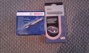

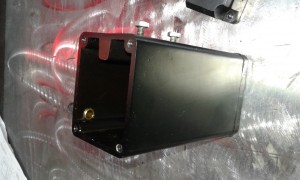

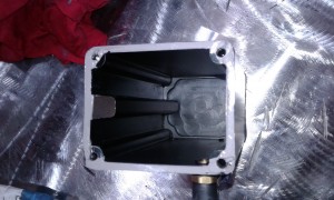

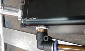

On Friday after work I cleaned up my catch can.
Look a millions times better now. I also replaced the gaskets with some fresh gasket goo and redid the sealant tape.
I unfortunately didnt get any pictures of it before, but this is what it looks like now. Plus the glow plugs and glow timer from catalystracing. Huge thanks to him.

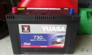

Plus my new battery.....
On Thursday last week I put it in and my mate manually glowed the plugs and she started first pop. Super happy about it

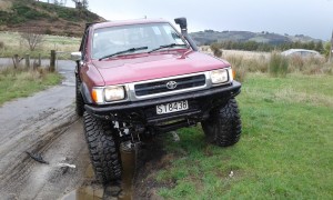

Shes all running an sweet now. Hopefully taking it out on Saturday,but see what happens.
My mate very kindly tidied up my weld on the chassis near on the crack and pleated it up all nicely. Will get a pick of it sometime.

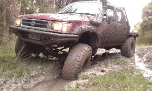

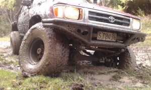

Went out on Saturday.
Seriously boggy. Still a hell of a lot of water around.
