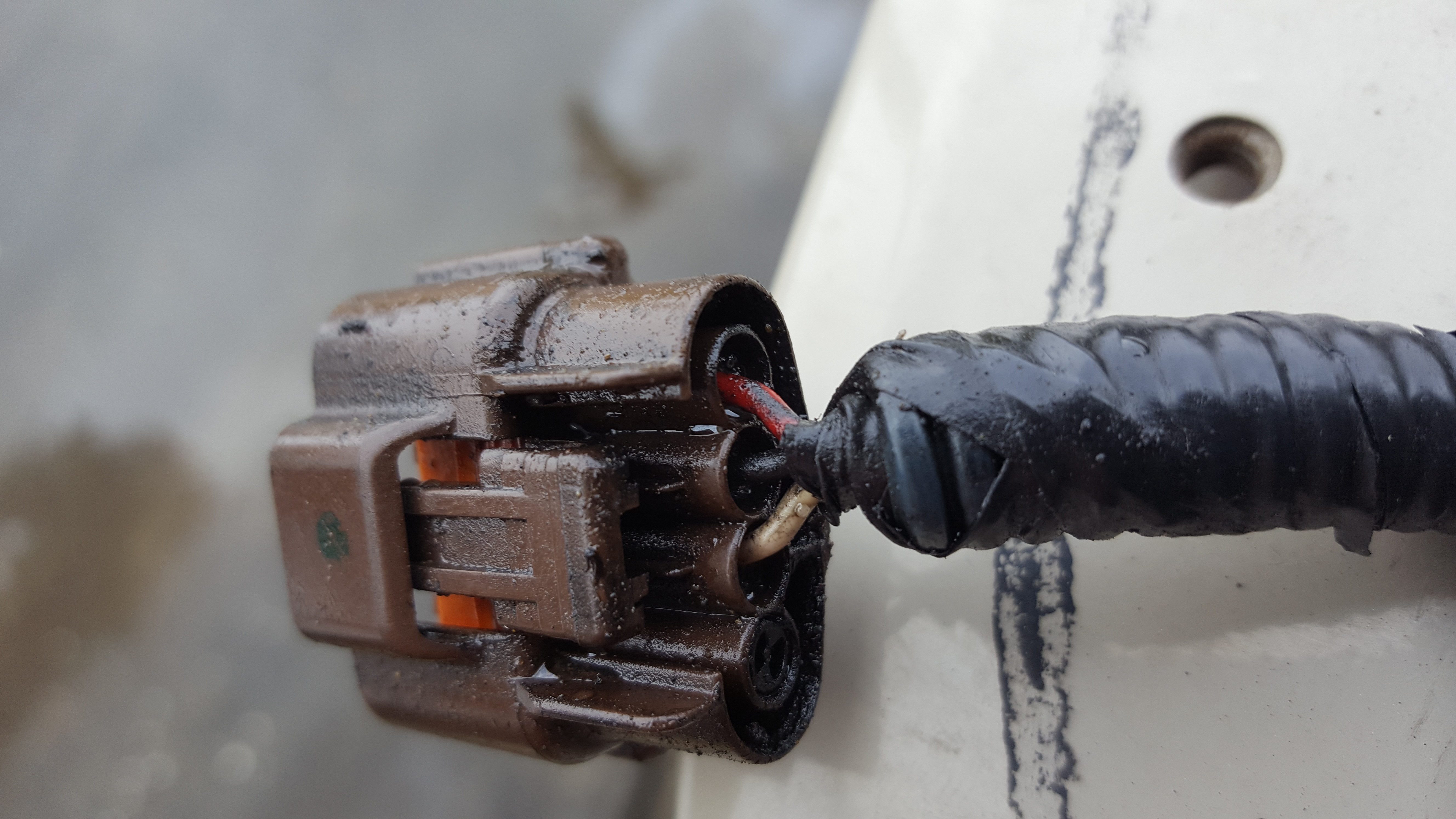

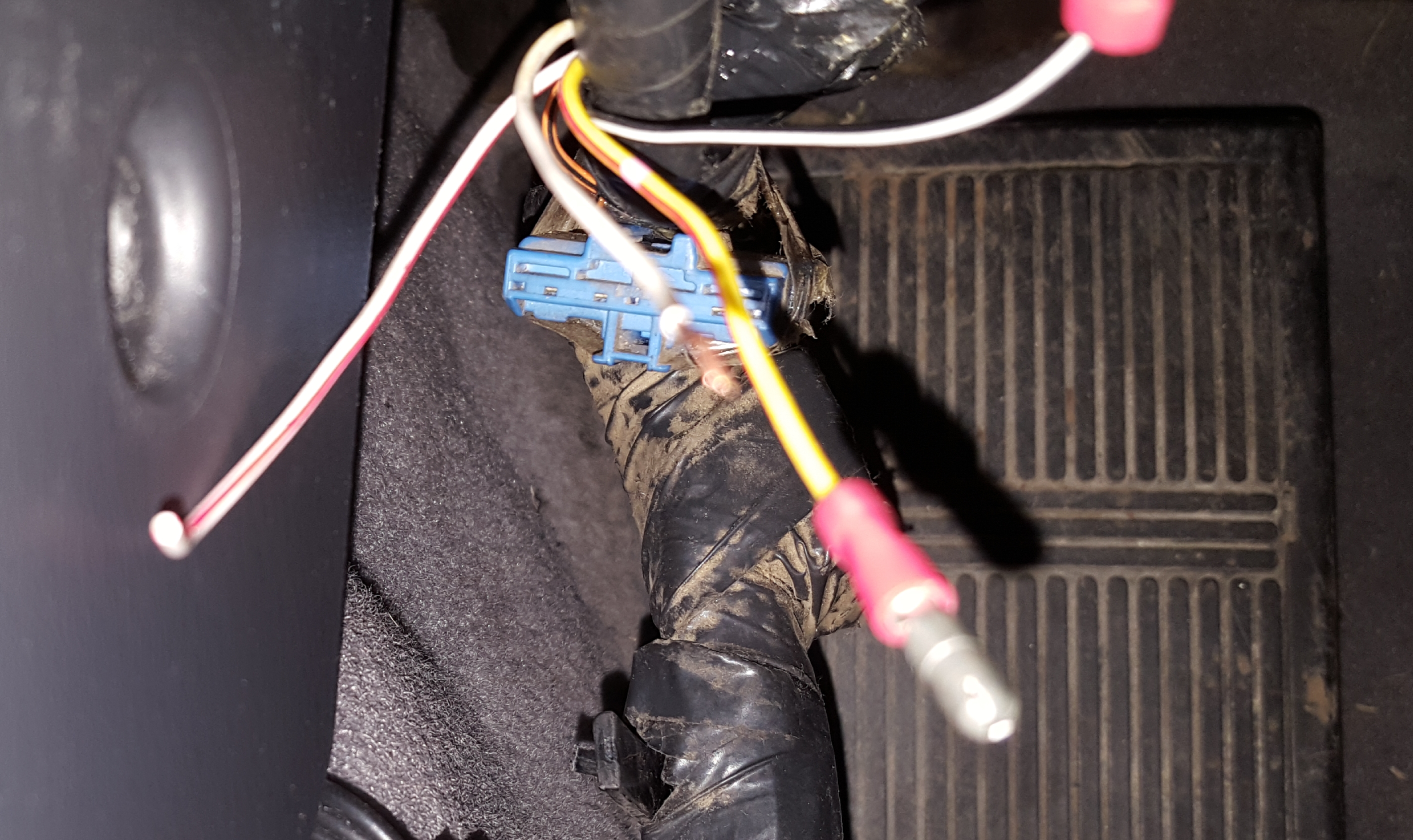

Post up a picture of each AFM plug. Although the AFM isn't plugged in you should still be able to start it up it will just throw up the engine check light.
The body plug in question from memory only has two wires that are required and one of them was white with red stripe will have to double check that but pretty sure it was the main power distribution and comes from the dash loom across from the fuse box under the dash.

Postby Bompie » Mon Aug 28, 2017 1:35 pm
zd30 afm
does this work? trying to do it off my phone.

Postby Bompie » Mon Aug 28, 2017 1:41 pm
qd32 afm

Re: R50 swap over. zd30 out qd32 in
Postby Bompie » Mon Aug 28, 2017 2:42 pm

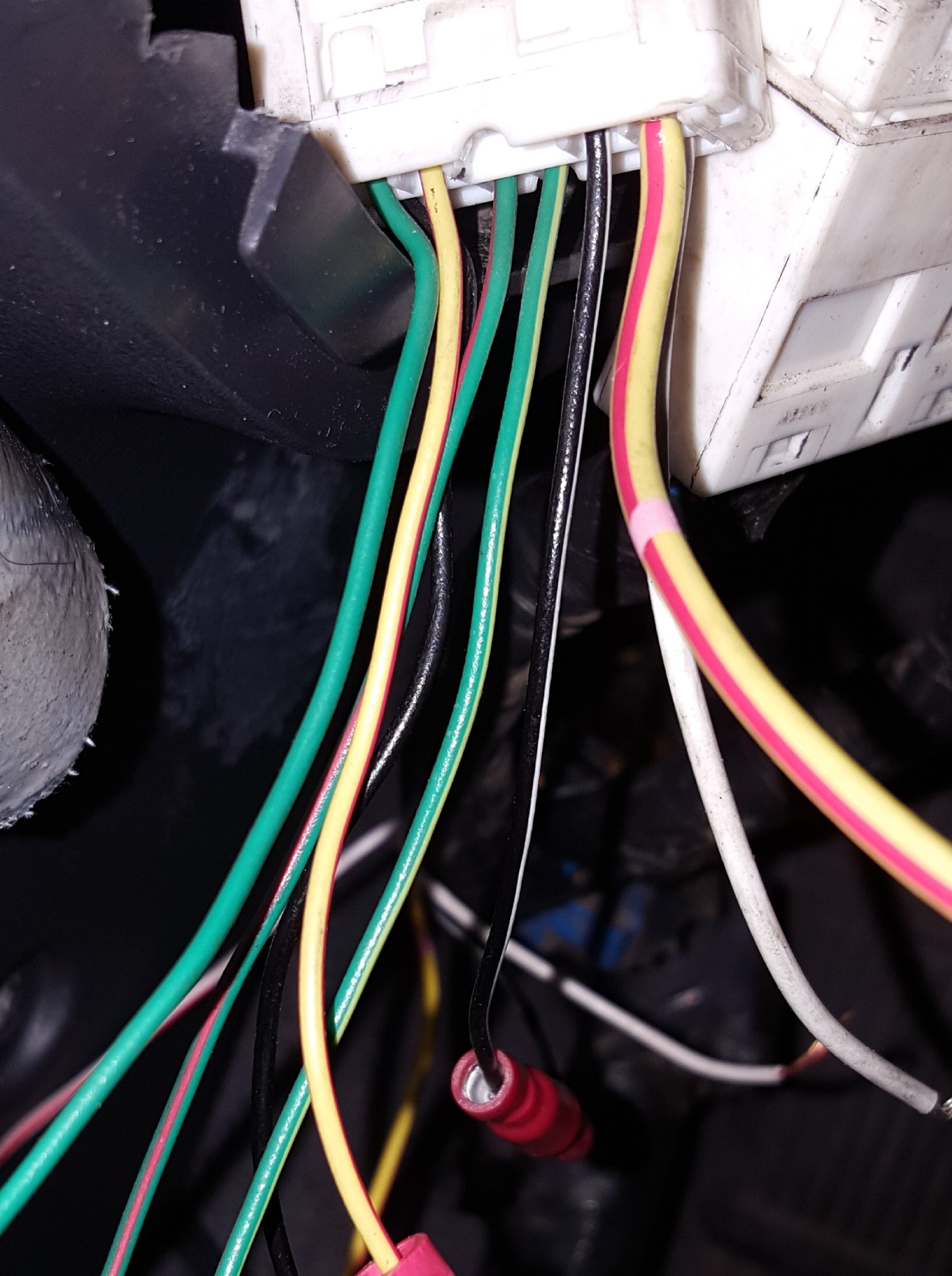

qd32 body loom plug wires
last pic is the zd30 loom
Nissan Terrano stock standard kind of.
Postby Bompie » Mon Aug 28, 2017 2:48 pm
zd30 body loom plug

Postby Crash bandicoot » Mon Aug 28, 2017 7:04 pm
Bompie wrote:20170827_092941.jpg
That one is easy. Positive ,negative and ecu value out
Use the qd a.f.m the zd30 plug will have a temp sender as well for ambiant air temp.
Postby Bompie » Mon Aug 28, 2017 7:22 pm
easy fix that one then. thanks. now to sort the body plug. white with red stripe. traced it on the qd body and it goes into the main body loom plug. then i traced it on ecu loom and it goes to ecu pin 56. white wire traces back 2 ecu pin 61& 70. now i dont have a qd32eti ecu pinout but i have some others and they are numbered the same. browsing through a couple of diagrams the 3 pins (56,61,70) always seem to be 12v power supply 4 ecm. i might try and locate a 12v supply from the eccs relay and try to power it up.
Postby Crash bandicoot » Tue Aug 29, 2017 9:24 am
Bompie wrote:easy fix that one then. thanks. now to sort the body plug. white with red stripe. traced it on the qd body and it goes into the main body loom plug. then i traced it on ecu loom and it goes to ecu pin 56. white wire traces back 2 ecu pin 61& 70. now i dont have a qd32eti ecu pinout but i have some others and they are numbered the same. browsing through a couple of diagrams the 3 pins (56,61,70) always seem to be 12v power supply 4 ecm. i might try and locate a 12v supply from the eccs relay and try to power it up.
Thoughts?
The manual I have has it running through the eccs relay or a simple relay that's switched by the ignition. So test the wire on yye body side with a test light and turn the ignition on. As the eccs relay will still be on the dash side of the loom.
Postby Bompie » Thu Aug 31, 2017 7:01 pm
Tonight's update. It runs. i went back to the doner truck and traced the wires. the red/white goes to egi relay pins 3,6,2 the white goes to egi relay pin 7. The yellow/red goes to egi relay pin 5. the black/white goes to fuse box fuses 16,17,21,22,25.
so back to the 2 body loom plugs i joined the black/white together. i joined the 2 white together . i joined the small yellow/red(qd side) to large yellow/red(zd)side. then ran the a 12v+ to white/red. and from that it runs. i havnt hooked up the temp gauge but i know its the small yellow/red on the zd side of body loom plug. hope this info will help anyone else in the same situation.
