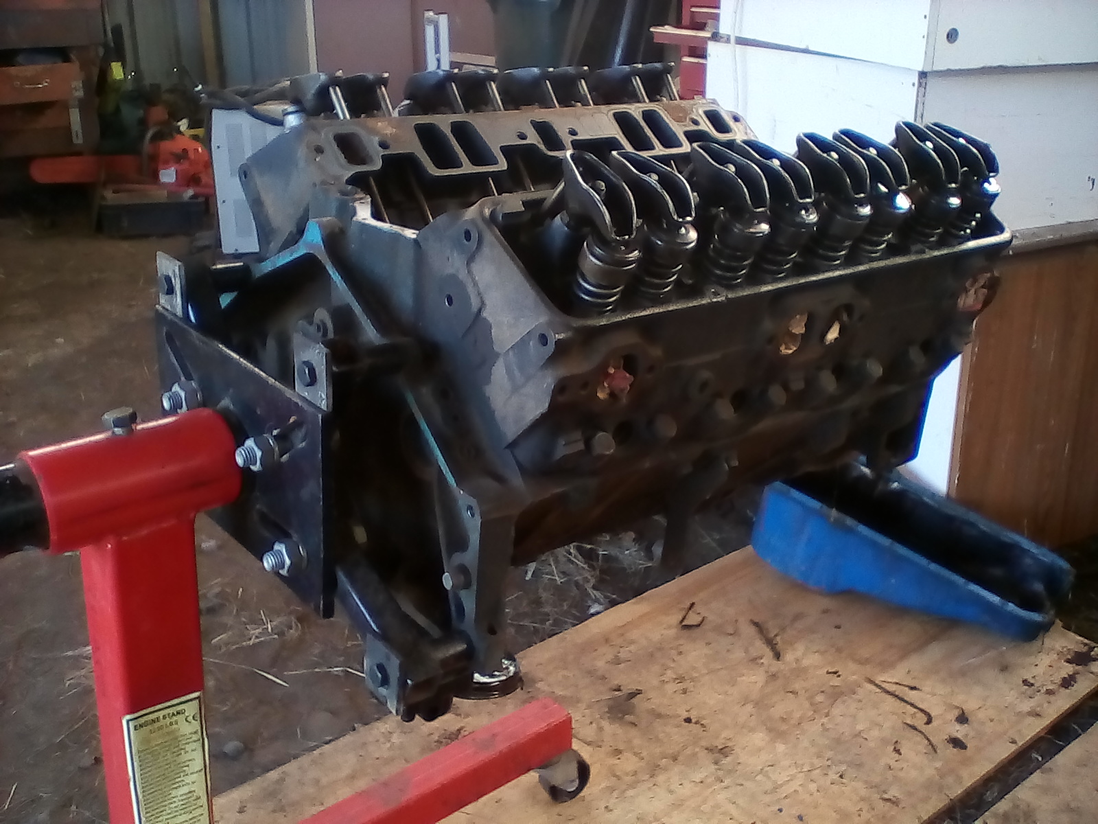

So started the clean up of the Chevy, sump off, old plugs out, carby and inlet manifold off. Its looking pretty tidy having sat in a barn for 15 years 8)
Spent the day going over it, cleaning out the mason bee nests and sparrow poo. Old oil looked pretty good, no nasty surprises :shock:
Will give it a scrub up and water blast tomorrow.
I will spend the evening going over the manual and see what to look out for as it goes back together.
I will initially run the Rochester carb and manual fuel pump, Brian Howat reckons they are matched nicely so will run with that.
I have some rams horns to fit up so will have plenty of power/torque without having to beef up all the breakable bits :wink: :roll:

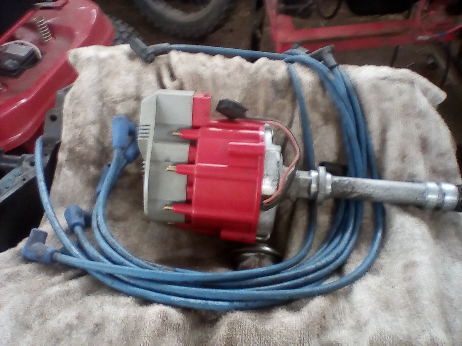

Postby catalystracing » Wed Jan 18, 2017 9:37 am
Rural delivery man bought me this today :mrgreen: 8)

Postby mudlva » Wed Jan 18, 2017 6:09 pm
Very nice....
The little plug that connects the top coil is prown to failing. I soldered cables to the cables that went to the plug terminals and used a proper water proof plug to link the top and bottom units.
The plug used to come loose when climbing staircases and heavy washouts etc.
The plug was cable tied to a clip on the fire wall. Never looked back once this mod fitted.

Postby catalystracing » Wed Jan 18, 2017 7:51 pm
mudlva wrote:Very nice....
That is a great tip, many thanks.

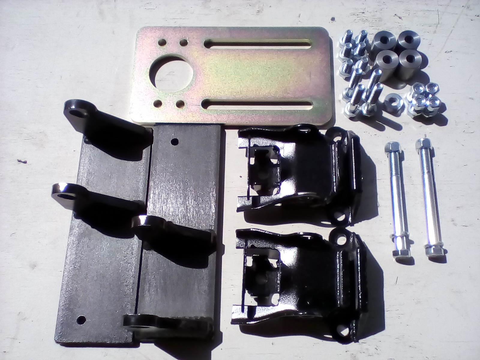

Postby catalystracing » Sat Feb 04, 2017 11:11 am
This arrived from Advanced Adapters today. 8) :mrgreen:
Decided to buy as it came with bits I didnt have and I'm not really set up to easily fluff around getting it set up my self.
Instructions for bits to mod that I wouldnt have known until too late. ( mod to front diff, mod tunnel by g/box)
Landed for under $300 NZD

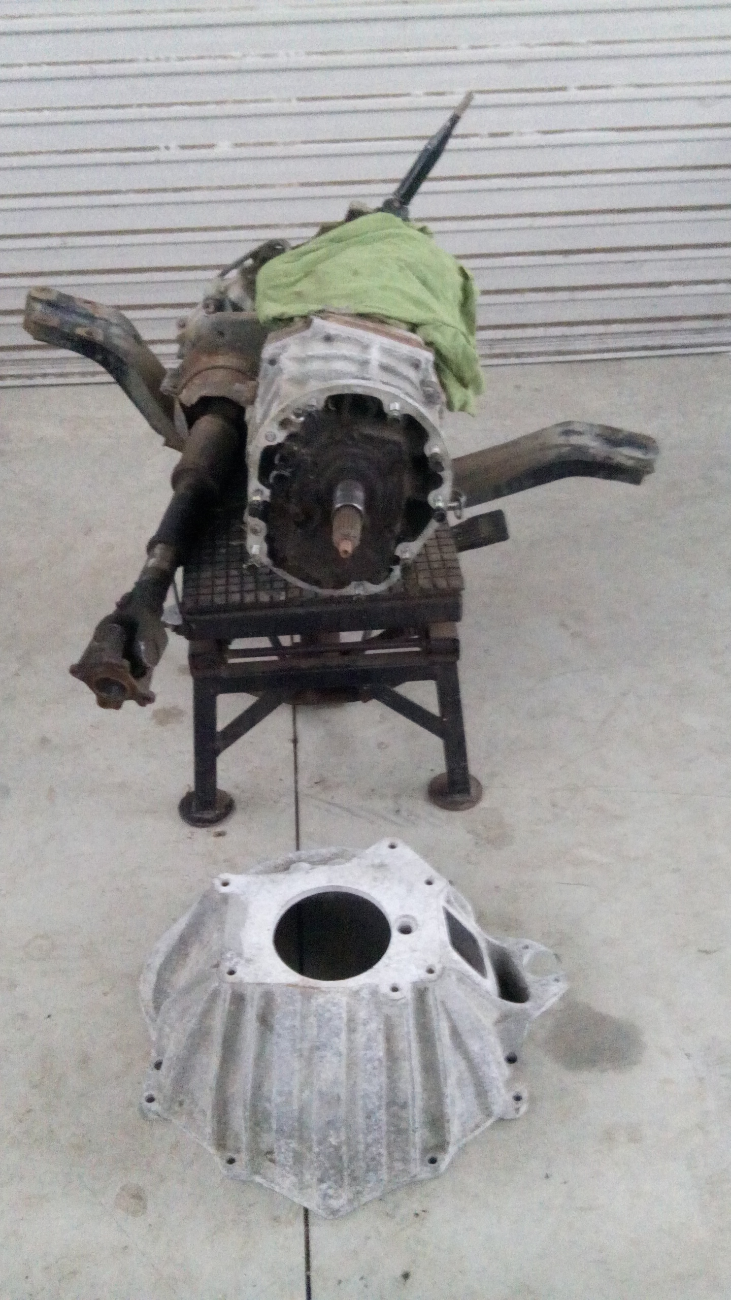

Postby catalystracing » Tue Oct 24, 2017 10:27 am
Ok, so we are underway with some serious intent on moving this project forward.
Gearbox out on weekend removed bell housing to get Chevy bell housing adapted to suit R151 G/Box
I could get this done or do myself but does anyone know of an "off the shelf" bell housing to suit SBC to yota box?
Cheers, Paul.

Postby mudlva » Wed Oct 25, 2017 8:10 am
Theres 2 differant co that do them. Cannot remember their names tho....
Also try marks adaptors

Re: VZN 130-305 Chevy Project
Postby catalystracing » Wed Oct 25, 2017 11:17 am
mudlva wrote:Theres 2 differant co that do them. Cannot remember their names tho....
http://www.marks4wd.com/engine-conversions/bell-housing-adaptors/chev-petrol-engines/mfk650cb-b.html
Kit looks good but I dont want to re mortgage to get it.
I can ally weld so think I give it a go modding the existing chevy housing. 8) , what could possibly go wrong :roll: :shock: :oops: :cry:

Postby catalystracing » Wed Oct 25, 2017 11:25 am
wjw wrote:https://www.summitracing.com/int/search/product-line/advance-adapters-chevy-to-toyota-transmission-adapter-bellhousings ?
Cheers, I did have a look at these guys too. Got my engine mounts from Advanced, good price landed here pretty quick too.
http://www.advanceadapters.com/products/712561--toyota-truck-r150--r151f-v6-manual-transmission-to-gm-v8-adapter-bell-housing-kit/
Works out at about $680NZD plus freight.
Have been trying A1 turbos in AKL but no one answers the phone up there.... :evil:
As above I'll try modding existing housing, I have a contact with a milling machine and digital read out so can machine it after throwing some electric glue at it.
Cheers.
Postby catalystracing » Wed Oct 25, 2017 11:28 am
There is this, but still needs work, so not paying that kinda money to still work on it.
https://www.trademe.co.nz/Browse/Listing.aspx?id=1444915246
