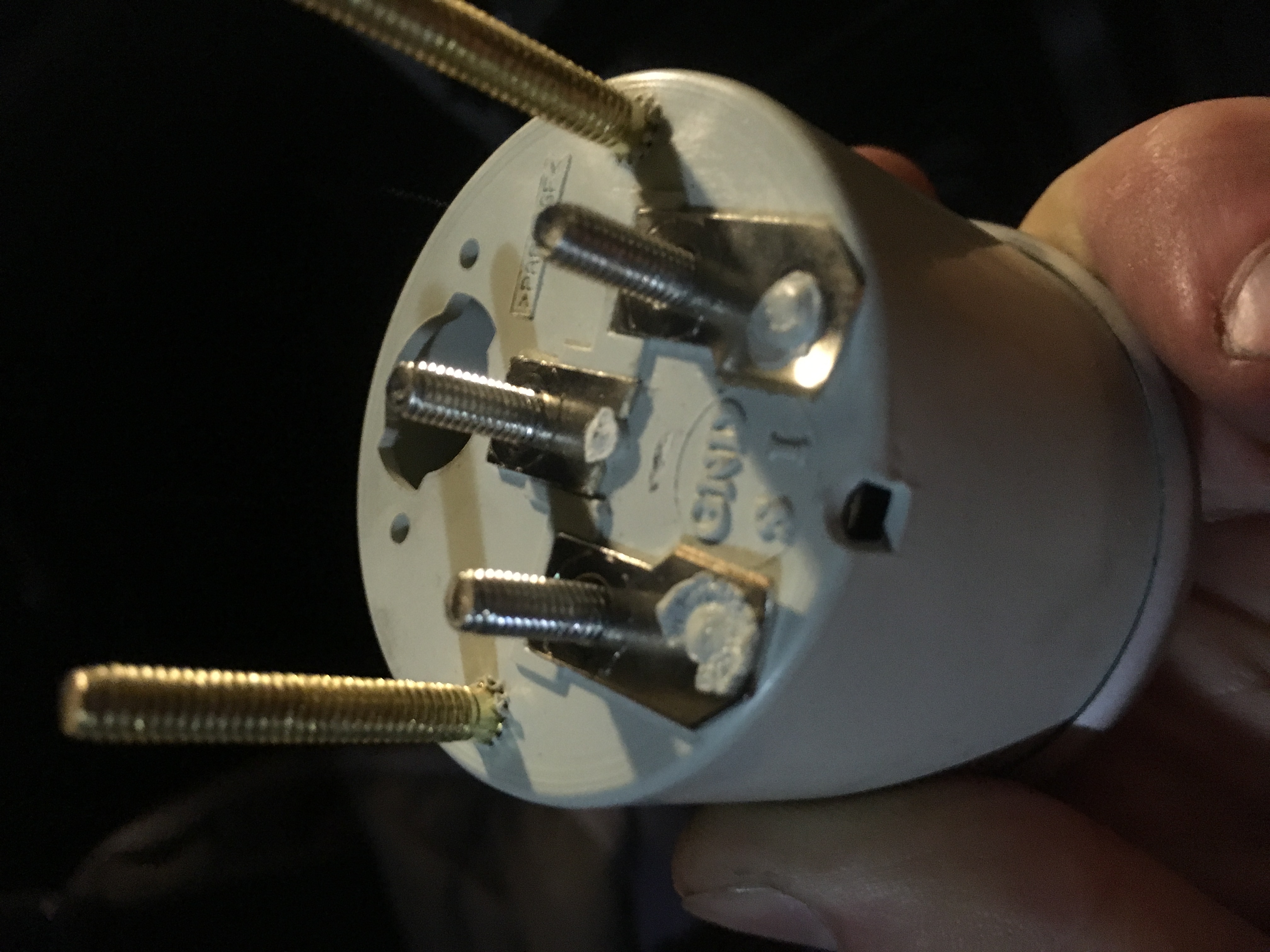

Re: temp gauge
[img]
I reckon i got a dud gauge, tried a fat earth strap and nothing still, pulled the gauge and found that all the posts for where the spade terminals would connect are missing? Amazon will have another one here next thursday.
[/img]
BlakeNZ wrote:yeah something is wrong. The top hose would more likely be around 83-90 degrees max as a general rule under conditions you describe.
If you were driving it hard, or doing a long uphill, or on sand, it might climb to 100-105. If it was genuinely 118 degrees , the factory gauge would be up towards the red for sure. If the improved earth doesn't fix it, I would have to assume the gauge is faulty.

Your gauge definitely is missing the metal tabs for the electrical connections. Did you buy 2nd hand?

Re: temp gauge
Mehrts wrote:Just out of interest, what's the model of gauge you have? I've recently bought an Auto Meter 3337-M short sweep electric water temp gauge, and it seems to be reading low, although I haven't got much to back up my claim.
Part # 4337
Purchased new off amazon box was still sealed.
From what i have read you gotta have real good earths to get them to read right.
