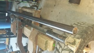

Front drive shaft.

Just a quick question re front shaft.
With the links being wat shorter than the shaft it will mean the d.s will get shorter with axle down travel. Was this taken into account when making the d.s. ? My guess is it could be any where near 40mm

If u change axles and engine the hole master plan goes out the window ha ha but if u look at the first pic of the drive shaft construction i made a dummy shaft and cycled the suspension on my gantry crain. Even with no shocks it has plenty of slip 8)

Mattrade wrote:If u change axles and engine the hole master plan goes out the window ha ha but if u look at the first pic of the drive shaft construction i made a dummy shaft and cycled the suspension on my gantry crain. Even with no shocks it has plenty of slip 8)
Haha all good saw the first pic but thought it was just a test for fit. Now that you mentioned fitting it a cycling it through the total movement sort of wish i had thought of doing the same thing on my build....
Sometimes i just strike it lucky....other times not so much :oops:

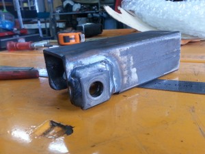

Post by Mattrade »

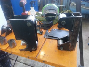

Redoing all my links. Didn't like the spherical rod ends or the link material.
I'm going to be using schedule 80 pipe and Toyota Surf rear trailing arm rubber bushes. They have a 16mm bolt. Strong, less road noise, better fitted for the application.
Also making the rear with air bags so it can kneel down for easy loading, and able to handle different loads. Changing up the style of link suspension that i think will be stiffer and have good road manners.

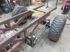

Parallel 4 link with panhard bar.

Think ill do a 4 link front with panhard bar but not parallel. Top links 70% of lower, to keep the caster correct.

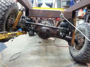

Flexed it out no binding or brackets colliding 8)

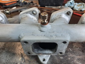

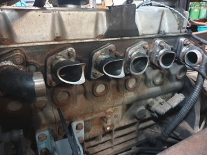

Turbo

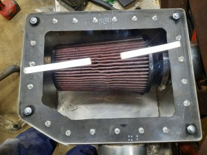

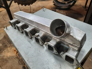

Intake

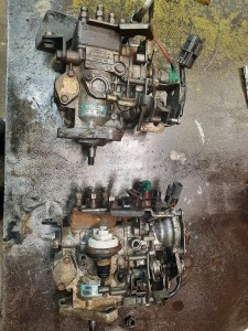

11mm pump

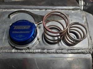

Post by Mattrade »
Compensator pin upgrade. And extra boost springs
