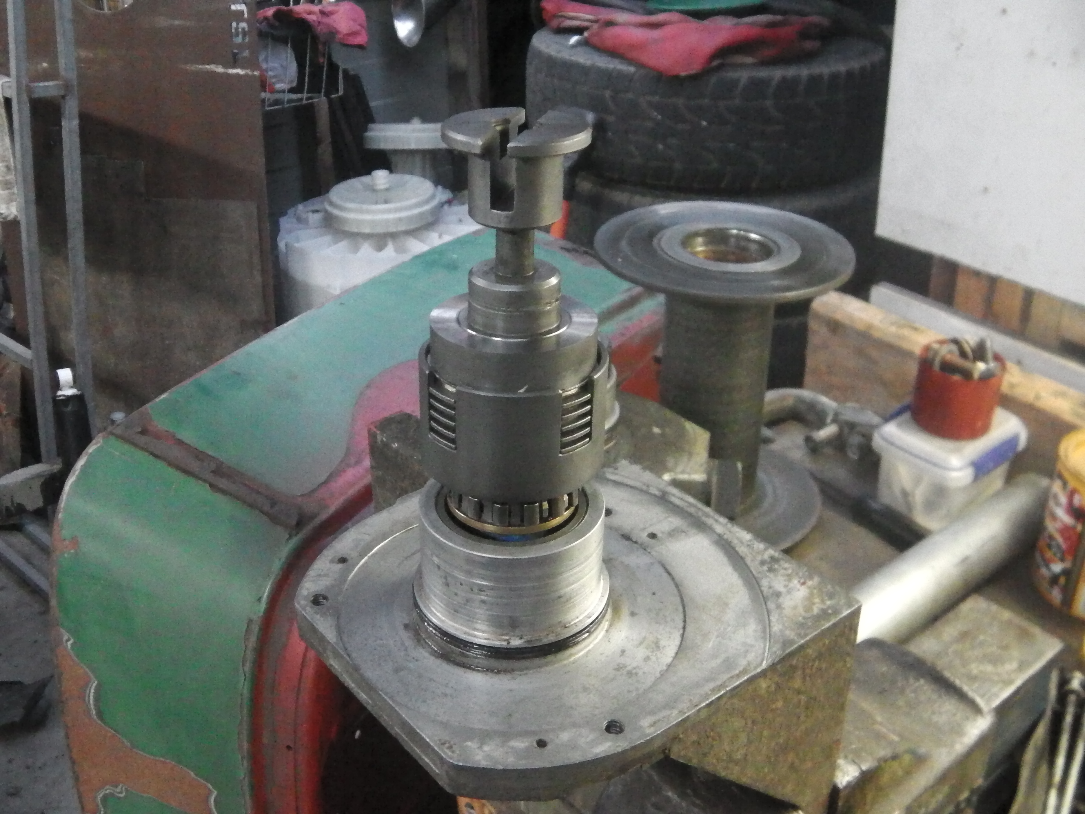

The factory low mount winch is great, easy freespool, 50m of rope, but when the blimen thing almost stalls under heavy load it will wind in but not back out, last straw was a recent trip to the coast and it left me in a spot of bother. the issue is the clutch not releasing allowing the drum to spool out (leaving you with a clicking sound of the motor trying to turn backwards against a stubborn clutch) Google proved useless once again so i fixed the problem myself.

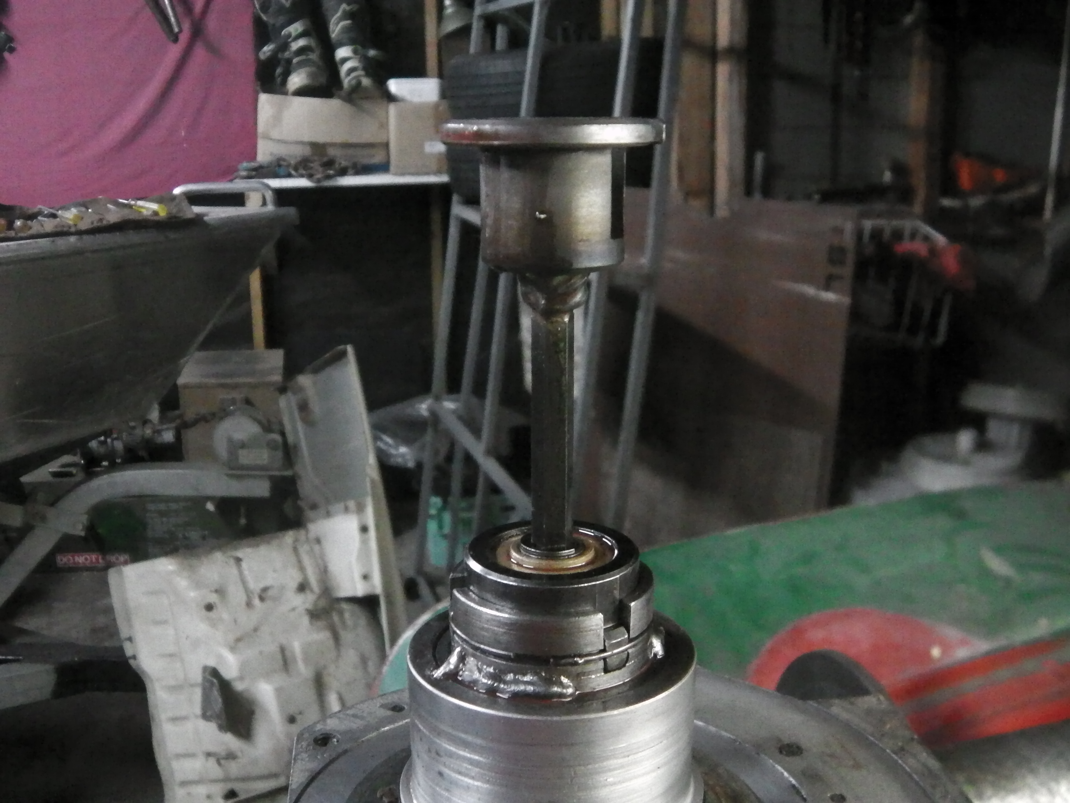

pretty much replacing the clutch plate one with a commonly used flat coil spring one.

Sorry i havent managed to get the photos in order but i hope this will help anyone else out there like me that wants to fix their 80 series winch because they like it.....but mainly cant afford to buy another. When i pulled it apart there was no sign of any water which was brilliant (and suprising), when assembling it i used a high tack waterproof grease on every bush and seal i came across, and any thread i touch i use this shark oil based never cease.I pinched it off the old man, cause you know its good when its got bits of animal in it.
ive stalled the winch and it wound back out again, works perfectly, no more wind in and not wind out buisness
