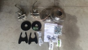

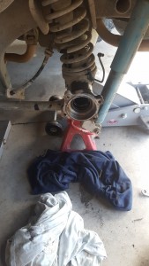

Kit from zookparts.com
Rear Galant calipers
Vitara front rotors
Just a few hours some basic tools and its all go, what a huge difference.
