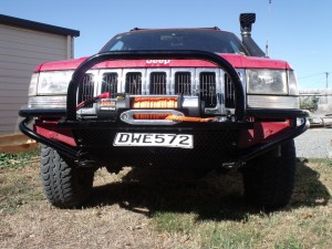

and to finish the bars off ...........................
Pics are somewhere on the net

pics attached
now has new drive belt and all the pulley.......
now to take the winch off and take it back it now doesn't go grrrr

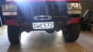

well since it's been a bit wet as a safety measure I have been using the jeep and remember to take a pic of the front side bars
and have now wired the roof lights up with a water proof plug and they work

interesting design , aroma
Re: ZJ Project
Interesting ?
I do have to admit this is more of a cheque book build than the last one.......
I have a friendly engineer who is doing a lot of the steel work from my basic design but he and some of his staff are also into 4wding so have an idea what will work and be user friendly

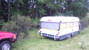

well hasn't been in 4wdrive for a while but while helping the son inlaw set up his camp for Christmas I needed to use the winch, I only got 1 pic to prove it
